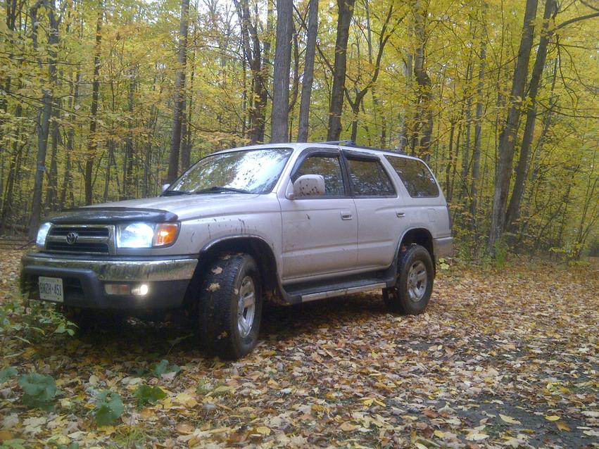

below is what my 4runner use to look like

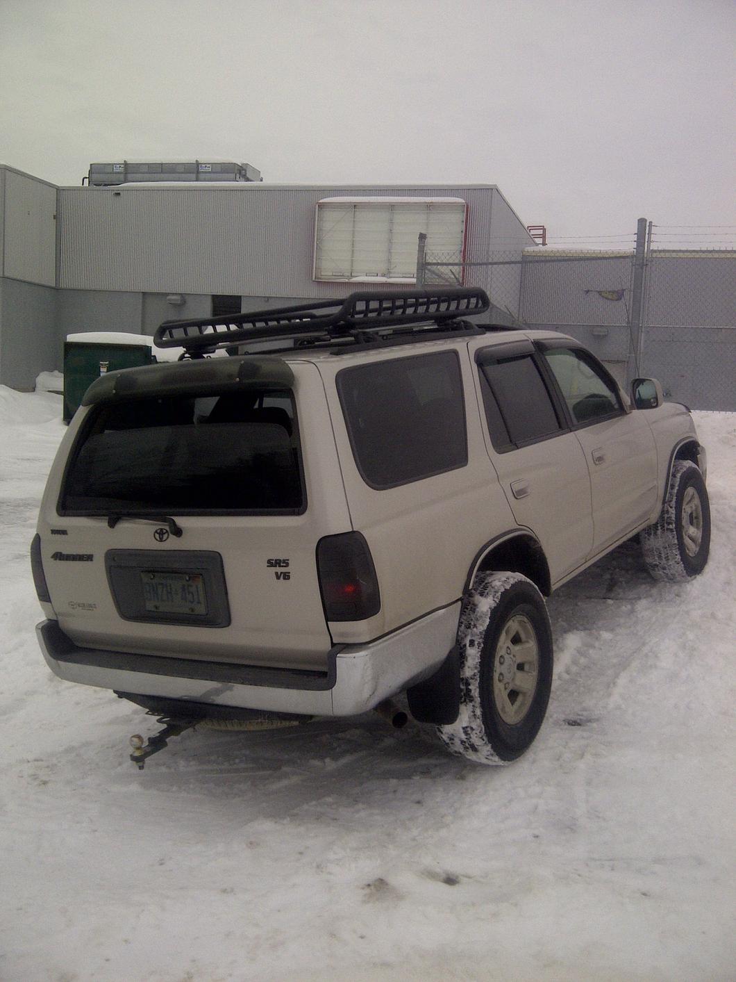

Cut the running boards off and got my roof rack on today

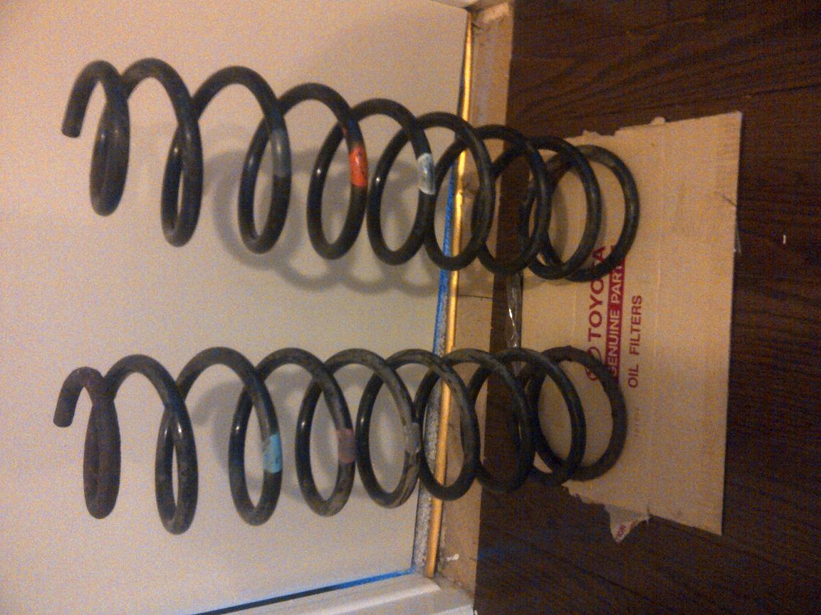

I have some 9.25 wraps currently being shipped, I'm not sure what I'll be using for shocks yet. Given what other people have said these coils provide alot of lift so I'm interested to see how it turns out. For the front I'm debating on tundra/bilstein's or just saving for toytec coilovers....
Here are the LC 9.25 wraps, I ordered them from cruiserparts for $45 each.

Lookin good sir! Those 9 wraps are super flex, I love mine.
Thanks! yes they are veeeeery flexy I cant wait to hit some trails with the new setup.
