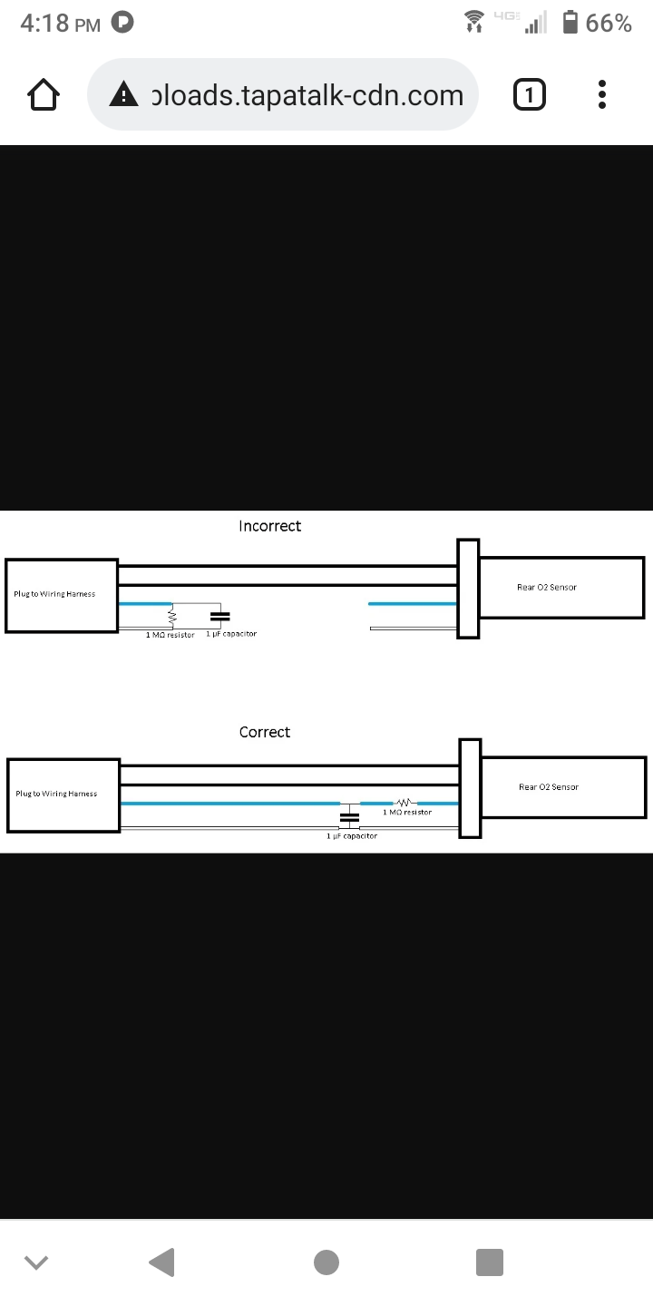

Same thing my cats started going bad right at 100 thousand miles. Truck ran like crap and gas mileage was suffering. Obviously this needed fixed before I could get to removing the exhaust system to get trash can cats out and straight pipe them. I used my existing downstreams and wired in the correct resistor and capacitor to send correct values back to computer. Test with propane torch. Relearned the air fuel ratio. Completely fixed until I get bad cats out. Gas mileage went up almost three mpg.
