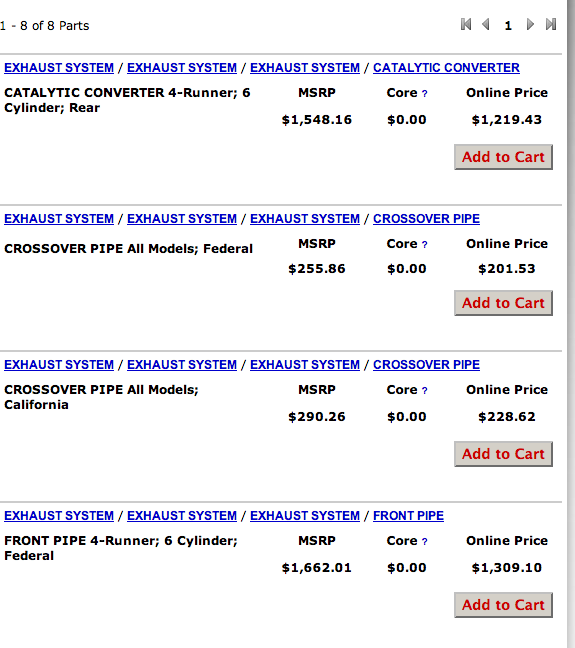

BTW here is a good website for ordering real Toyota parts at a discount. All local shops, if they even use Toyota parts will charge MSRP but if you order over the web from AZ or TX you will get the discount and pay no taxes on part.
Code:
http://parts.camelbacktoyota.com/partlocator/index.cfm?
These things are expensive :naughty:
