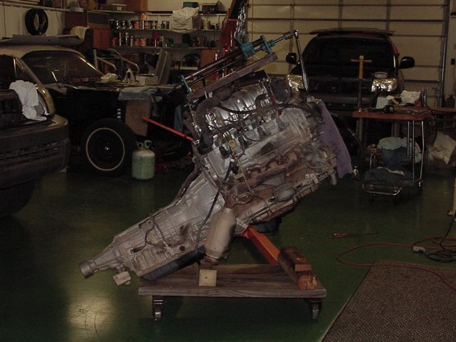

To answer your questions, I bought #3 totaled from an insurance auction with 109K on it for $3500. Less than 2,000 miles since the PO had the timing belt and water pump changed. Used parts from #1 to repair her. Bought #4 with 58K on it totaled from another auction. Including transportation from Colorado $5000. But it is supercharged! Used the rest of the parts from #1 to fix her. I had to buy a bumper and headlights, radiator, evaporator.
To pull the engine a trans complete I built an balancer and had to make some brackets to fit the intake.
Like it's been stated, beside the ECM and engine wiring harness you will most probably need all the lines, a/c, power steering, transmission cooling, because all those will be smashed. The high-side A/C line is a factory only part about $200. Most totaled cars are hit in the front. As mentioned the instrument panel is different because of the shift lights and tach redline. The shifter will need change too. Rear end, drive shafts, exhaust, fuel pump......
