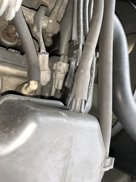

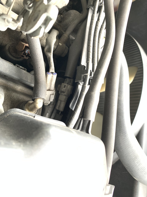

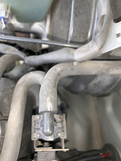

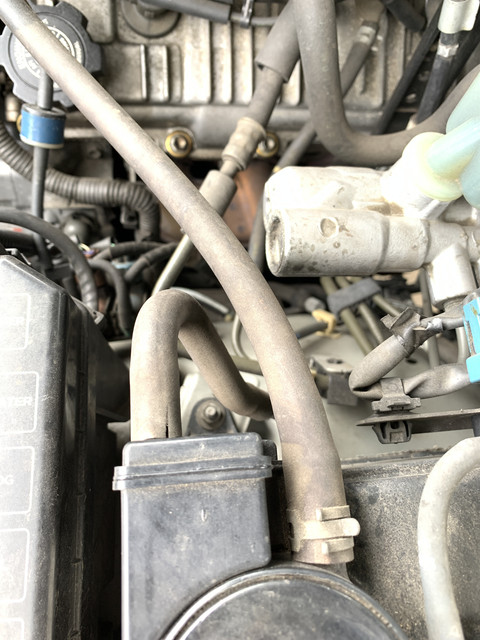

so I've gotten the P1071 code and cleaned my maf. was okay for a day or so, and now it's back. I looked at a few hoses and found a few had cracks at the end. Would these cause the code?
Probably not, but it wouldn’t hurt to replace them to ensure a tighter fit.

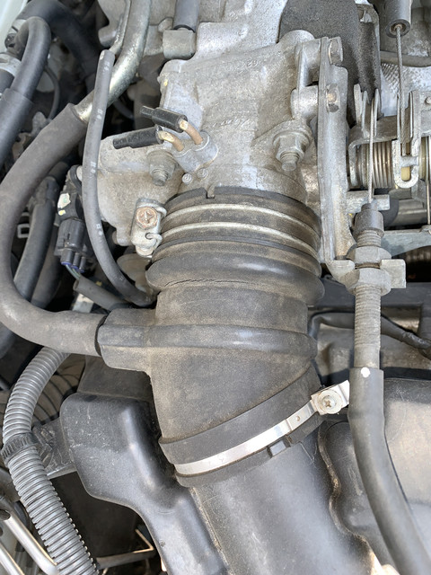

I gave mine a closer look and saw this cracking in the rubber. It's solid as a rock so I'm thinking this might be it! I'm going to order a new one anyway and then check my meter.
What do you think? It's not a huge crack but it's there and it shouldn't have a cracks in it right?
Bigger hoses have bigger leaks so it's worth a shot. However if you can, do the carb cleaner trick mentioned above to see if that changes your idle speed. $5 is all you need to do it (make sure the engine is COLD though).
You might have multiple leaks. The rubber in your engine bay looks toast in many places.
