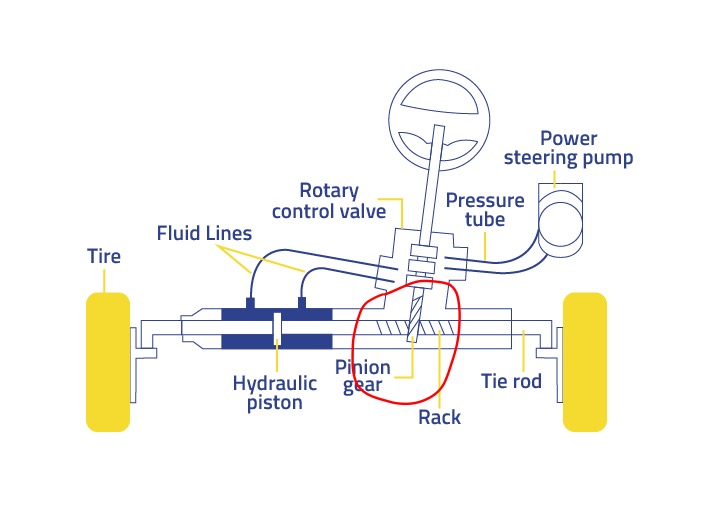

The main objective is to reduce friction in this scenario to have a more smooth, responsive and razor sharp steering. That is what I am trying to accomplish. If you look at the second diagram you can see those moving parts like the gears that I circled in red. I did polyurethane bushings on my Miata rack and pinion and it made a huge difference so now I wanna take it to another level. I will experiment and see if I can improve the steering on my 4Runner. I spoke to my rebuilder who only specializes in doing rack and pinion and he said we could also do WPC treatment on the main internal shaft.

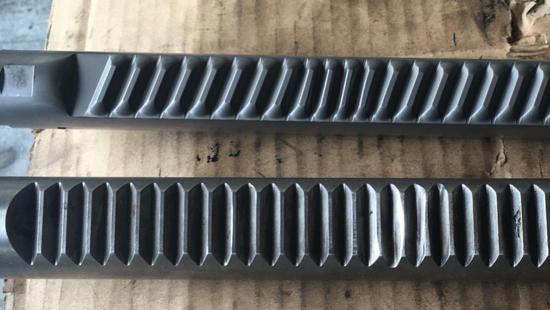

For the first pic...the one on top shows my steering rack after WPC treatment and the one on the bottom shows what it looks like if you abuse the hell out of it. The whole point of me going thru all this trouble is to get a smoother, more precise, and sharper steering and to prevent a normal rack from turning into the messed up one you see on the bottom.

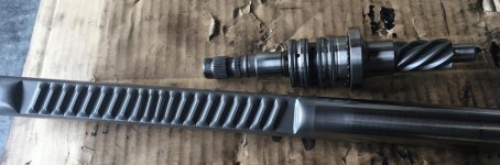

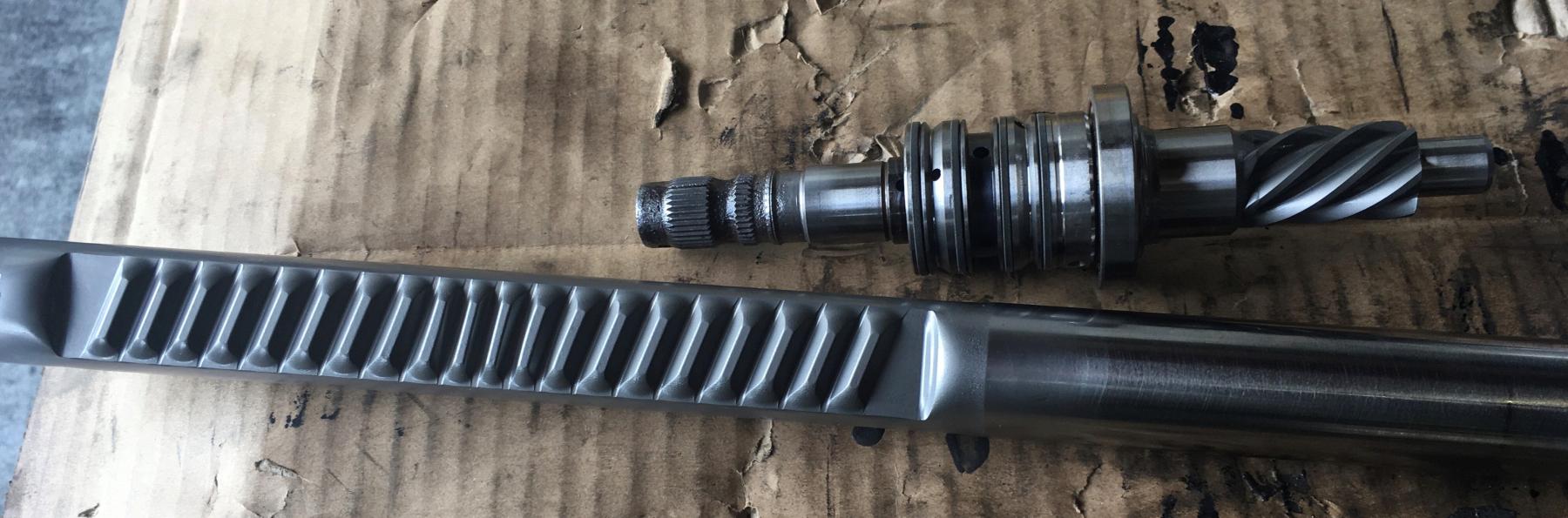

The second pic shows what the WPC treatment looks like on the rack and pinion.

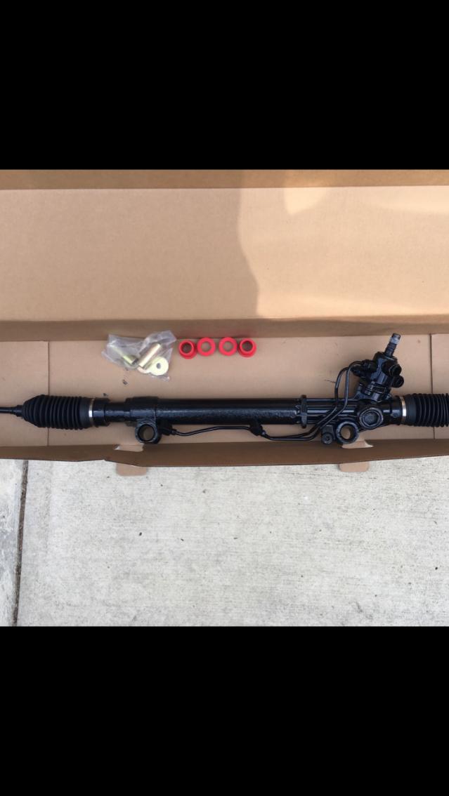

Here is the first run. It has a black paint finish that wasn't powder-coated and uses plastic dust boots.
For the 2nd one I will do it much better. I will add media blasting and powder-coating to the body in a black finish, source higher quality internal seals that is better than OEM and then find a silicone dust boot. I found out that Toyota will no longer be selling the steering rack rebuild kit for the 4th gen 4Runner anymore so that means someone has to build a replacement kit.

Steering rack is on the car and it turns very smoothy and precisely. All I need is to figure a way to test it to get the steering wheel torque values and slop measurements.
Now when I make a sharp turn there is no delay due to the reduction in friction. It goes in the desire direction immediately. My car currently has Eibach sport shocks with new front oem springs and all new oem rubber suspension bushings. Waiting for the Eibach rear adjustable springs for the 4th gen. New tires Falken 265/75R16 AT tires.
