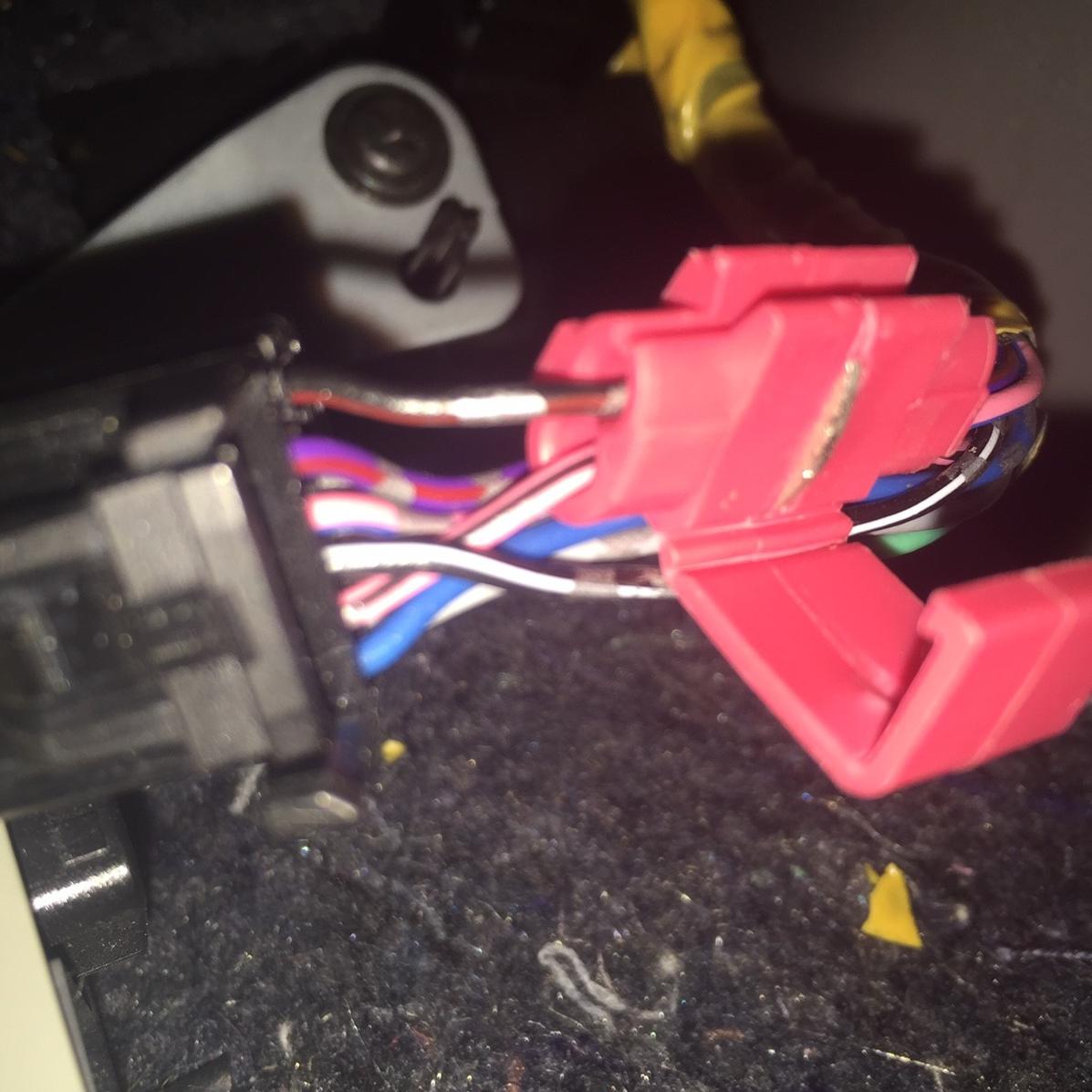

To anyone having problems using the blue scotchlok and the light blinking and/or the bypass not working at all, I had better luck with the red one.
I got mine from Princess Auto, the only Canadian store I could find that carried them.
If you're having a hard time finding them, amazon and ebay both carry them (in the case of the latter you'd have to wait quite a bit)
It's best if you strip the tape off around an inch and a half to two inches so you have more play with the wires!
This can be done in 5-10 minutes. All you need is a wire connector that can directly connect two wires. What I used was a Scotchlok wire connector (see the first picture below). Here is how:
Steps (on my '05 4Runner):
  1. Disconnect the battery (Although I did not do this)
  2. Take out the screw that holds the black plastic panel located below the glove box
  3. Gently pull the black panel and it should just pop out
  4. Drop the panel and you will see that the TPMS module is right there
  5. Unplug the harness (as show in the second picture below)
  6. Use utility knife or scissors and cut the yellow type open (BE CAREFUL-Not to cut the wires!!!!)
  7. Inside the yellow type there is another layer of black type, cut that open as well (again, BE CAREFUL Not to cut the wires!!!)
  8. Now, look for two wires: the Pink-Black one (TPMS) and the White-Black (ground) wire (see below the third picture)
  9. Use Scotchlok wire connector to connect the Pink-Black wire and the White-Black wire (watch youtube Scotchlok Wiring Demo clip here: ScotchLok Wiring Connector Demonstration - etrailer.com - YouTube) NOTE: Check both channels inside the connector. If one channel is blocked, you need to cut out the plastic block to make adjustment so that the wire can go through just like the other channel).

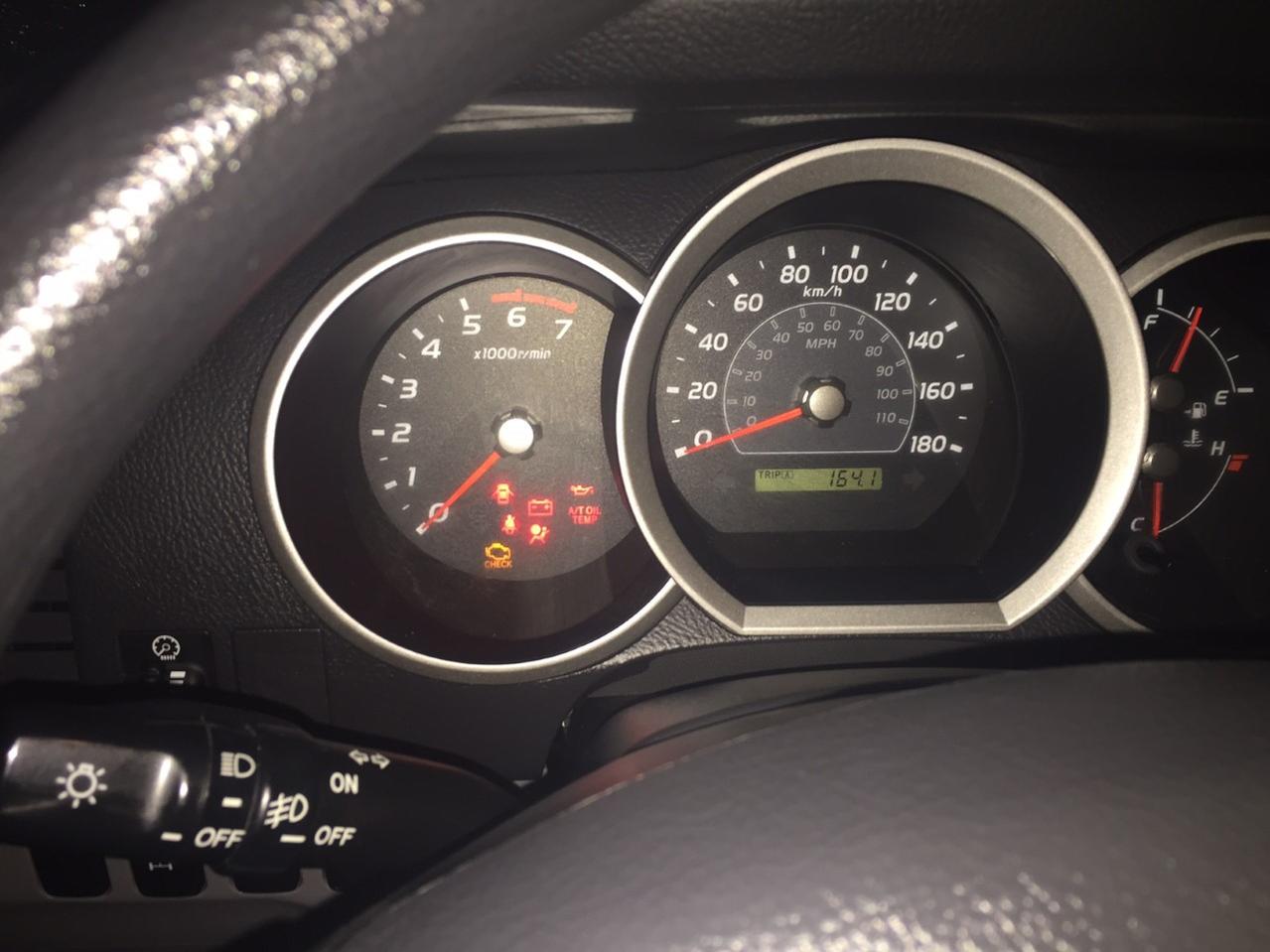

Hey guys, just did this mod. Would love to help ppl out so they don't make the same mistake I did!
on the 2009's (and pretty sure the 08's, the wires are different....It IS the pink/black with MAROON/black.
AGAIN.... connect the pink/black wire to the maroon (dark reddish/brown) and black wire,
Also for my fellow canucks, we can get the scotchlock-type connectors at Canadian Tire...I used a red one (which is 18-22ga) and it worked well squeezing the metal channel together slightly.
I will attach some pictures; One pic of the connection and one to prove the light is disabled when key is turned to the "on" position. If the by-pass didn't work, then the light would appear on startup. Hope this helps some ppl.
Cheers
