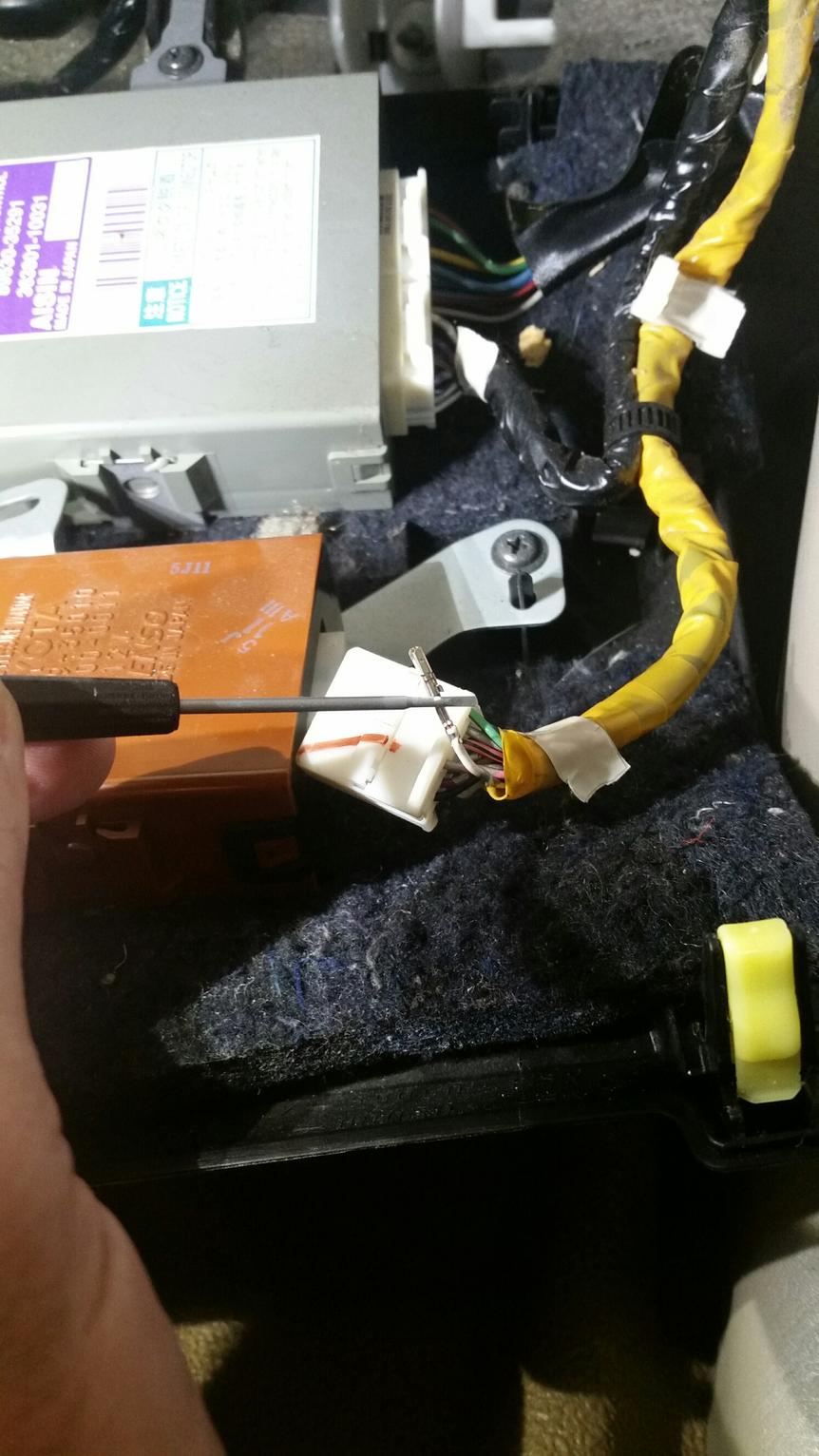

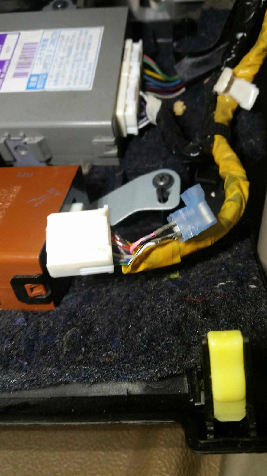

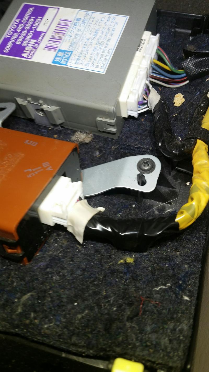

I did this yesterday on my 2007 too. I decided to take the pins out of the connector and then plugged the pins into a quick disconnect terminal.
Ground pin out
Pins plugged into quick connect
Taped up and connector plug back into TPMS ECU
