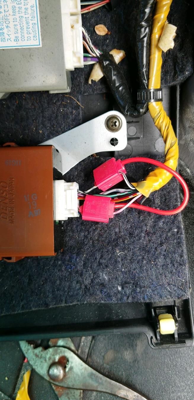

Thanks to the OP and poster 196, williamteichroid, I disabled the light on the 2008 4runner after a wheel sensor died. The 2008 and later apparently have a different size and color plug (small black - 2008 vs larger white - 2007) The Dealer wanted $320. to fix one wheel and Firestone wanted $130.00.
I jumpered the black female plug's pink/black wire terminal to the maroon/black wire terminal with 20 gauge brass wire. This gauge goes in nice and snug. Got the wire at ACE hardware. No cutting or using the Scotch-type connectors. I did not reconnect the plug to the box (obviously).
Works like a charm. I can reverse it by pulling out the jumper wire.

The idiot light started flashing today. I didn't want to pay for the TPM system to be fixed because I don't use it anyway. So I jumpered the wires. Works well!

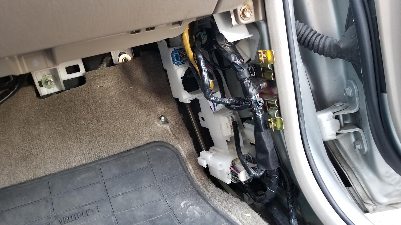

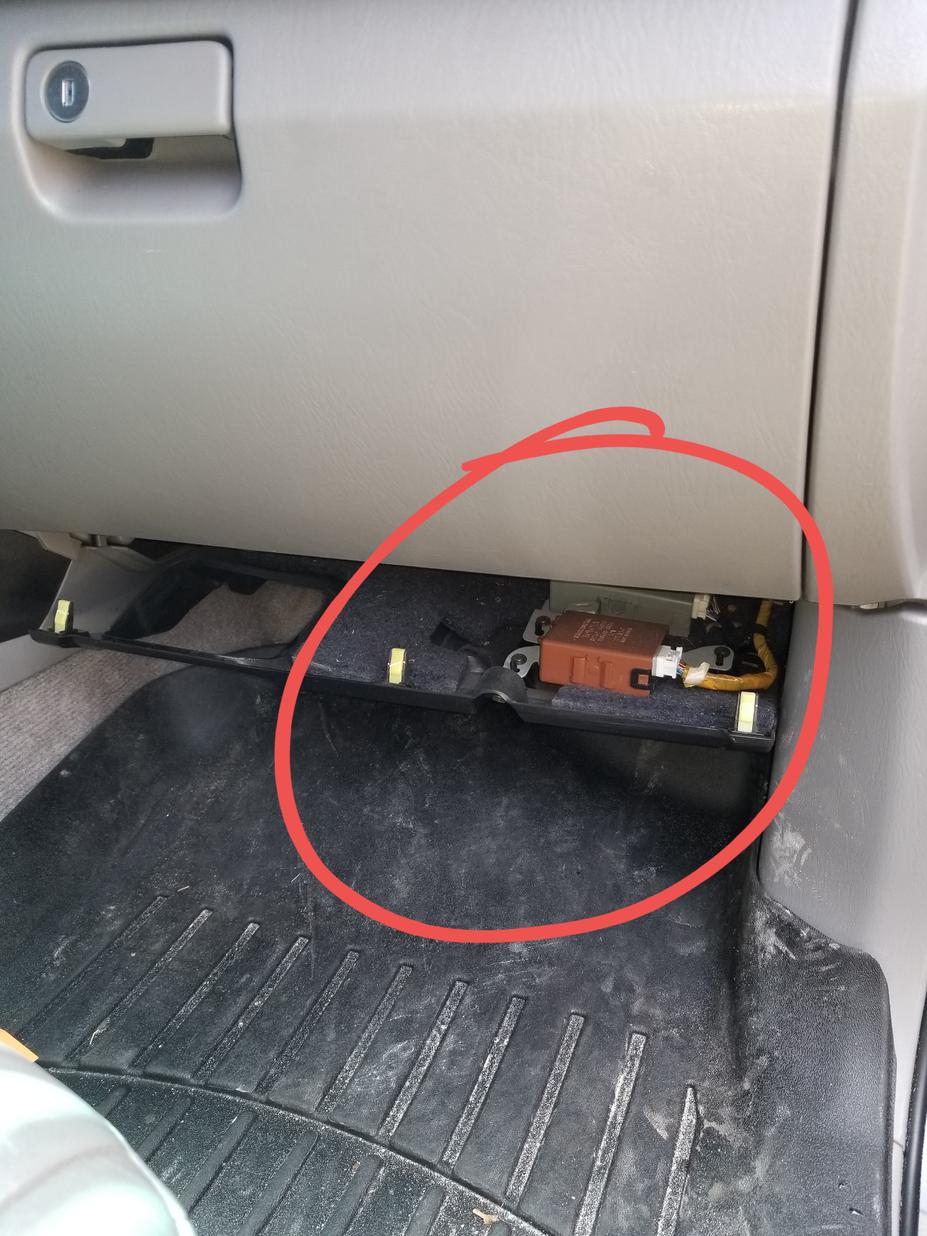

Ok, this is driving me nuts. Supposedly this is an incredibly easy mod...but where the heck is this black plastic panel under the glove box? can someone post a pic? of the thing when it's closed? and the screw? I'm not seeing anything that seems likely under my glove. 2005 t4r.
Remove this screw and drop down the whole panel under the glove box. The little brown box will be attached to the top of the black panel. Sorry for the sideways picture20180922_184534.jpeg

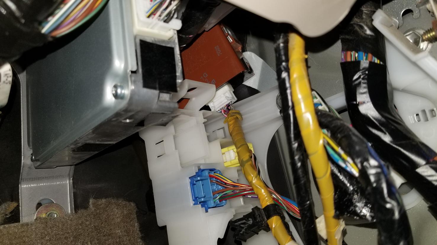

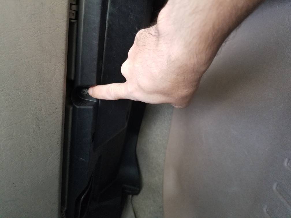

Yup, I definitely don't have that black plastic panel. I can see where that screw *would* go, but the panel itself isn't there. Just the bottom of the AC unit. Anyone have any idea where the TPMS box might be? I don't see anything that obviously looks like that orange box in the other photos :/
found it
Found it. It's hidden off behind some trim on the right-hand side of the passenger foot-well. On the left-ish side of the first pic, you can see the hole where the screw for the black plastic panel everyone talks about *would* go, if it were actually here.
