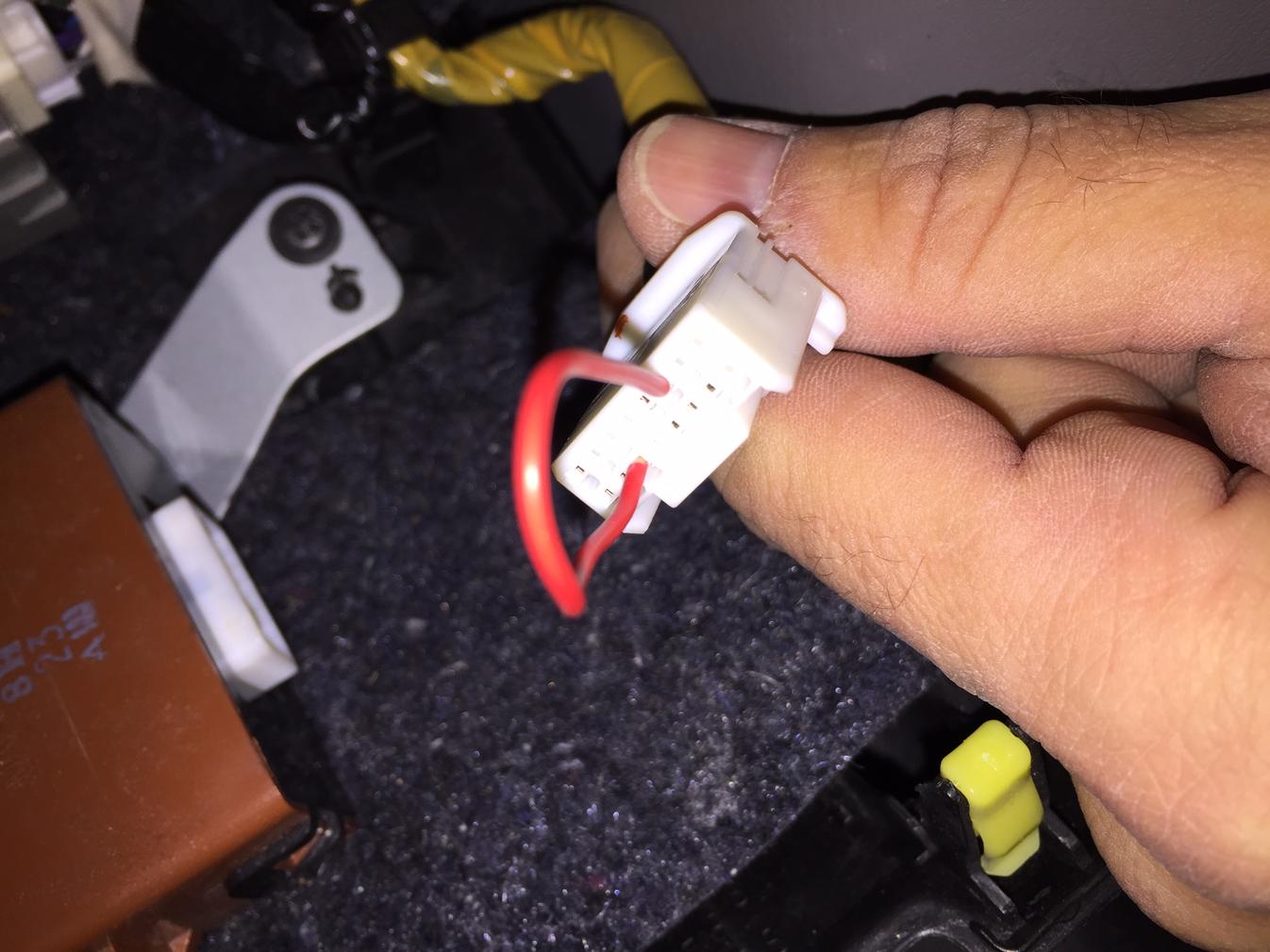

no need to install a connector, no cutting required, don't even need to cut back the jacket. Just take a piece of wire and create a jumper from the two wires. Leave the connector unplugged and tape the jumper on the end of the connector. I used a piece of wire from a Cat-5 cable with about 1/4" stripped from either end.
That's way too complicated! All you need to do is unplug the cable from the TPMS receiver, stick a piece of wire into the connector to disable the warning lamp and ground the other end to the chassis. Then tape up the end and you are done!
I used your idea and another members to simply remove the module altogether. I have a 08' so the wiring is slightly different, black/pink wire and black/maroon, but used a jumper wire at the end of the connector and taped it up. No more annoying warning light.
Many thanks for the numerous ideas.
So there is no bad result from just unplugging the connector and jumping the posts? Anyone with a long term review on this version?
So I jumped the black/white with the pink/black like mentioned. Light is off but sometimes it takes time. I just got my winter wheels on and wanted to get rid of the light this year.

Can someone tell me more about the unplug and jump method? So you just leave it unplugged and jump which 2 holes together?
Per my post above that is what I under stand. Unplug the harness and jump the two wires. Nice thing about this is that it is easy to return it to operational if you want. I have only had it like this for a day seems to work fine.
Can you explain what you mean by "takes time"? I tried this today and drove up and down the street but the light never went off. I thought my connection might not have been good, so I redid it. Still, the light stayed on. How long does it take?
If the light is on then it didn't work. Check to make sure your wires are jumped to the right pins and also make sure that the wires are inserted in to the right holes on the harness. I only mention this becuase it is the tiny holes that need to be pinned not the larger ones.
"Takes time" was referring to the fact that when you seperate the TPMS from the system sometimes it takes days for the light to come on. For whatever reason. But once it is pinned correctly or shorted out the light should go off immediately. I mentioned that it would take time to see if the pin method might work only becuase in my case I know that when I swap wheels without the sensors on them in the past it would take days to have the light come on. So far pinned the waY I have it in the photo above it has stayed off.
