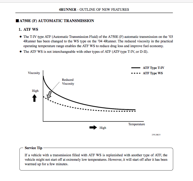

Despite ranting about NOT using alternatives in other threads, I recently discovered this from Toyota:
I found it illuminating, since on the one hand Toyota says that WS is not interchangeable with other fluids, yet, on the other hand, they state that if you do use other fluids, you may notice different shift points, especially when cold.
To me that means that something like Amsoil might just be OK to use, although I still pan to stick with Toyota WS. After all, we're only talking about $100 in fluid every 50K miles or so.
