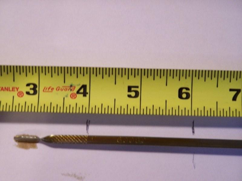

Longish story. I bought it used, and it had a slight engine vibration, felt like a weak cylinder. Dealer said his mechanic had noticed, and they'd find and fix the problem. After bringing in a Toyota specialist they determined it was the torque converter, and replaced it. That didn't change the vibration, so they went through the injectors, spark plugs, wires, valves, etc, without finding the source of the vibration. They gave it back to me and said they were done. I had asked them to top off the coolant when I picked it up, and noticed it was already low again, so I was concerned that it was a head gasket (a weakness on the 80-series LC). I carefully checked the oil and found it was a bit high, like around two gallons high:
Good to hear everything was fine. The v8 is very picky when it comes to oil and an additional two gallons would certainly cause unusual vibration - at least it was overfilled as I have heard horror stories of the drain plug falling off after some jackass at te dealer over torqued the drain plug and stripped all the plugs.
