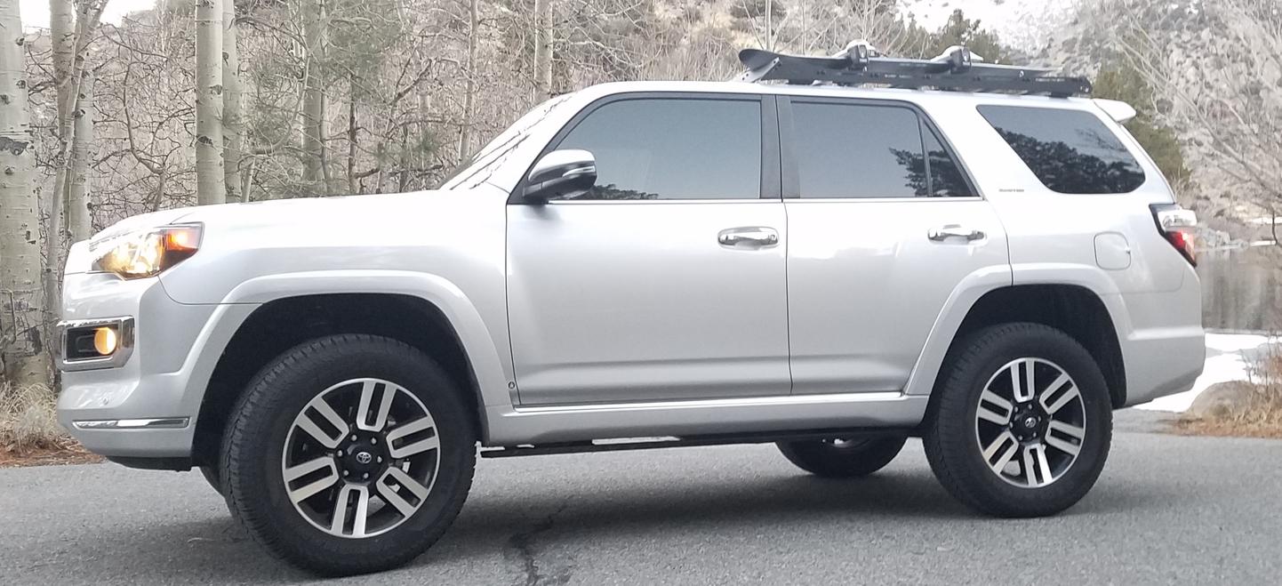

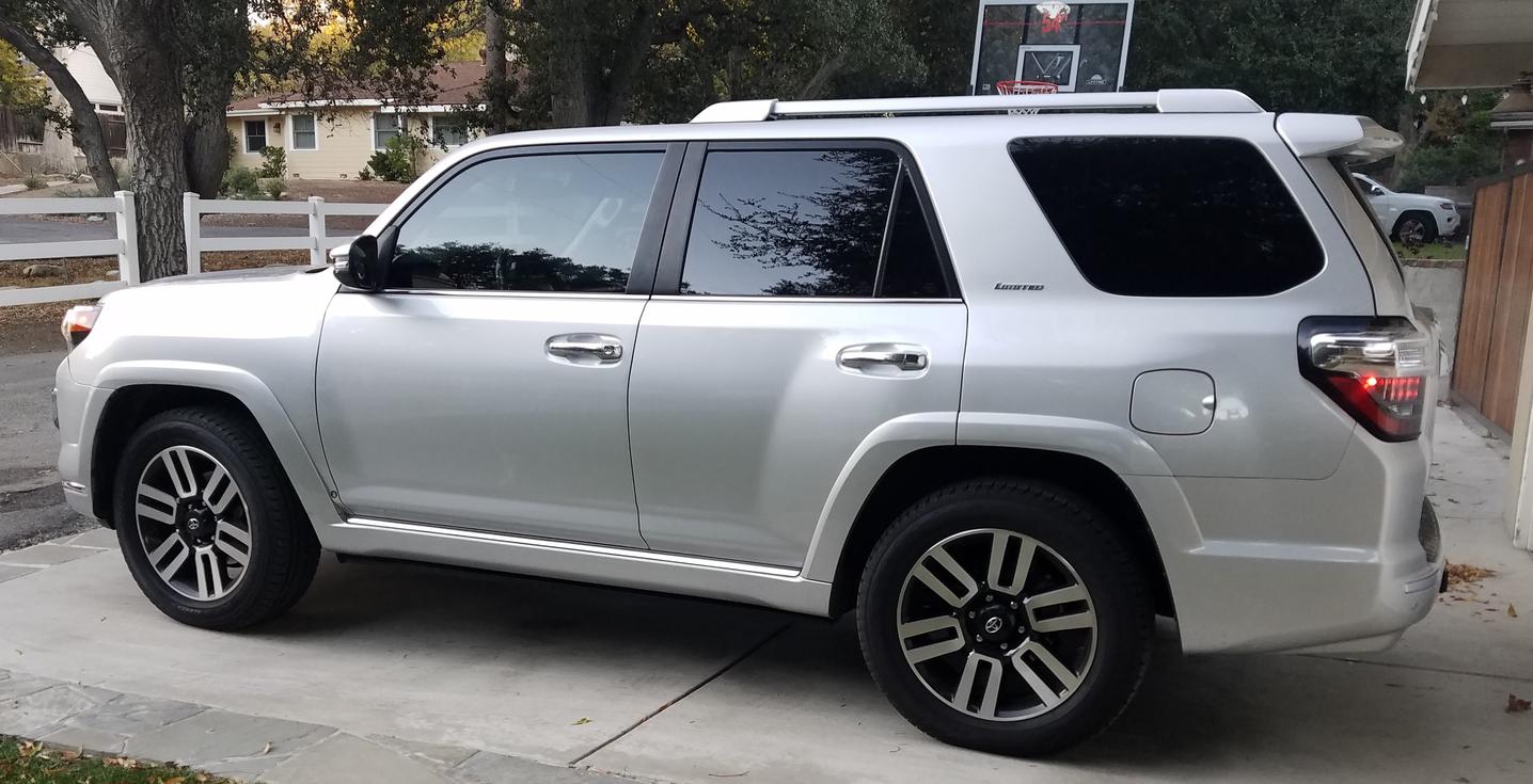

Then you can go from stock to never having to worry about XREAS again
