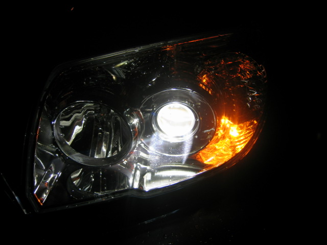

HID's were plug-n-play, except the main power wire, which has to be bolted to the positive terminal on the battery, and grounds that have to be bolted to the body with bolts that are already there. No cutting or splicing necessary.

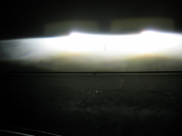

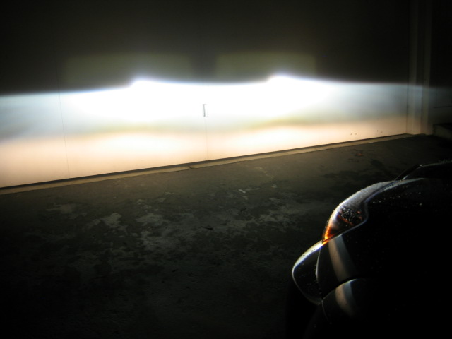

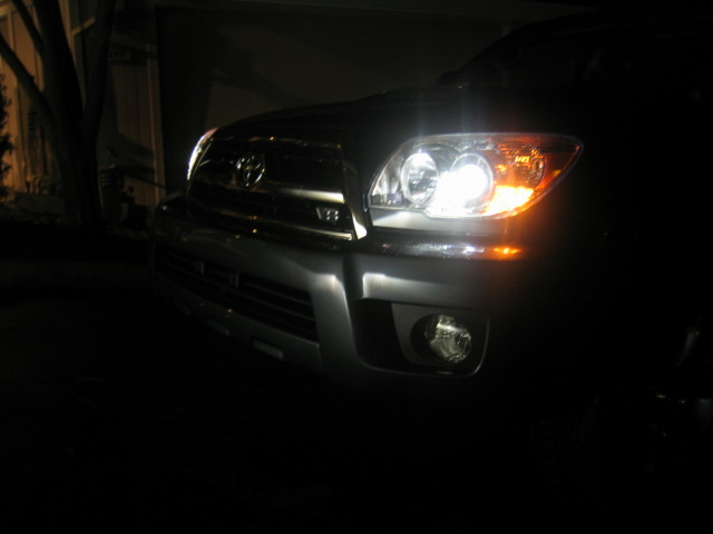

Night shots, 4300K Philips rebased bulb in factory 06-09 projector housings with HIR fog lights:
Cutoff is sharp, and will improve when I bend the shields to remove the "squirrel finders"

For my money, the HID's in stock halogen projectors works fine. I expect even better results once I bend the shield inside and eliminate the squirrel finder.
If I can score a cheap or free set of S2000 low beam projectors, I'd swap them in, but I don't anticipate paying full price for any aftermarket projector system.
The Fogs and high beams have been replaced with 9011 and 9012 bulbs, which are still Halogen, but considered "HIR" bulbs. Basically the same base and configuration with a higher efficiency filament. They're the same wattage but brighter, so you don't have to worry about increased draw or melting wires.
Or even hidplanet for sale forum. I picked up a set of rx330 with tsx lenses for under $100 shipped. Will mod and be 95% of s2000 projectors for a fraction of the cost.
