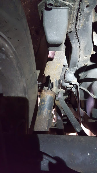

Rear shock metal sleeve rusted away
Hi,
I bought a used 2003 4runner limited 4WD V8 a couple weeks ago and just found out that both of its rear shocks are badly corroded as shown in the attached picture. The zigzag-y thing in the center of picture is the corroded metal sleeve of the left-side shock. I have no idea what was kept inside that sleeve originally. Was oil or any fluid supposed to be in there but it got leaked due to the corrosion? Or, maybe, it is just a cover for the piston shaft and its loss doesn't necessarily require a shock replacement? Could someone shed a light for me please? My car has X-REAS.
Thanks.
Hi,
Thanks.
Mine were Swiss cheesed like that, too. If they're that bad on the outside, it's a good bet they're also trashed on the inside. I swapped out my XREAS (you can't just do parts of it if you're going aftermarket) for Bilstein 6112s/5160s and have never regretted it once. Do yourself a favor and trash that rusty garbage.
Lol. I showed it to a nearby mechanic and he said I could replace just the two rear shocks at $1350 or replace XREAS with bilstein shocks at $1475. Do these quotes sound reasonable?
That depends on whether or not he is replacing springs also. You can get 4 bilstein 5100 shocks for about $350, so labor is $1000+ based on his quote....for just shocks. A complete, assembled Bilstein kit from Toyteclifts is about $1100....with new shocks, springs, etc.etc
If the mechanic is replacing springs and shocks, with a kit like Toytec sells, it is reasonable.
IMO, labor shouldn't be more than 3-4 hrs, or $400....you may simply want to buy the parts and pay for labor - OEM style shocks and springs, with pre-assembled coilover assembly for the front shocks, made by KYB are about $300 on RockAuto, for the entire kit, all 4 corners.....and stock rear springs are about $60, so really...if you go for stock ride and height, buy the shocks yourself and you pay to have them installed, you shouldn't pay more than $800-$900 for all 4 corners and this includes new springs front and back...IMO.
Wow great information. Thanks a lot. This forum is awesome.
One thing to keep in mind, if you do go with a lift, you'll need an alignment afterwards. That's another $110 or so. (At least around here.)
For my daughter's 4Runner, we went with 5100's and OME coils all around. I got the 4 5100's and front springs assembled of CL for $300. I bought a set of new OME rear springs for about $175. After the alignment, total should be around $600. I really like the ride of the OME springs with 5100's. No more bottoming out over speed bumps either.
Thank you for sharing your story, YetiX. Mine isn't lifted, so I guess alignment isn't necessary in my case. Unless you did it yourself, what was the labor cost like? By the way, my rear shocks don't have coils around it. If I go with a non-xreas shock, should I buy coil for all four corners? Sorry for many questions. I'm a total noob in car mechanic and just started learning stuffs with the purchase of this old 4runner :)
