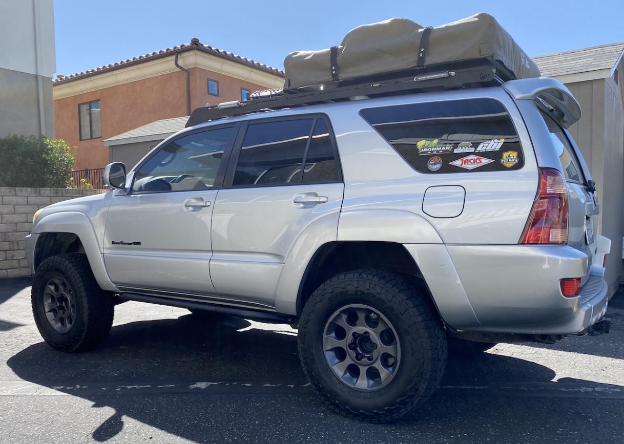

Hey Man! Love the build - you've got me thinking about fabbing up my own skid plates now too...
I wanted to chime in about the Trail wheels - I have them on my 04 SE!
I wanted to change em up for not too much money, so I actually used Anthracite Grey Hyper Dip from DipYourCar.com to do it for about $60 total. Running without the center caps - looks better in my opinion.
Attached a pic, let me know if you have any questions!

Dude those look awesome with that color! I have been on the fence about the center caps, and yours looks great without them. May have to take mine off and see how I like it
