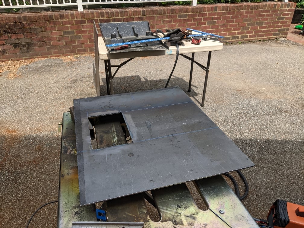

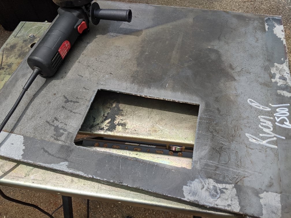

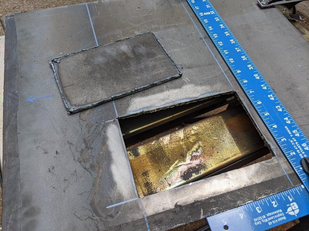

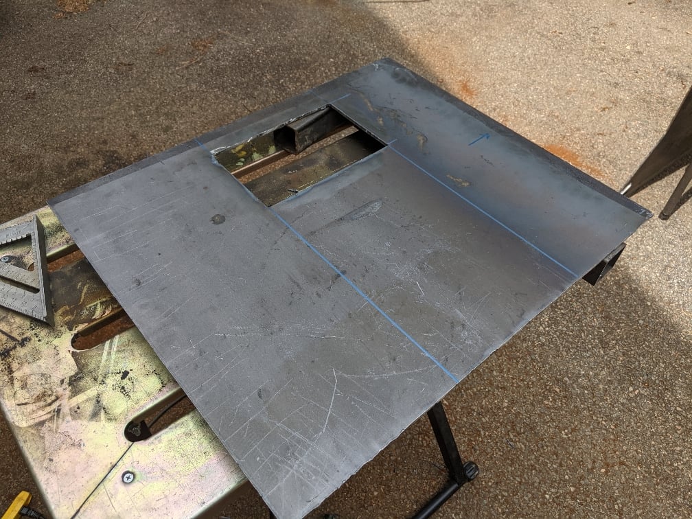

A sneak peak of todays project: skid plate V2! Someone reached out to me about building them a skid, so using this as an opportunity to test out my revised design, and buy myself a new tool. I'll do a little review on this Warfox plasma cutter when I finish this project. Pretty inexpensive for a dual voltage, pilot arc plasma cutter and I've been impressed so far.

Sorry for mediocre photo quality, I'm using Tapatalk app to upload pics on the fly. Will update later with full quality
