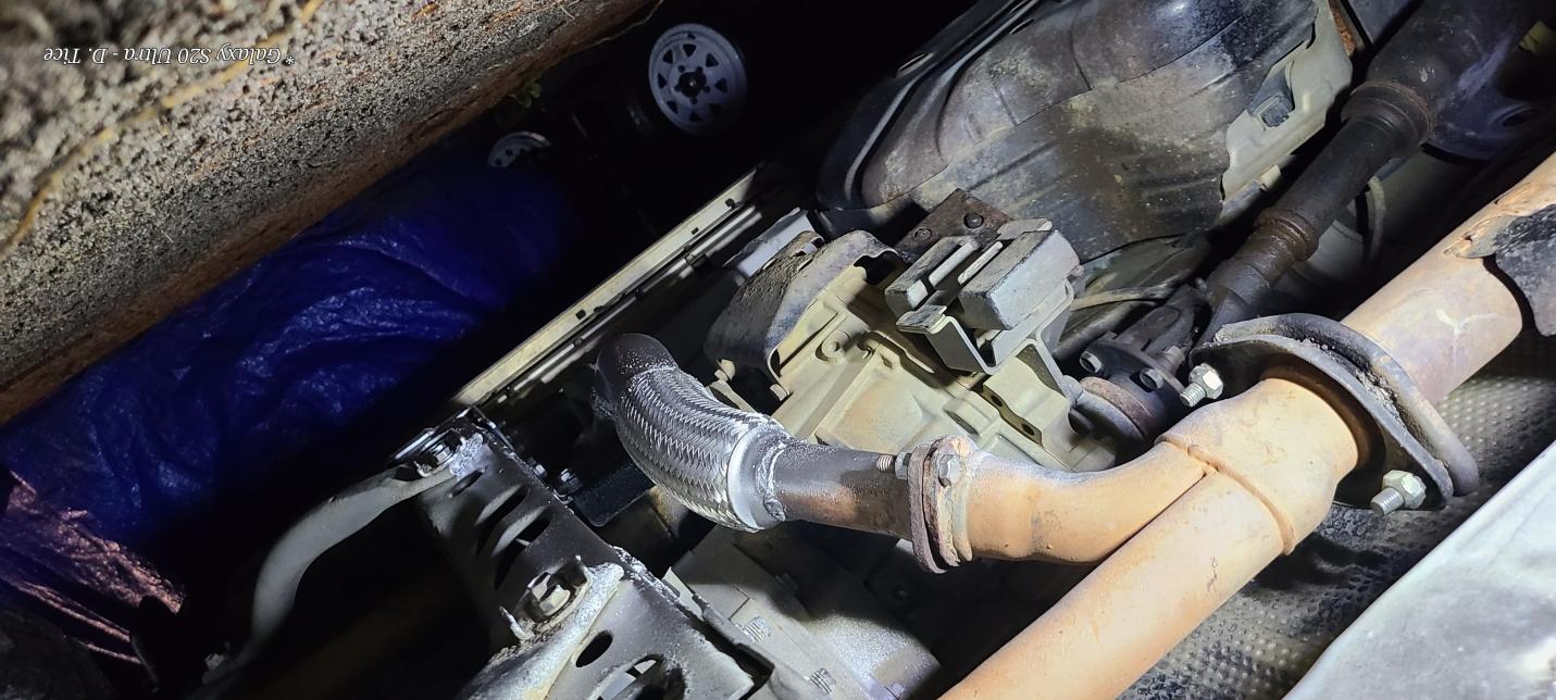

Custom Y Pipe
I ended up cutting out my secondary cats on my '07 4.0 liter limited and deleting factory restricted Y-Pipe and used a flange off of an Acura CL type s. Welded it to a stainless steel flex pipe, 40 series flowmaster nothing in between factory turnout location with custom tip.
