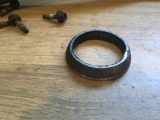

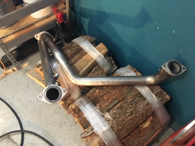

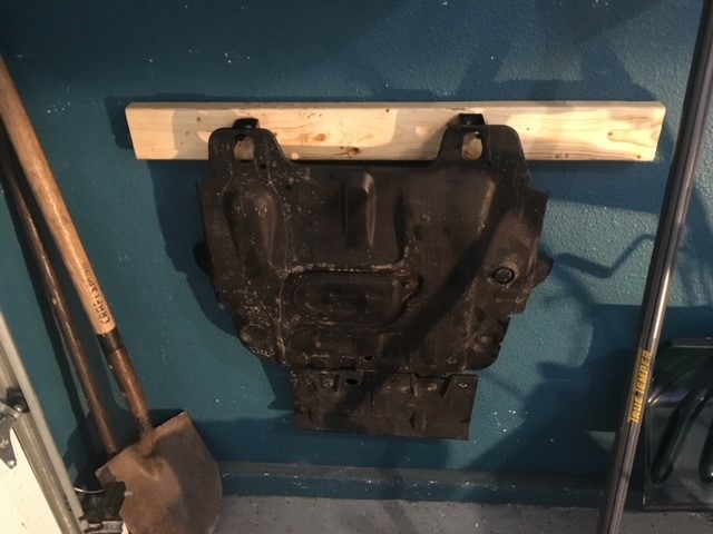

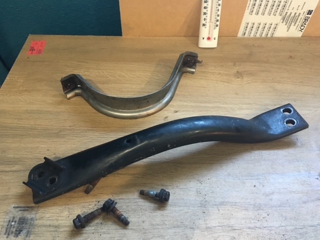

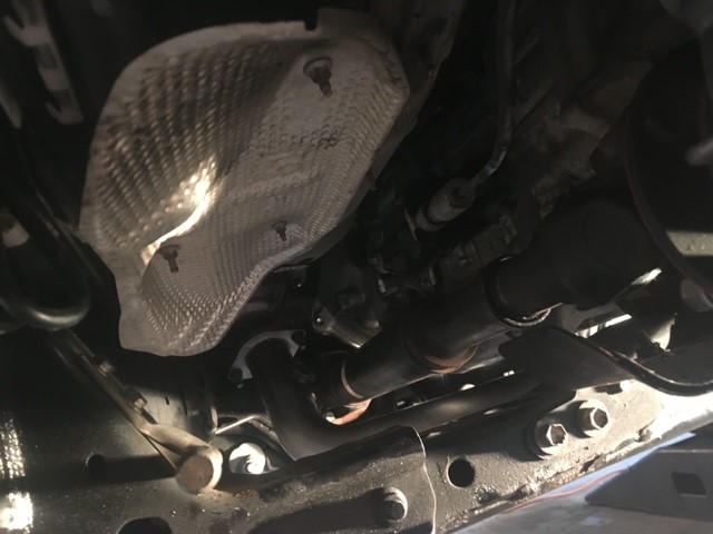

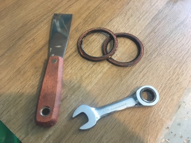

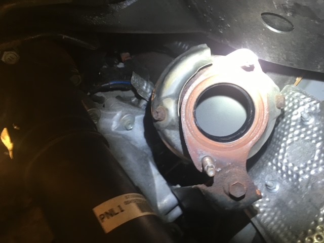

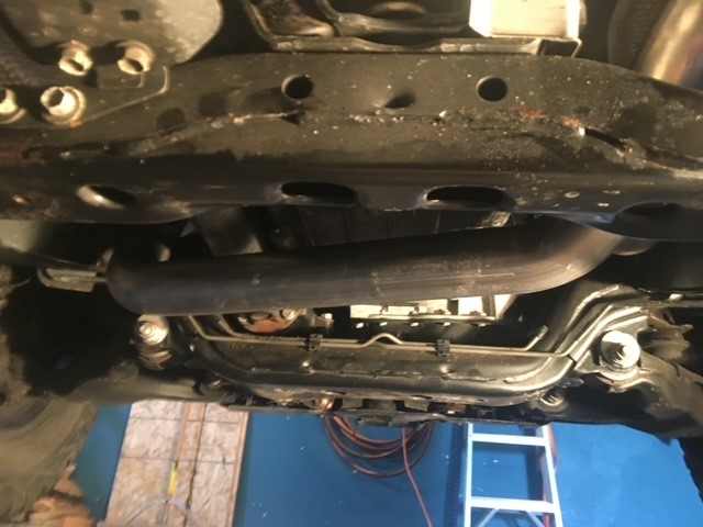

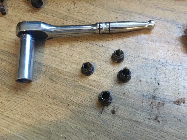

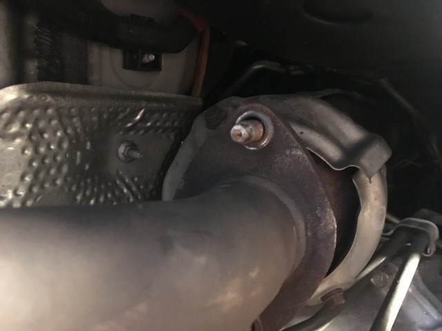

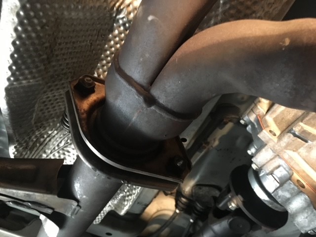

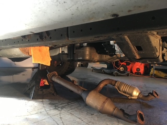

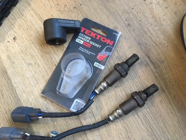

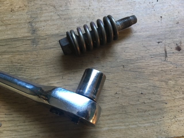

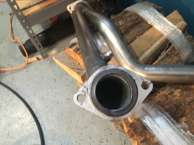

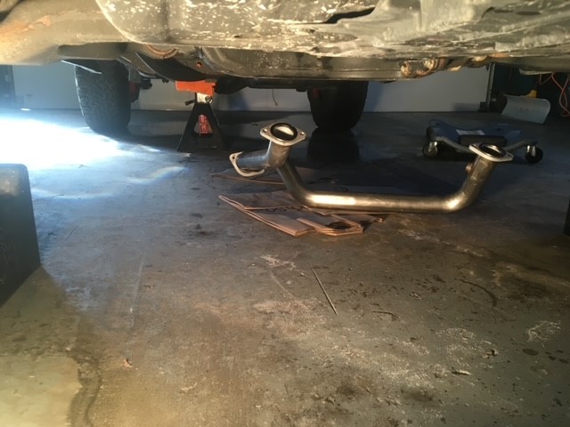

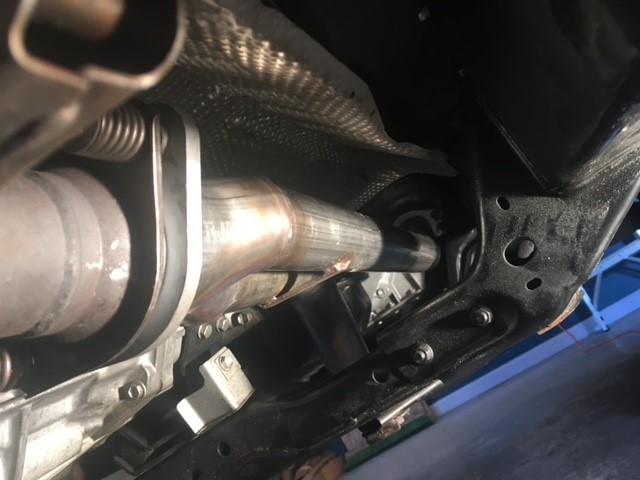

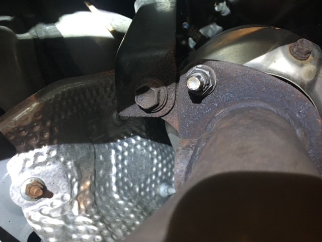

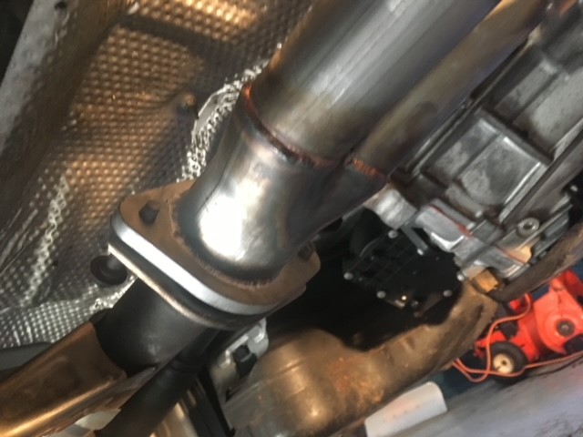

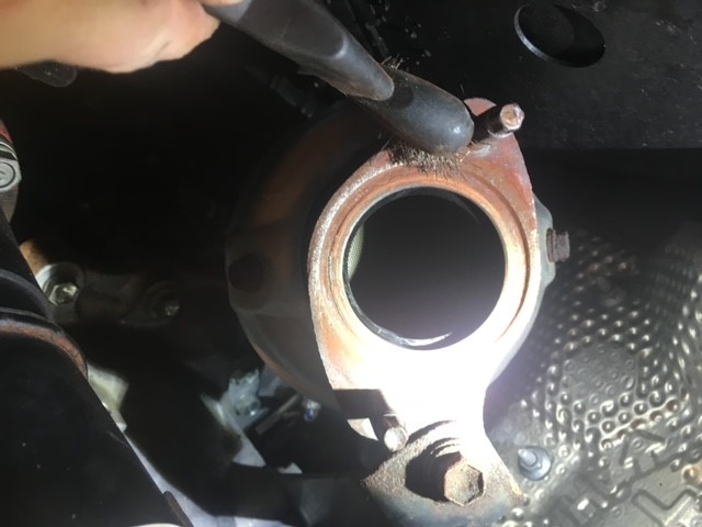

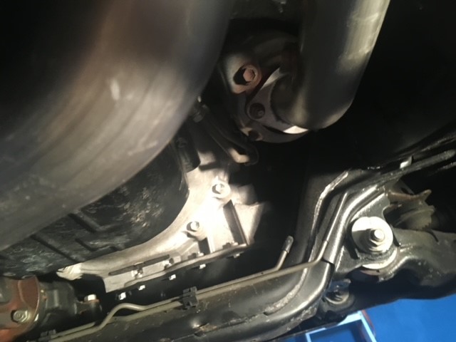

I installed the URD Y-Pipe this weekend. Here are some pics and few notes:
Use Areokroil on everything

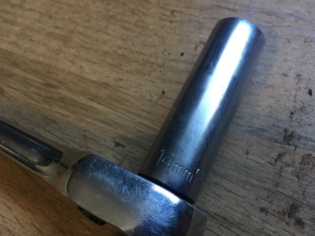

Remove the O2 sensors first, use the correct tool
Remove the silver hoop

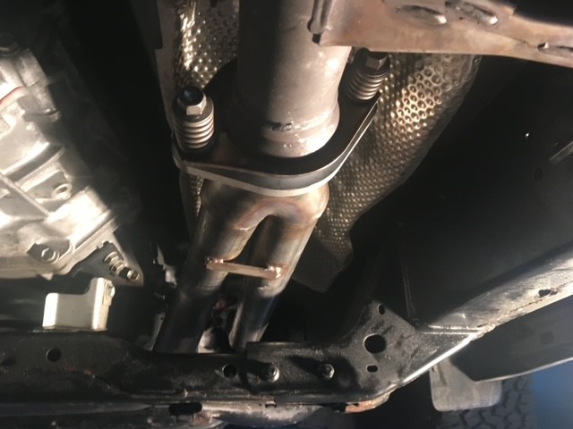

Hold up the muffler with a stand
Loosely conect the front two flanges, loosely!

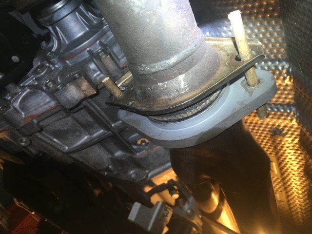

Use a couple wooden dowls to align the rear/muffler flange
Test fit the muffler flange with out the springs
Push up and down hard to get URD flange and Muffler flange to align
The gaskets are soft
Put front gaskets in late or they will get damaged. There is room to slide them in and get the correctly seated and the end of the job
Last step is reinstall O2 sensors
I have the stock muffler. I noticed no change in sound and a noticeable performance increase.

Have the Urd y-pipe on both 4r ,one has a flowmaster super 70ii & mine has delta 50suv model , very slight drone but at wot sounds (to me) like small block chevy back in the day ! I think has a nice sound to it . My only hassle is newer models 14'+ has a larger cat drivers side which as [MENTION=70753]badattitude[/MENTION] had to remove that bracket & where y-pipe merges with exhaust pipe little tricky bend there !
