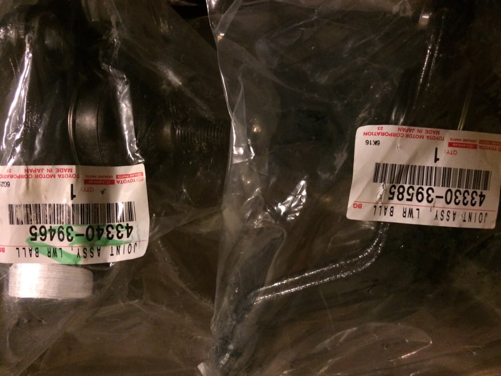

Oem LBJs

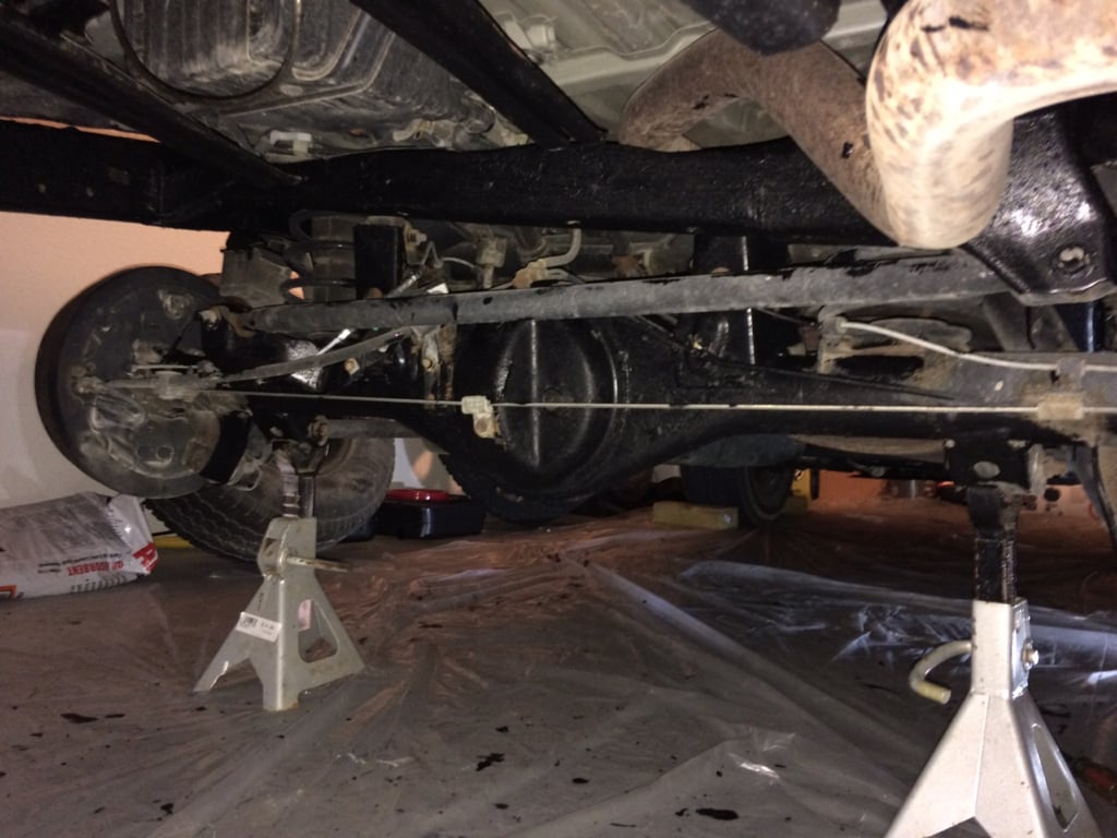

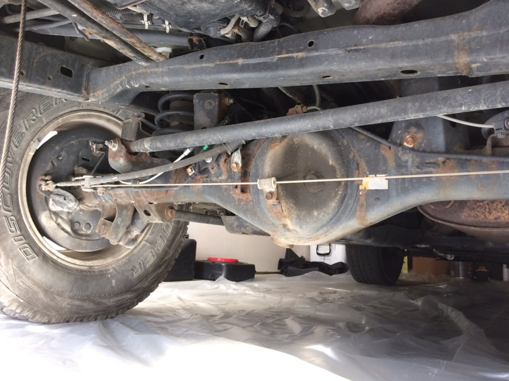

Extended rear diff breather mod.
Redline Syn in front and rear diffs
Transmission pan drop and refill with Toyota T-IV

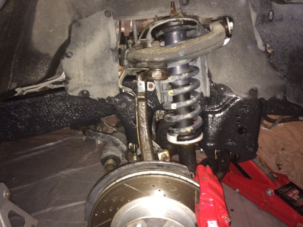

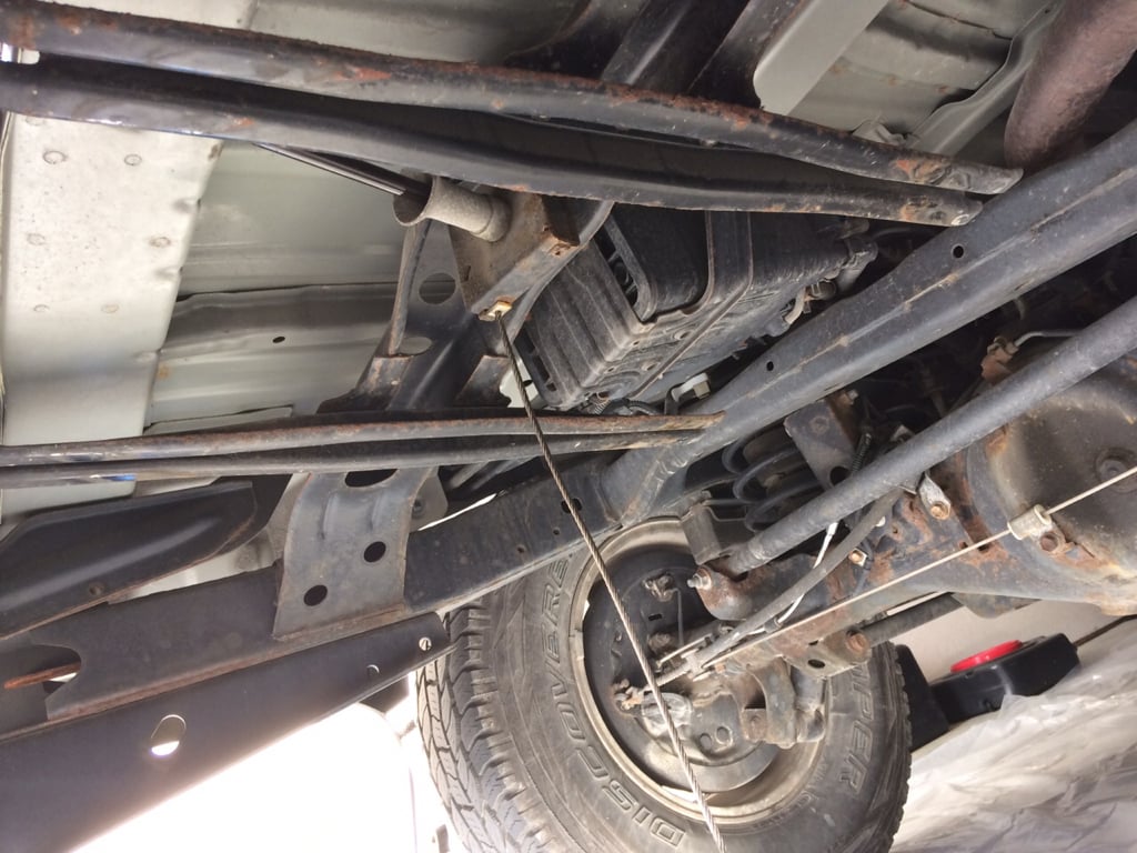

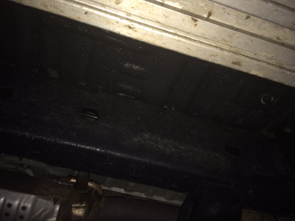

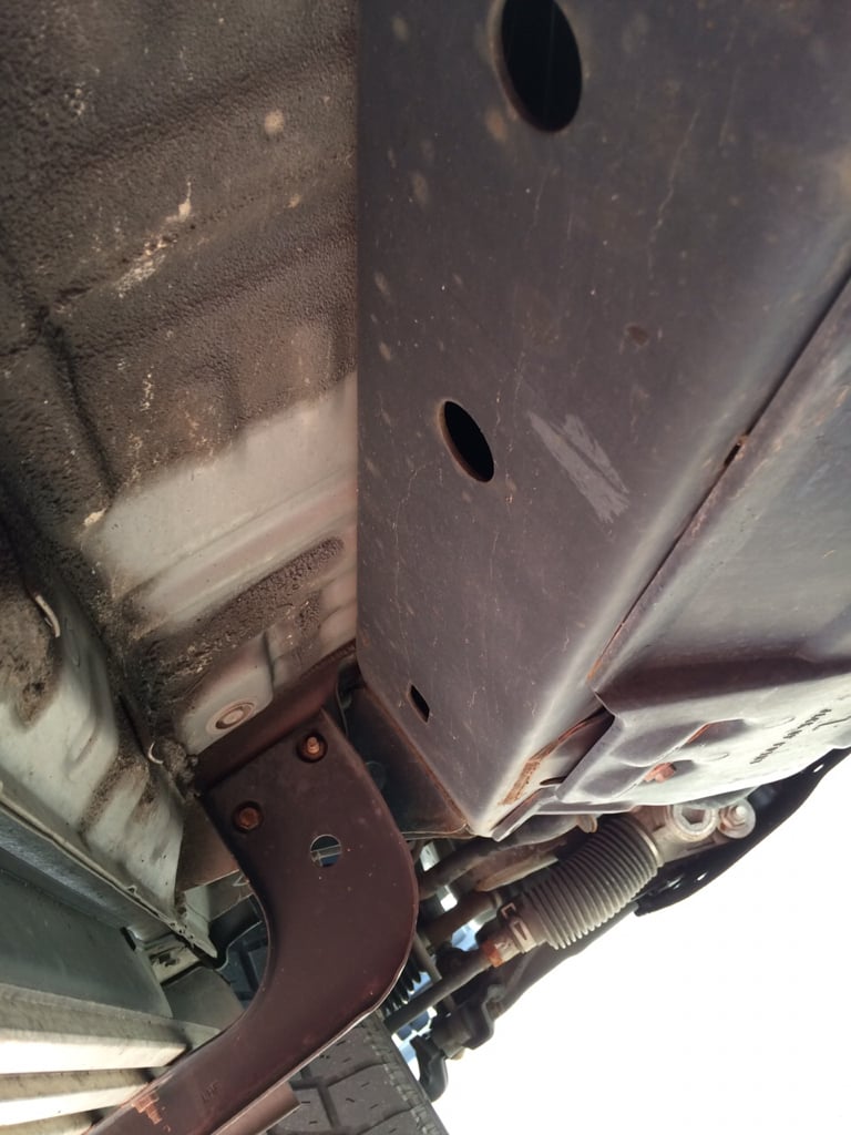

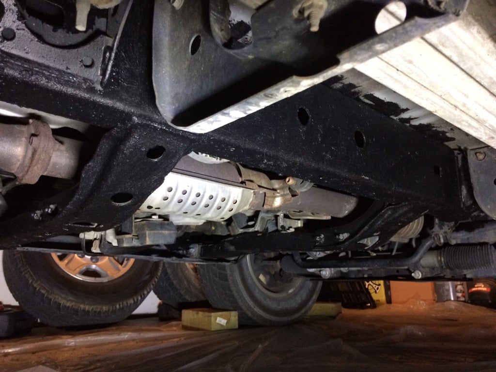

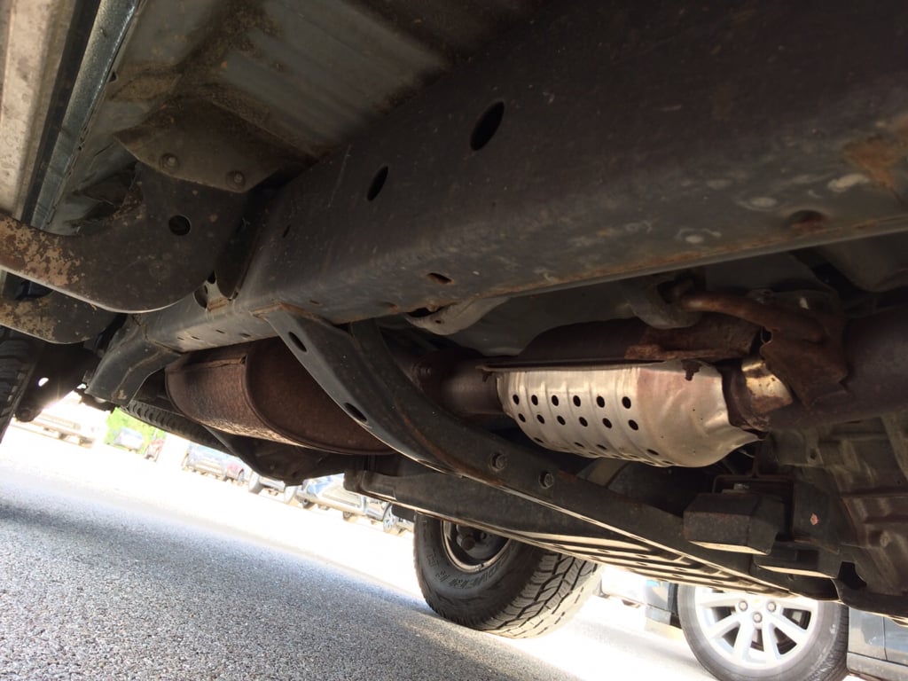

Painted the undercarriage with Dupli-Color Bed Armor

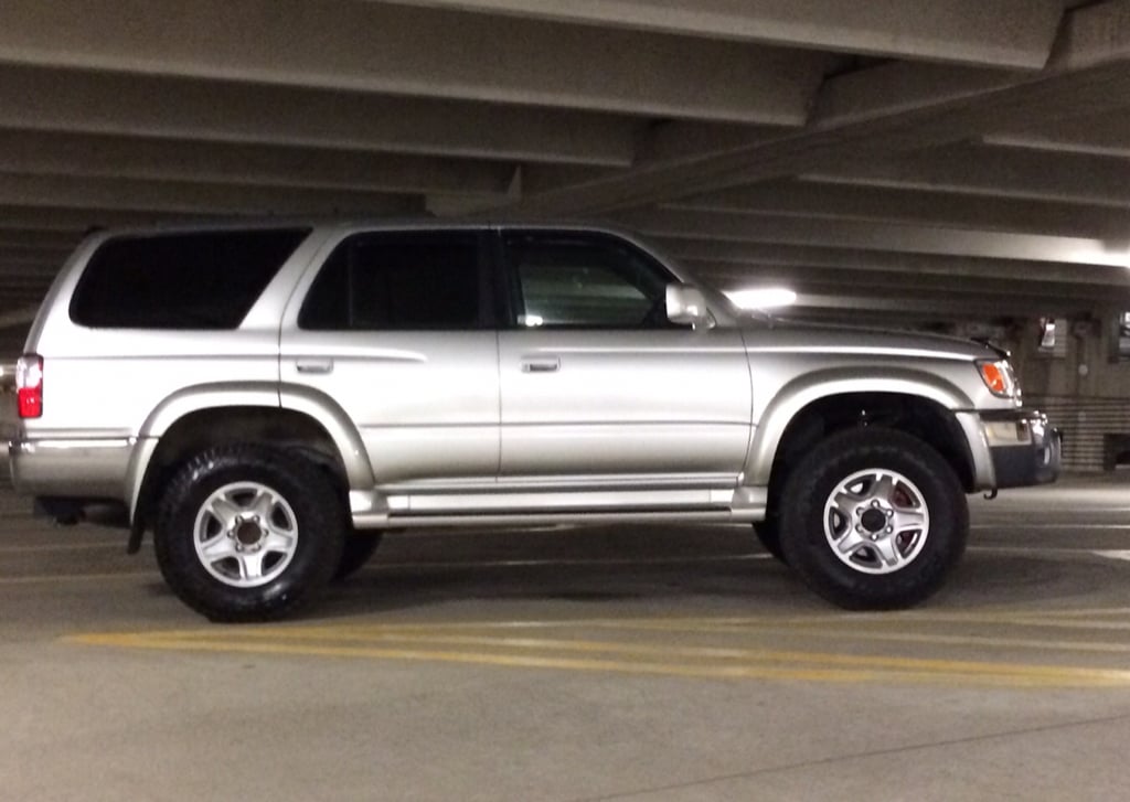

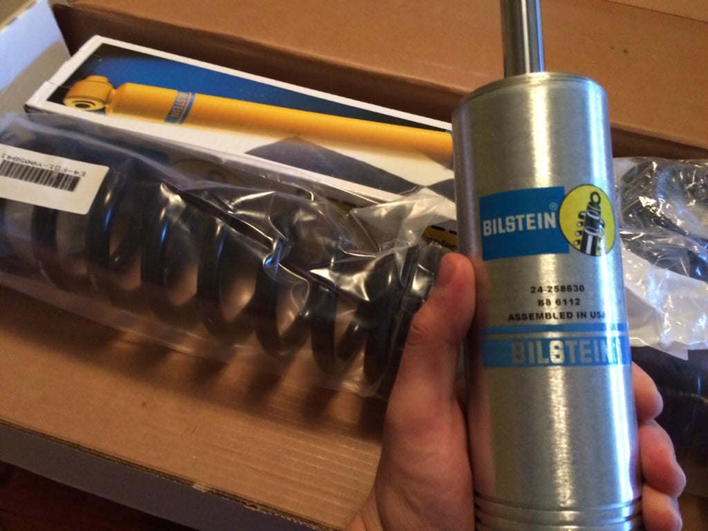

Suspension :

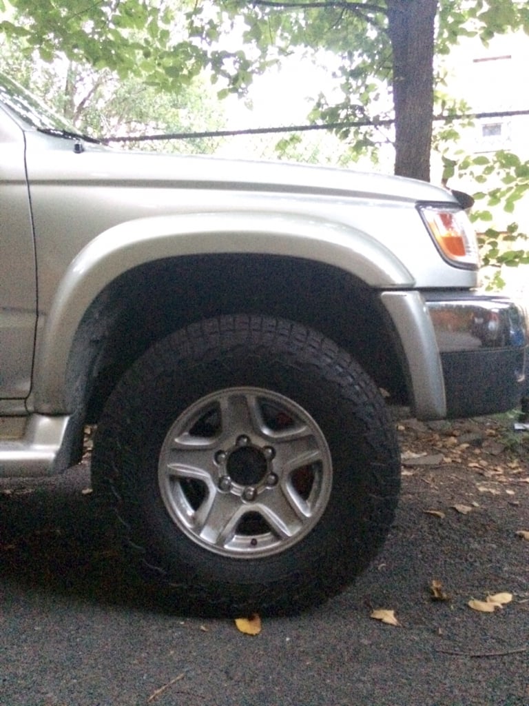

First i installed 99 tall coils and all 4 corners. The rears sagged worse than the 01s so I installed 1.5" daystar spacers as well.
That setup only lasted so long.

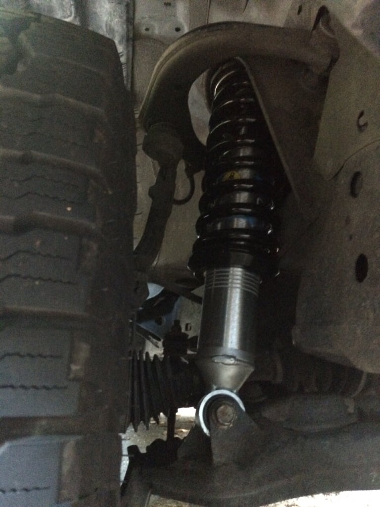

Now I am running Bilstein 6112 fronts set at the (6/7) position and OME nitrocharger rear shocks with 890 coils.

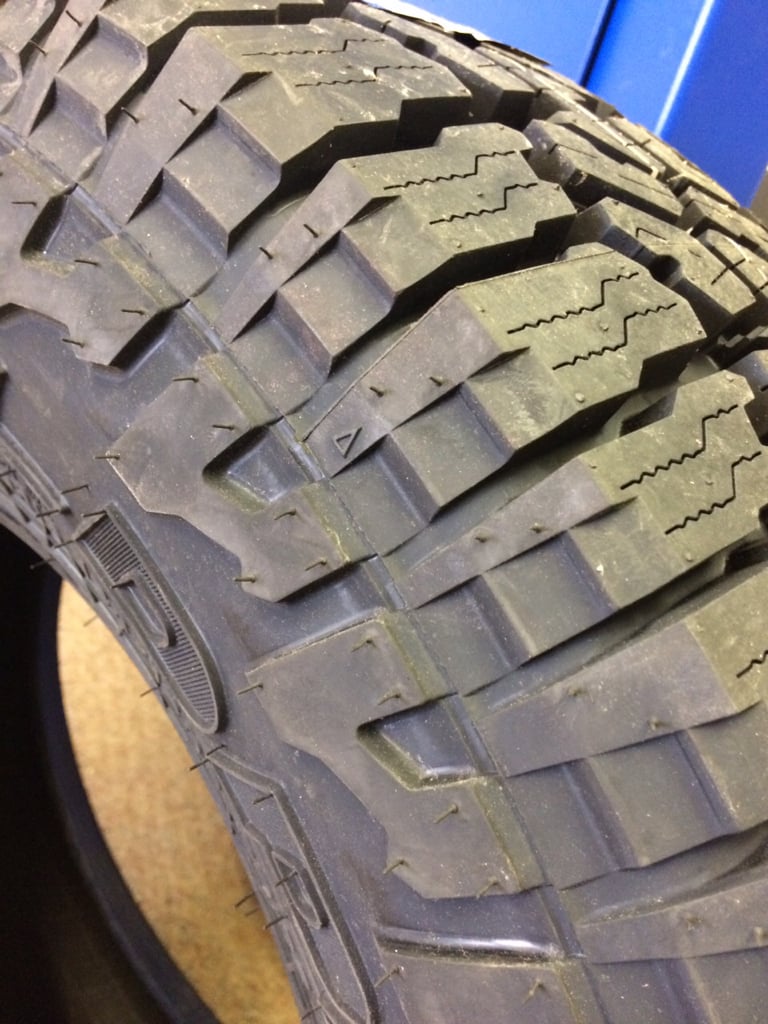

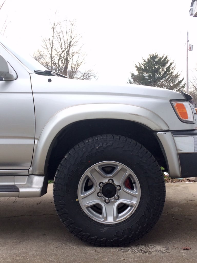

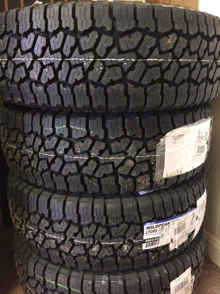

265/75/16 Falken AT3/Ws. Terrible tires
I will not run a set of Falkens again.
They will not balance out after 4 tries including using road force balancing with the Toyota adaptor.

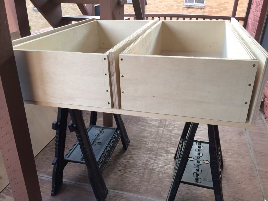

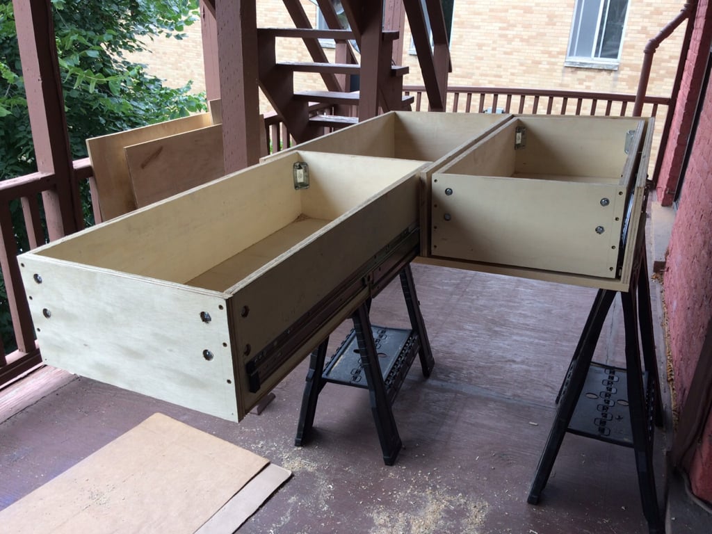

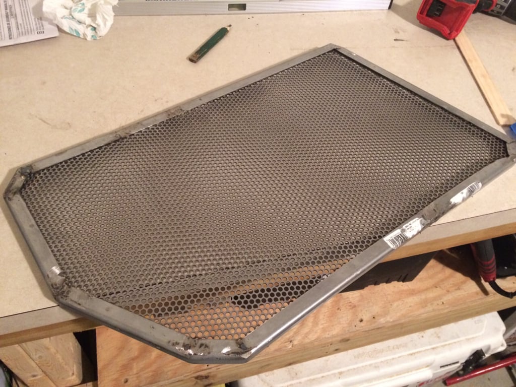

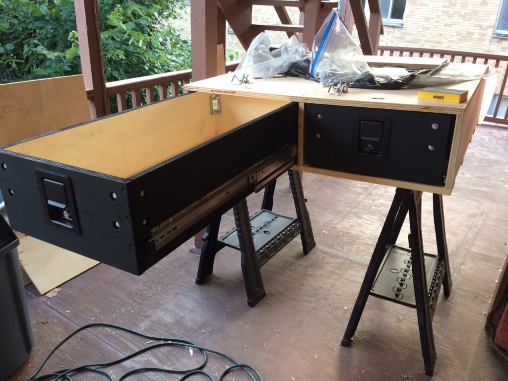

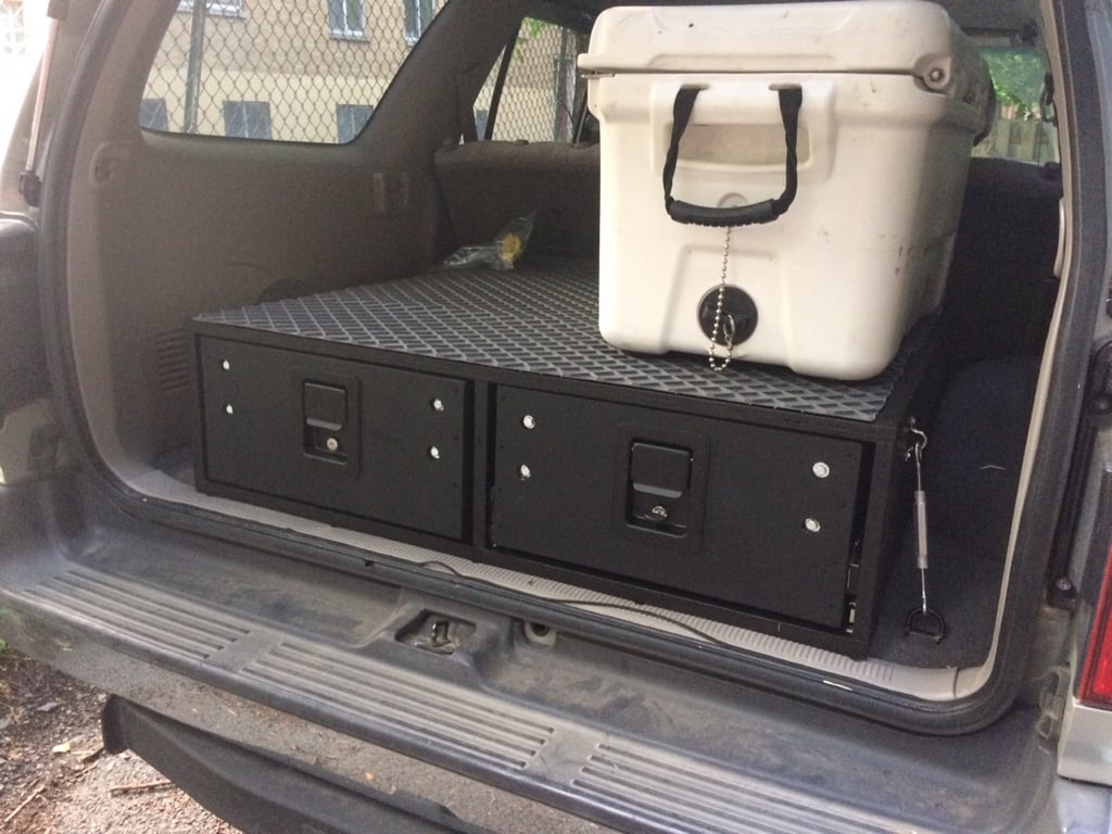

I built a rear set of drawers that I'm pretty happy with.

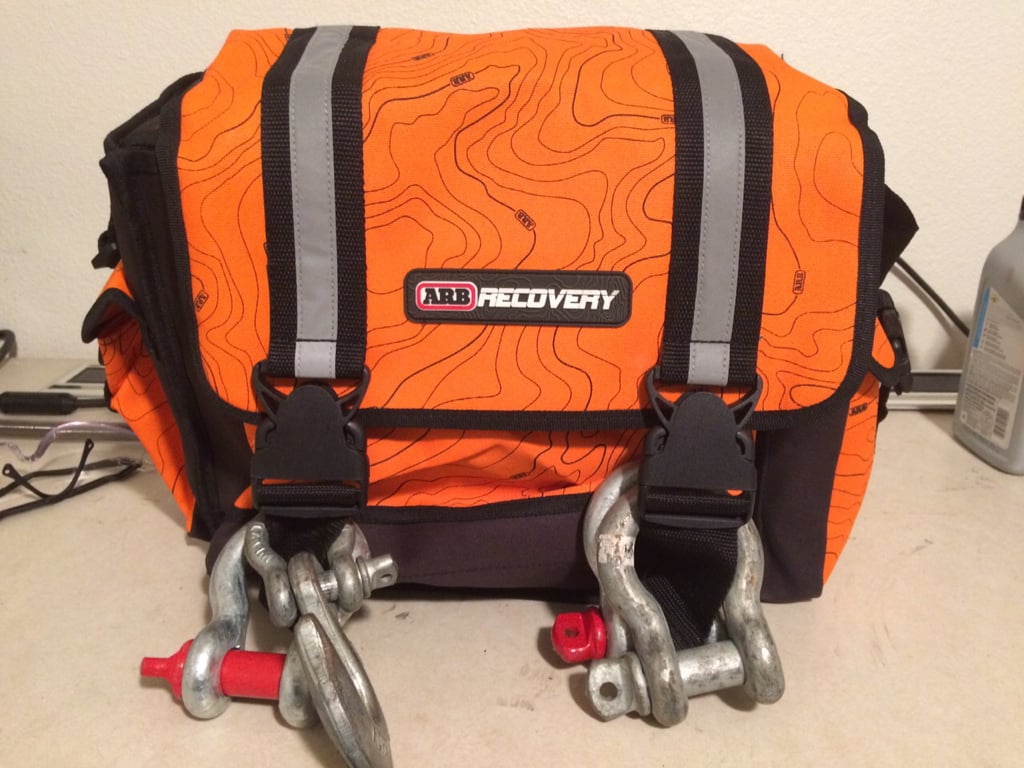

Full recovery gear set in ARB bag

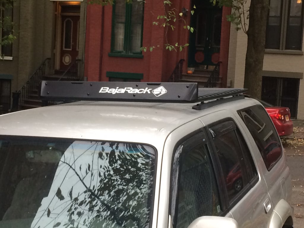

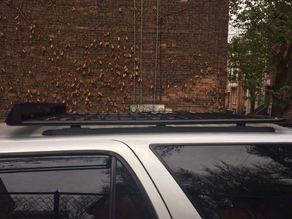

Ordered Baja utility rack (eta: 4 weeks out)

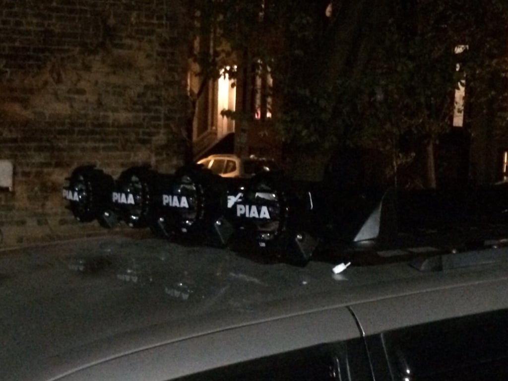

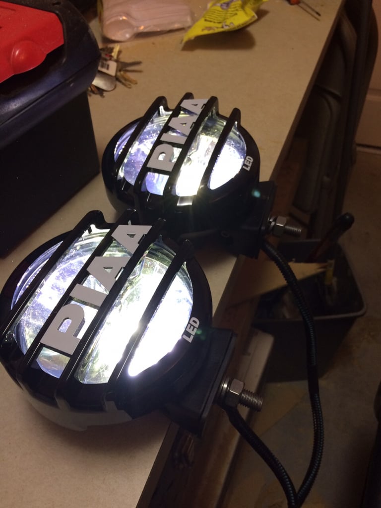

4 PIAA LP550s leds light on the Baja rack

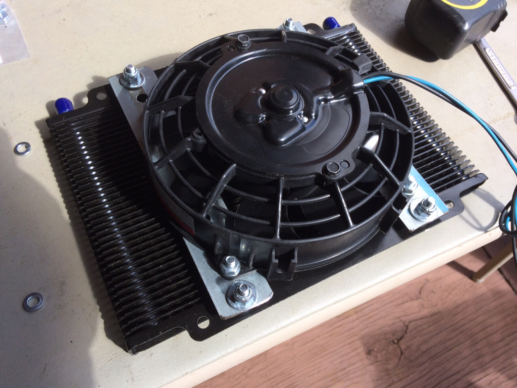

B&M transcooler with Derale e fan

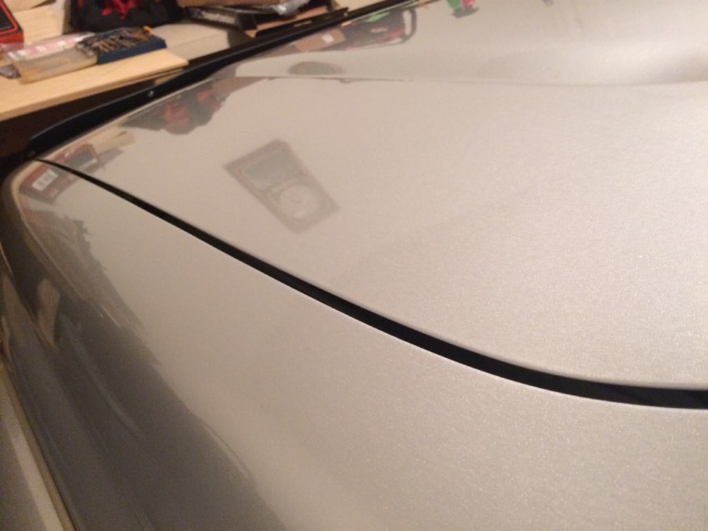

I good detail job on the paint. It really didn't need much help

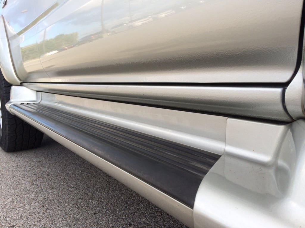

Pull running boards, have rocker panels sprayed in PTM millennium silver Line-X.
Install shrockworks sliders.

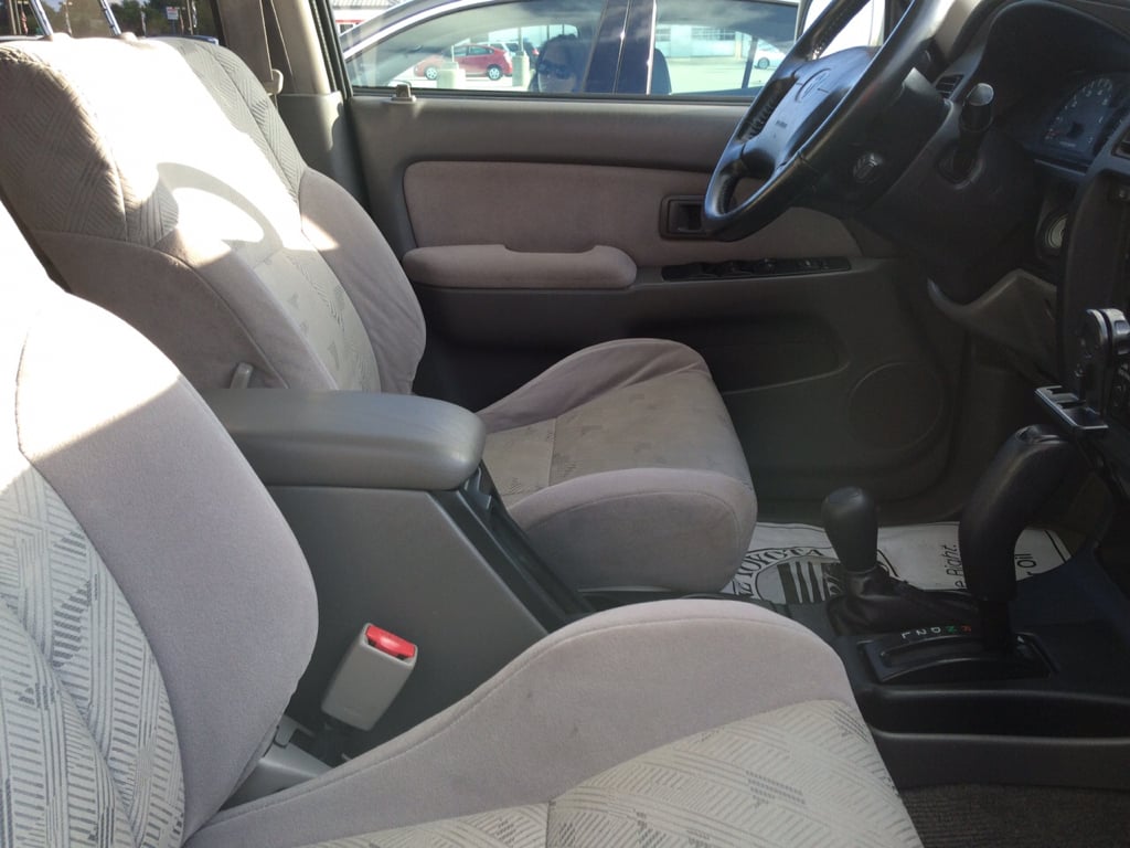

Amazing color! You sure it's not an '02? I ask because your cloth seats were only available on the Sport models in '01, but became standard in '02. Or maybe they were still an option in '01?
Nice truck!
I have these same seats in my 2001 SR5. I think most sports got the "mesh" type of seats, but not all of them, like BFAD has the same seats as me and OP in his 01 Sport.

Very nice, I swear I was reading my own build thread for a minute. Very similar path of mods. Drawers look nice, I need to build a set too..
Is balancing the only issue with the Falkens? How do they do in the rain ?
Interesting. My best guess is that it was an optional upgrade. Every '01 Sport I've seen has these seats and every '01 SR5/Limited with cloth has the standard cloth seats.
Tangent, but I really want the '02 cloth seats!

I am not impressed with their performance. Rain is fine like most other All terrains. I don't see how they have the snowflake emblem though...Traction in the sand was poor: aired down to 15psi, locked in 4L. I can't look past the balancing issues I am Driving 75 miles a day and the shaking is beyond annoying.

1. Power wash undercarriage.
1. A: undercoat any bare spots I missed earlier
1. B: fluid film entire undercarriage, instead body panels, etc. hopefully the case of 10 I ordered is enough
2. Install trans cooler and fan

Install Baja utility rack and wire PIAAs.
4. Continue to fight with Toyota dealer and/or Falken to get the tire balance figured out.

You ever thought of trying those balancing beads you put in through the valve stem? I've heard good things about them
Sent from my SM-G930V using Tapatalk
It has crossed my mind but I don't know enough about them to see if they are beneficial. They are mainly for people who have nice wheels and don't want want to look at wheel weights correct?
I have some Treadwrights that couldn't be balanced so I tried the beads and it's better but not great. Going to give Treadwright a call and see about getting them swapped out.

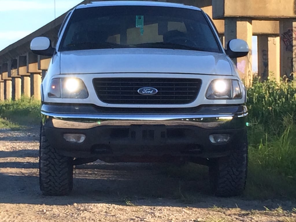

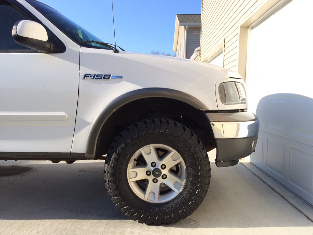

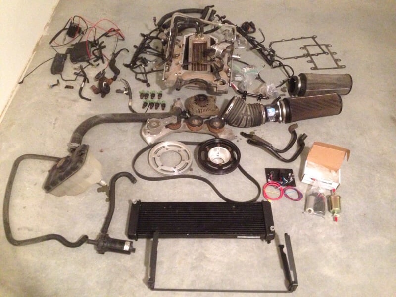

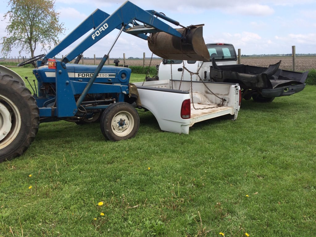

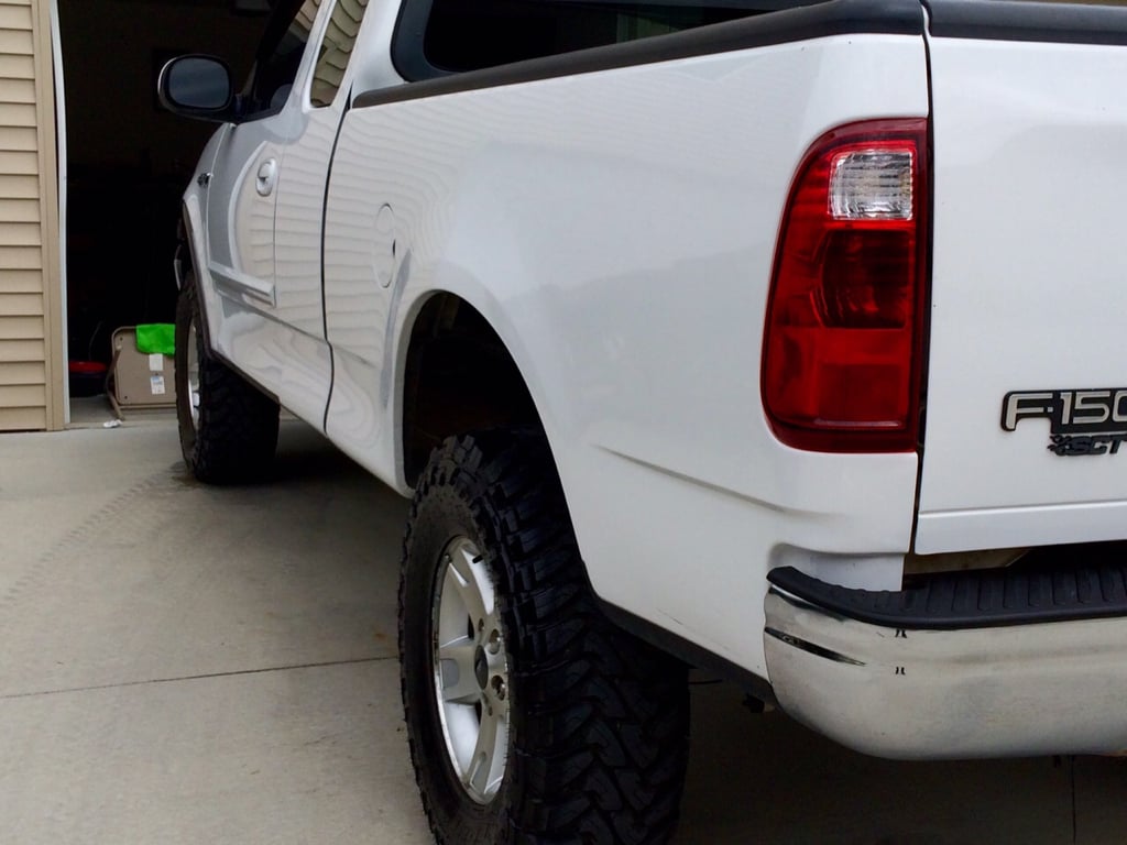

Original plan was to keep the runner stock and drive it everyday. My f150 was become my toy and get the garage space.
Shamelessly parted the f150 out that I had since HS
5yrs and 100,000 miles later I
Swapped a rust free body, put 34" Toyo MTs, front and rear diffs rebuilt, 4:10s, Detroit in the rear, chromoly shafts, the works. HID retrofit heads, custom alum driveshafts, full gauges. Truck was stout and the best vehicle I ever had. Extremely reliable and never left me stranded. The gear swap was the downfall of the truck. I paid a shop almost $3,000 it do it and it got redone 5 times and spent 89 days at the shop. He couldnt get it setup right, and kept sending me bills. I wasted so much money on needing a rental car, getting rides to work, and taking vacation days while it sat at the shop. Finally got tired and took it to another drivetrain shop, paid to have to redone, and sold it the night I picked it up. Sold the lightning super supercharger swap to a HS kid for a good chunk of change.
New owner texted me and his wife totaled it last week

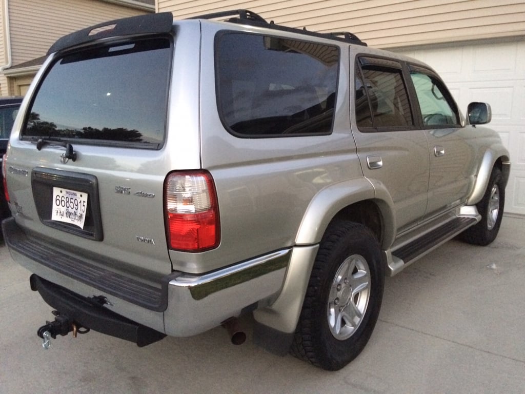

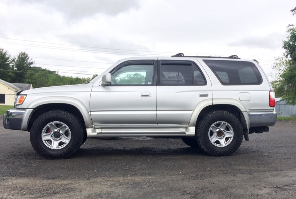

Most recent.
Not as tall as I expected with the 890s and factory cones. I'm sure it will look taller with the running boards removed

Baja rack is delayed as they are backed up. I thinks I'm going on week 9 since I placed the order. Finally, I am hoping to grab a savage skid plate set if they put out any Black Friday sales
