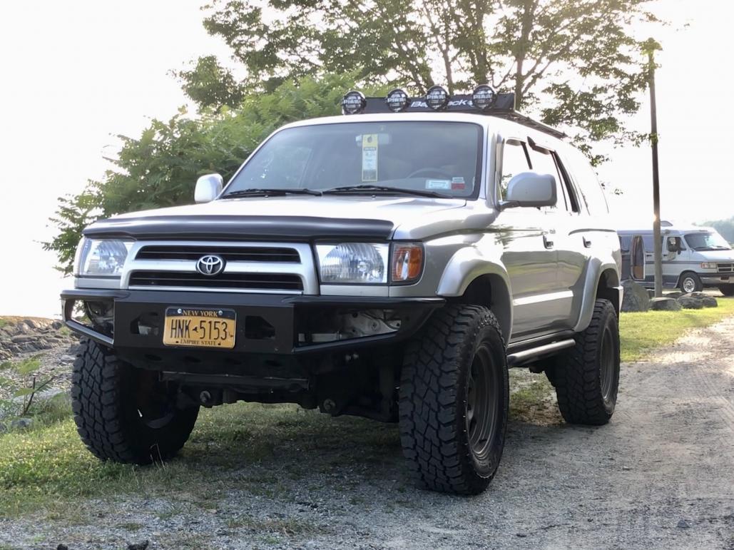

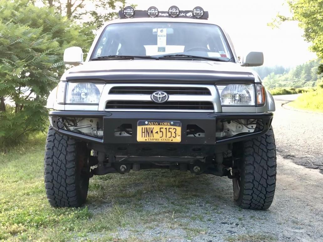

Installed my freshly powder-coated TNF open wing hybrid bumper

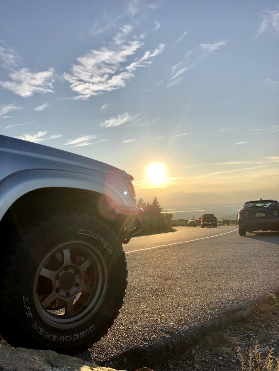

And then drove a 1000 mile round trip to Acadia National park
Nice!
Nicely done my friend. I would love to get that front bumper on my Jade. Did you weld it yourself?
