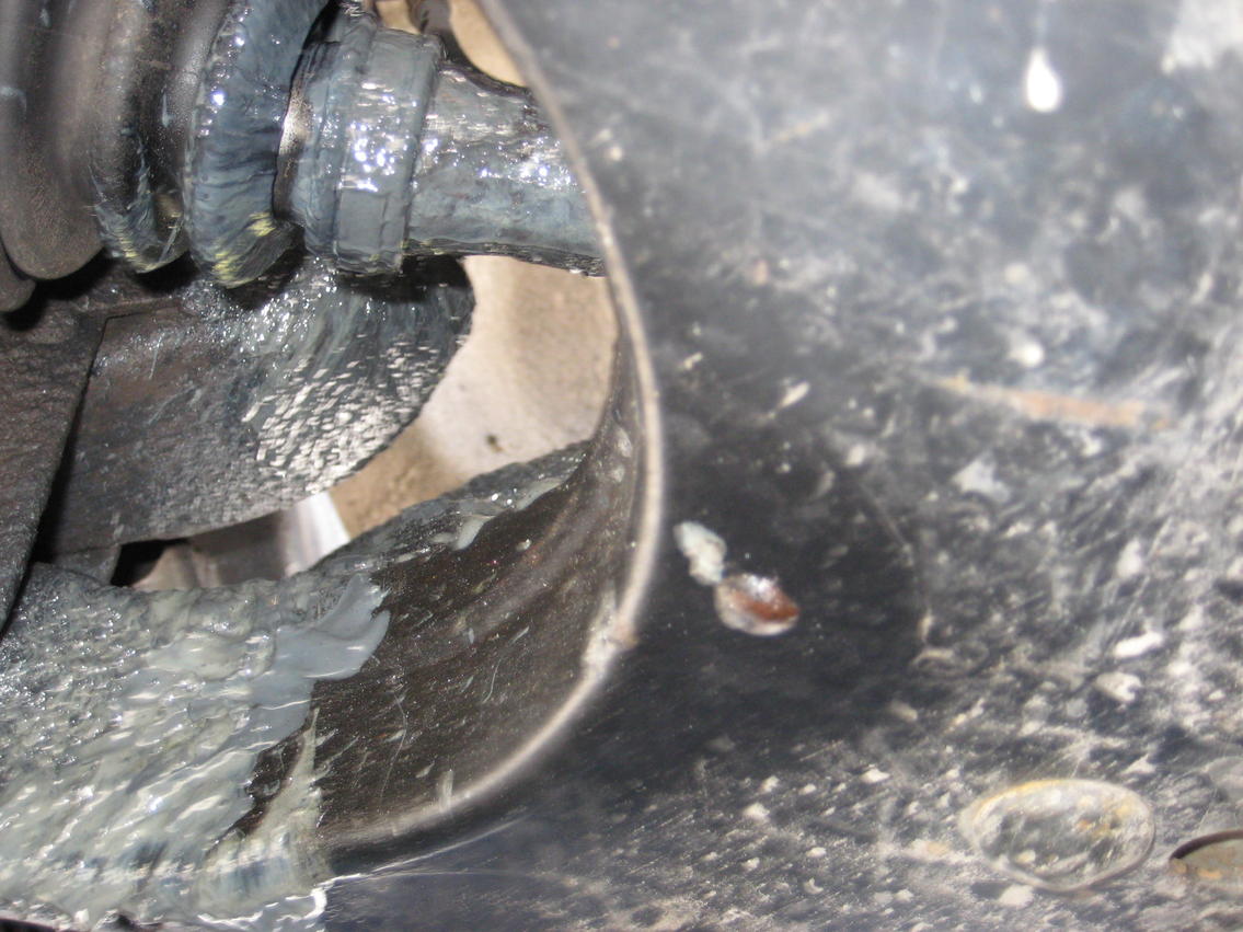

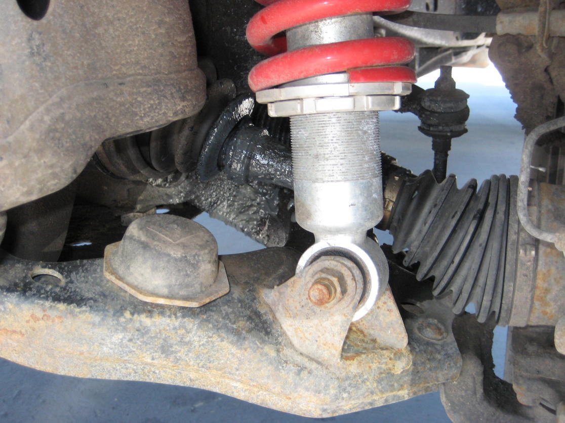

I can not seem to find out how to post a new thread either but hopefully someone will answer my questions. I installed the toytec 3" coilovers with the bilstein 5150's in the rear. Overall I am happy and the 4 runner looks and rides great. So looking at the pictures below I must have screwed something up during installation as I have serious grease deposits all over the CV joints and lower control arms that started occurring right after I installed the lift. My questions are:
What did I do wrong?
What needs to be replaced?
How important / expensive / hard is it going to be?
And should I upgrade to an aftermarket part if I need to replace something down there?

That upper CV boot looks complete torn away from the CV axle. I'd get the CV rebooted or completely replaced depending on how long this has been going on. Also, if you haven't already looked into a Differential Drop you may want to. It'll relieve some of the stresses and angles that the CV axles are now at with a lift. See Differential drops here at ToytecLifts.com.
Also, there's a "NEW THREAD" button above the threads that you can use for new threads. Hope this helps!
