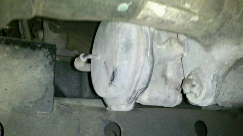

I don't mean to steal your thread but I'd like to get a lift question answered and can't figure out how to start a new thread. I just installed the Ultimate on my 97. The first time in 14 years I've ever spent any time underneath. This forum motivated me. After I installed the diff drop and as I was trying to figure out how to mod the skid plate I noticed what I think is the motor to engage the 4wheel drive (name?) almost rubbing on the cross member(name?) Should I be concerned? The pic makes it look like they're touching but I can get a peice of paper between them. Without the diff drop there's almost an inch betwen the 2 pcs.
