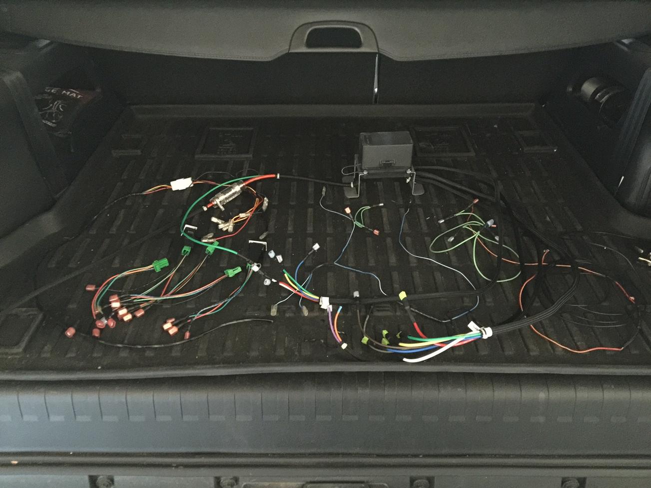

Now that I have lost my garage, I am reduced to only have the 4R power outlet as my only power source. It was good enough to run my soldering iron so that I could finish the harness wiring.
Pined up the 2 bussmanns. I will have to fab up some mounts when I have access to my tools and a garage.
And...Voila! Power to all the switches, lights and accessories.

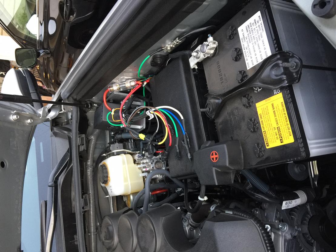

I got a few questions about the bussmann fuse box install so, I thought that I would share some details in my build thread
Here are some of the tools that I used to pin it up.
In this pic below you can see the different types of terminals required. You have the 2 tang female terminals for the male connector in the upper right, the tang male terminal for the female connector in the lower right, and the tangless female terminal for the bussmann fuse pannel on the left.
Below are the tanged and tangless difference. They are not interchangeable.
And again below are the different sizes for various gage wire.
Wire fitment and crimping
And finally, how you remove the terminals from the connector.
I opted to just pin up the fuse panel directly without a connector. Mainly to limit the amount of connections in the circuit. With it set up this way, if I ever wanted to remove the wiring and fuse box I would have to de-pin the entire box which is not to difficult...you just need to label where all the wires go if you want to put it back.
And voila, a pinned out bussmann!

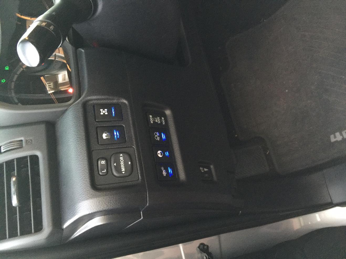

[MENTION=109515]YodaPride[/MENTION], got a second for some questions, well one specific question:
I tried installing the Air On Board switches for my RIGID lights, which have 3 wires, positive/negative/ground. The stock switches use the ground to power the internal LED when activated.
The AOB switches however have 4 wires. And while I was able to get the switches to turn the Rigids on, when I wired the ground up it made the internal switch LED stay on ALL THE TIME, even when the car is off.
Am I missing something? Do I need to splice the internal LED's cable into the positive or negative so that it only lights up when activated? What am I missing?

This is what I had posted earlier...
The problem with tying into the grey wire here is that the switches will illuminate with the Ignition ON. That is to say that the switches will be lit even with the lights turned off. They still dim just are on all the time.
I actually like it this way. The switch lights turn on with the ignition and turn off about 20 seconds after the ignition is switched off. There are ways to get it to operate the way you described but, I have not researched that in detail.

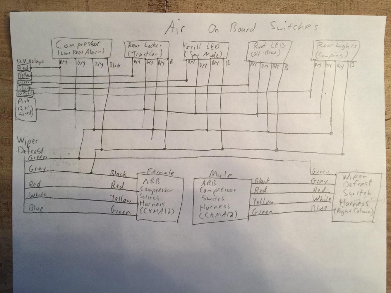

Wiring Bussmann & AOB Switches
I just wired up the Bussmann and AOB switches over the holiday weekend. Still have some cleanup to do, but all of the relays are working, including the dimmer function. Thanks for the info!
My plan was to complete the wiring for 5 switches since the Bussmann has 5 relays and my '15 SR5P has 5 open switch knockouts. I only have an ARB compressor hooked up at the moment, but figured this would make future accessories easy to wire in without having to open the console every time.
I had to move 1 switch to the right of the steering column (formerly reserved for the "party mode" switch) since I wanted all 5 AOB switches on the left column switch panel. The problem is, the factory harness isn't long enough to reach to the right column. So I decided to relocate the wiper heater switch since it had a dimmer function. Since I had to extend 1 switch harness AND find a way to tap into the dimmer circuit, it may as well be the wiper heater switch. In for a penny, in for a pound!
I've included a few pictures from my install. I sketched out a quick wiring diagram to keep my head straight. Hope it helps.
