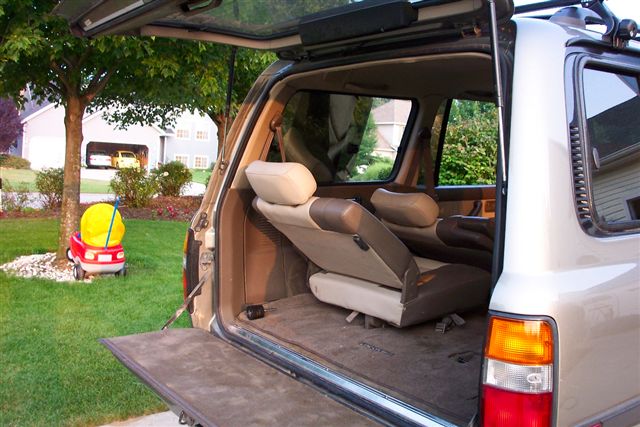

I've had adults in the third row, not roomy enough for a long trip for them, but my teenage/twenty-something kids have ridden for hours without complaint. The seat recline mod helps significantly. I've also fit a John Deere riding mower in there with the seats folded up and hatches closed, it's a bit more room than my T4R.
