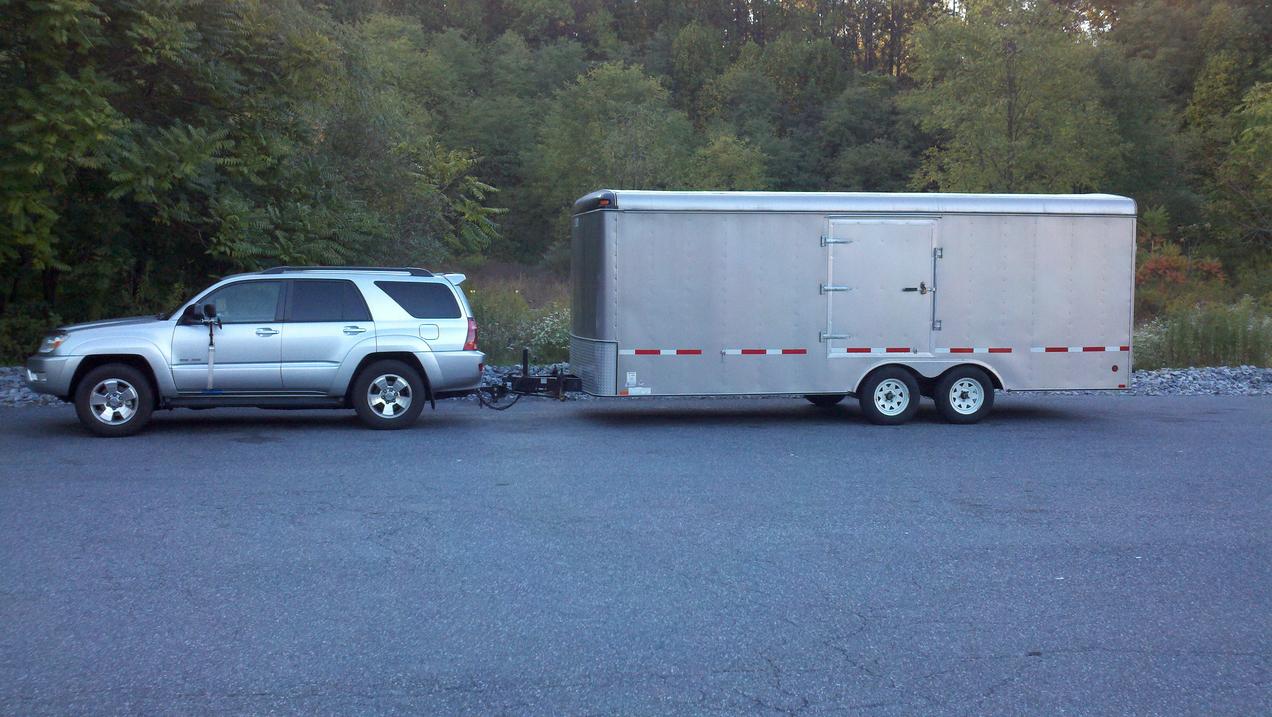

I have attached a photo of my old 4Runner taken during one of my towing trips. If you magnify the photo you can see the hitch I used back then which is the same hitch setup I use now with my Toyota Tundra.
Also depending on the width of what you are towing you may have to consider towing mirrors to supplement the stock 4Runner mirrors. In my case I had to have them since I was totally BLIND due to my trailer's 8.5 foot width. You can see these mirrors in the photo as well. They are excellent quality McKesh mirrors not the cheap/crappy clip on mirrors.
