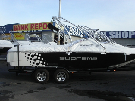

I have towed a 23 foot wakeboard boat all over my state this summer with my 04 4WD V8. Loaded up as usual, I am sure it tips the scales at 6000+ a few people. I have towed probably 1000 miles, and I couldn't be much happier. I tow with overdrive off and on moderate hills it does kick down to 3rd gear. 150 mile hauls each way were no problem. If I had to deal with big hills, I think I would have a lot more trouble. However Wisconsin isn't really big on mountains so it works just fine. The rear squats a bit, but not too bad. For distances less than 3 miles and under 45 mph I have towed 7K I bet. No issues.
You have to look at the terrain where u are towing, but it does do a good job for what I have. I boat a lot and I am still using my vehicle less than 5% of the time for towing. I like the fact that I get better mileage than tahoe's and burb's on the daily drive. I think it's the perfect more budget minded reliable tow vehicle on the market.
If this pic works, here's the rig I'm hauling
