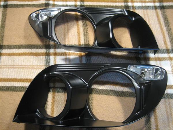

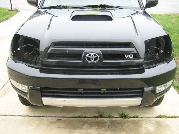

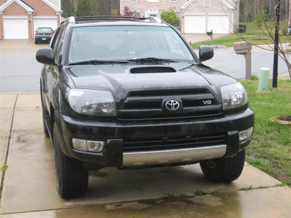

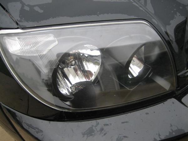

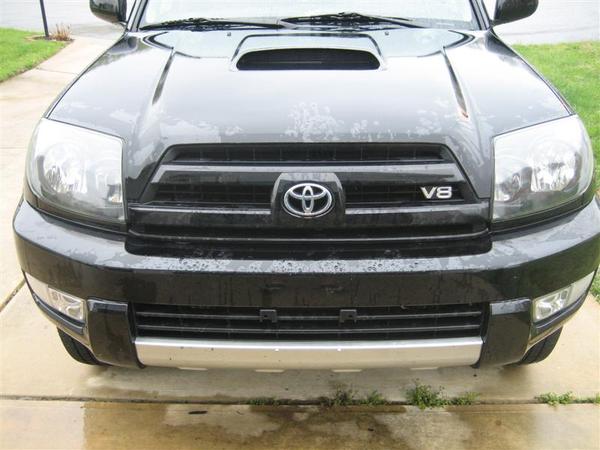

DIY Black Headlights

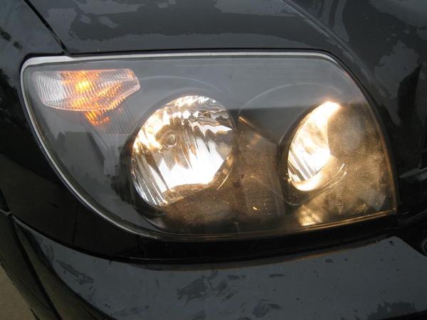

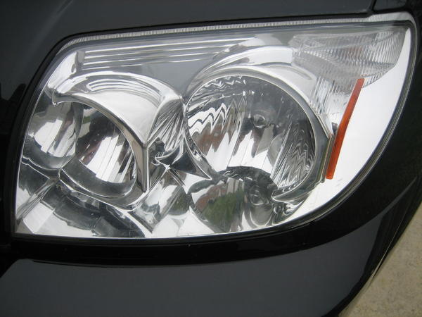

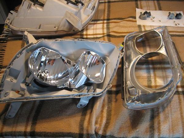

Well, based on a lot of other threads here, I did the DIY black headlight mod.
I ended up using Krylon's Fusion for plastic, satin-black. (Looked at flat and gloss, and decided to split the difference.)
Anyway, I don't want to reinvent the mod write-ups, so let's get to the pictures...
Before.
Before closeup.
Looks sad with no headlights.
After baking for 10 minutes at 200 deg F. (Tried it at 8, needed another 2.)
I taped off the parking light reflector area, and then laid on about 4 coats.

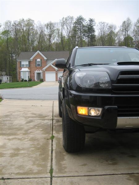

Installed.
Closeup lights off.
Closeup lights on with brights.

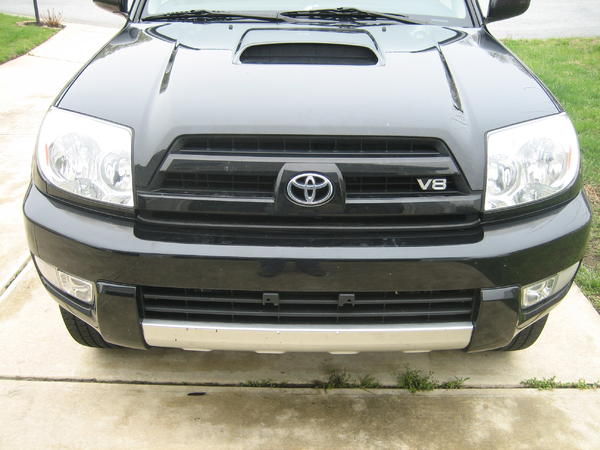

Finally, an after shot.
I don't know what else to say. It took about 3 hours total, but most of that time is just waiting for the coats of paint to dry.

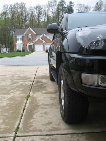

I like them, but I'm a little worried that the rear tires are sticking out too far. Here's a better angle.
I took them for a test drive, and I'm getting a little rubbing while going in reverse at about 3/4 steering deflection. I got out and looked, and it's actually the front mud flaps (behind the front wheel). Those are easy to take off, so I might do that.

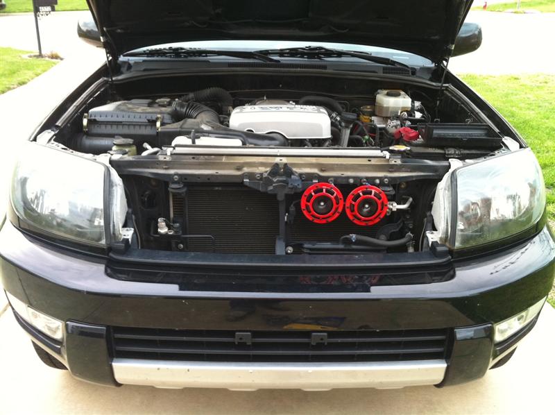

Hella Supertones
Well, last night my Hella Supertones came in ($50 from Amazon).
I got them installed (see pictures) and I think they look awesome.
While they are a little louder than the stock horns, they are far to high-pitched for my taste. Somebody described them as Civic-sounding.
Yup. (And we own a Civic!)
I think I'm going to return them.
I did return them. I spent some time on youtube and have settled on trying to get the Fiamm El Grande horns. When those come in, I'll report back.

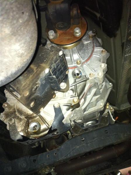

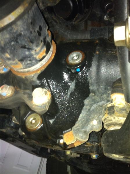

Changed Differential and Transfer Case Oil
Well, yesterday, I finally got around to changing my differential oil.
I ended up buying 7 quarts of Amsoil Sever Gear SAE 75W-90.
6.6 pints (or 3.3 quarts) for the rear differential.
3 pints (or 1.5 quarts) for the front differential.
3 pints (or 1.5 quarts) for the transfer case.
I ended up having a whole quart left over, so I must have left about a tenth of a quart in each area, which makes sense.

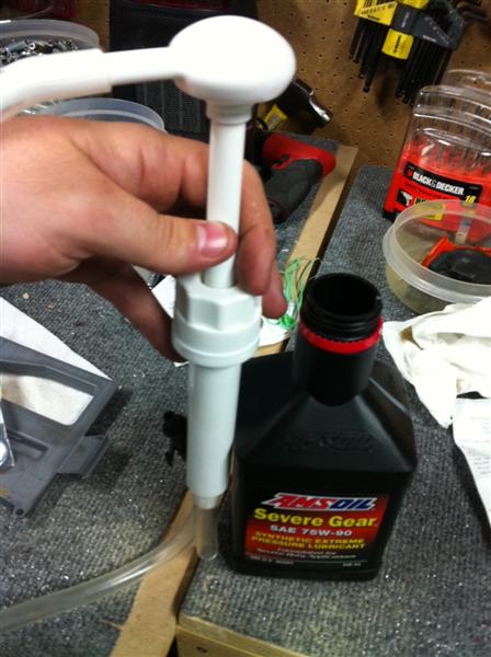

I also bought a "gallon jug" pump and four 8,000 ramps from Autozone. (The pump is labelled as a gallon jug, but it comes with different sized extensions, the one shown in the picture perfectly fits a quart bottle.)
Later edit: THIS THING SUCKS. It takes forever. I bought a "fluid transfer pump" from somewhere else (I forgot where) and it pumps the whole quart in about 4 slow pumps. Way faster.
zachattack-albums-differential-transfer+case+oil+change-picture3418-photo-5-medium.jpg
Anyway, there are plenty of writeups around for this, but I figure I'd document it as well as I could.

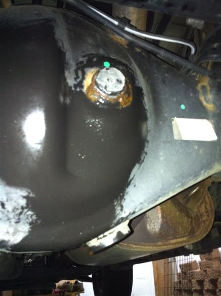

Here's the rear differential:
Top bolt is fill port: 24mm socket, 36ft-lb, uses 12157-10010 crush washer.
Bottom bolt is fill port: 24mm socket, 36ft-lb, uses 12157-10010 crush washer.
zachattack-albums-differential-transfer+case+oil+change-picture3419-photo-6-medium.jpg
Here's the transfer case:
Top bolt is fill port: 24mm socket, 27ft-lb, uses 90430-18008 crush washer.
Bottom bolt is fill port: 24mm socket, 27ft-lb, uses 90430-18008 crush washer.
zachattack-albums-differential-transfer+case+oil+change-picture3420-photo-7-medium.jpg
Here's the front differential:
Top bolt is fill port: 10mm hex, (didn't have torque wrench for hex), uses 12157-10010 crush washer.
Bottom bolt is fill port: 10mm hex, (didn't have torque wrench for hex), uses 90430-24003 crush washer.
zachattack-albums-differential-transfer+case+oil+change-picture3421-photo-8-medium.jpg
Also, I used a LOT of paper towels (I'm still new to the fluids thing) and was smart enough to lay a couple of cardboard pieces under the truck. I still need to go get a creeper.
All of the old fluids were pretty black and smelled horrible (the transfer case was the least offensive), but I'm glad I changed these (at 87,000 miles).
Oh, and went for a test drive, and the vehicle definitely shifts in and out of center diff lock and 4Hi and 4Lo a lot easier and smoother.
Hope this helps.
