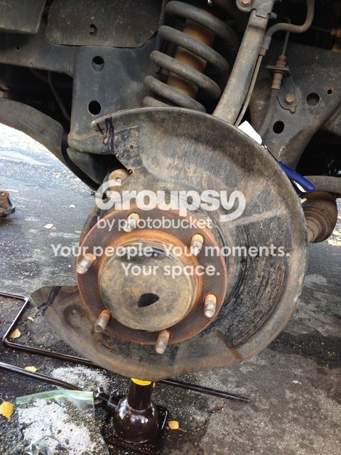

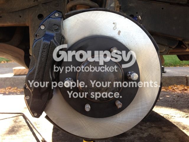

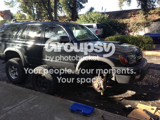

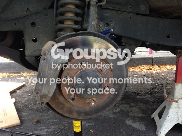

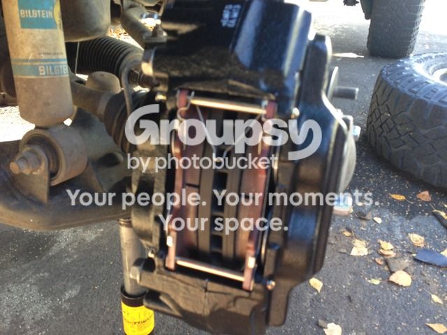

Finally got the chance to put on the Tundra Brake Upgrade (231mm re-manufactured NAPA calipers/OEM rotors/OEM pads/shims/Synthetic Dot 4 fluid). Very happy with this mod. Wasn't exactly a necessity as my brakes were fine, but it does stop much better, without having to let off and reapply like I sometimes normally would. Will Also come in handy when wheeling and pulling a trailer.

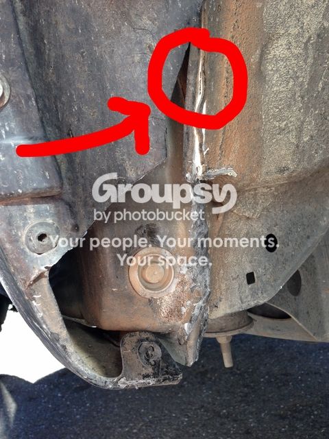

While I was in there, I pounded away at the pinch weld, in prep for 285's within the next few weeks.
Hope I didnt split it too much up there...
IMG_5838.jpg~original
EDIT**** Sprayed some "Just Great Stuff" foam in that crack, and painted it black. Nothings getting through there...we good :)

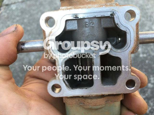

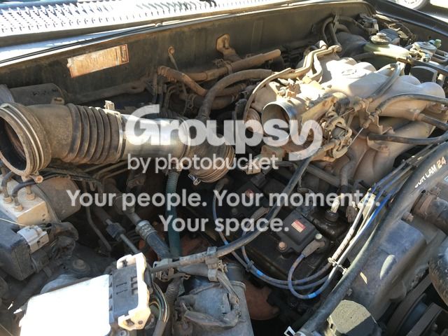

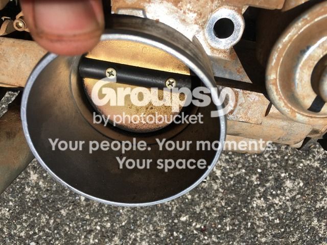

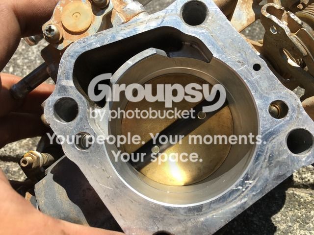

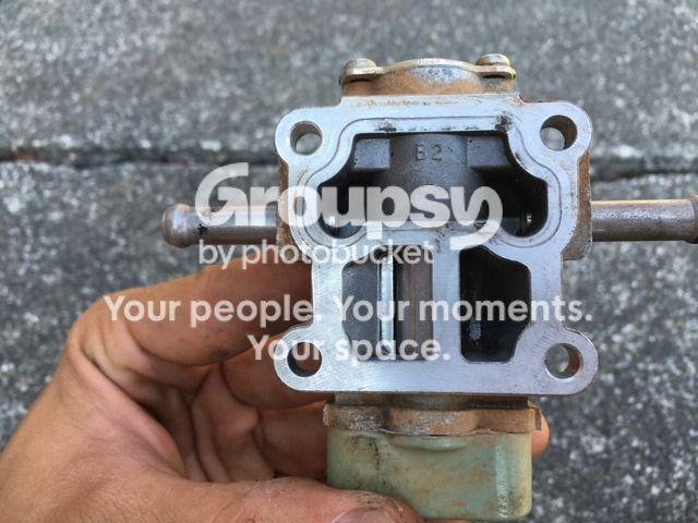

Was intermittently dieing after starting...and idle wasn't too stable. For the first time I removed and cleaned both the throttle body, and the IAC (Idle Air Control...located on the bottom side of the throttle body). Also seemed like a good time to change the spark plugs and wires (both NGK plugs and wires). Runs much better now.
IMG_8806.jpg~original
Cleaned out quite a bit of carbon around the edges.
