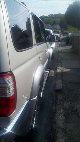

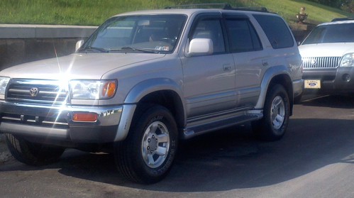

so ive been here on t4r.org since december of 2011, shortly after buying a 96 2wd sr5 4runner. just like everyone else i fell in love with modifying my 4runner and here i am...
2011-12-21_15-50-38_78 by zgensler31, on Flickr

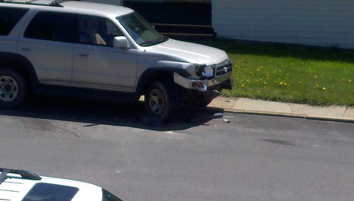

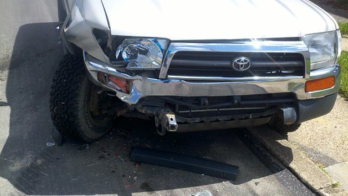

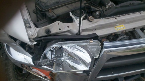

so only about 6 months after buying my first 4runner, i wake up at 2am and find it smashed up in front of my house....long story short, drunk chick...took off...found her a few days later...new 4 runner...
for those with more time, the details and more pics can be found here
couple quick pics...

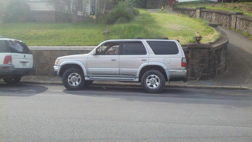

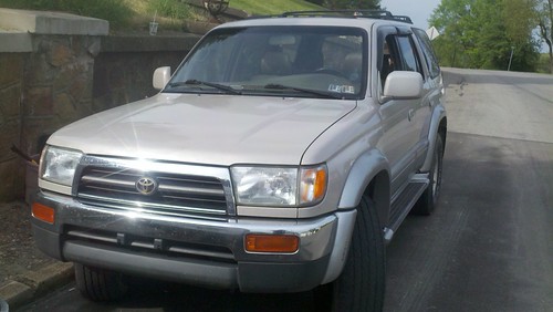

so..after haggling with the insurance company...i get my check and i get my new 4runner. this time a 96 limited 4wd with elocker...
2012-05-12_17-38-03_823 by zgensler31, on Flickr
2012-05-12_17-38-17_305 by zgensler31, on Flickr
2012-05-16_17-35-11_601 by zgensler31, on Flickr

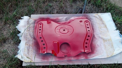

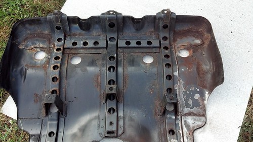

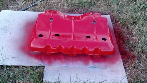

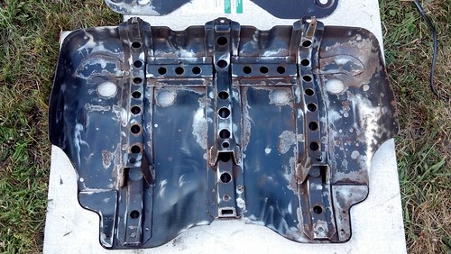

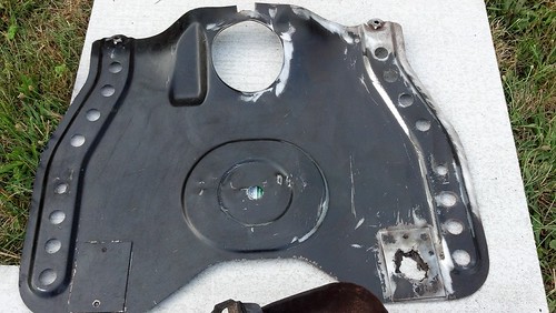

during one of my oil changes, i noticed some decent rust on the skid plates...so i decided to pull them off and get rid of as much of that as i could. also gave them a quick paint of coat to finish it off.
what it looked like when i started.
2012-07-08_19-01-47_108 by zgensler31, on Flickr
and after hitting them with the wire wheel.
2012-07-08_19-02-15_812 by zgensler31, on Flickr
2012-07-08_19-14-38_553 by zgensler31, on Flickr
it wasnt my best work, but it definitely prepared me for cleaning up the rest of my under carriage later down the line.
painted. rust-oleum primer and gloss protective enamel used for this.
2012-07-08_20-11-31_218 by zgensler31, on Flickr
2012-07-08_20-11-36_602 by zgensler31, on Flickr
and mounted back up.

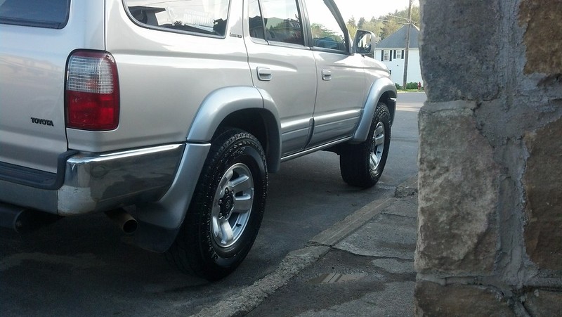

at first i thought it was a bit over the top with the red, espcially because it was till pretty stock at this point, but i love it now, and so do most of the people i talk to, i also plan to incorporate more red into my truck later on as well.

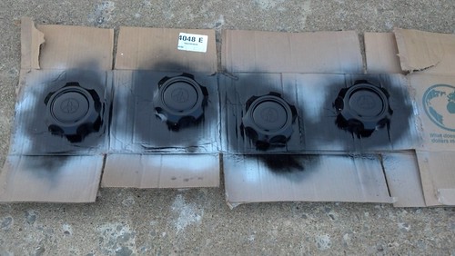

as you could see in the above pictures of my truck, the center caps on my wheels were in sore shapes. so that night i also painted them.
started with a white primer made for plastics made by rust-oleum, then a black gloss enamel by r-o. and i also painted the toyota t logo silver with some testors model paint that i had lying around. r-o clear coat to finish it off.
2012-07-08_20-11-52_66 by zgensler31, on Flickr
never did get a finished photo, but can be seen here from further down the line.

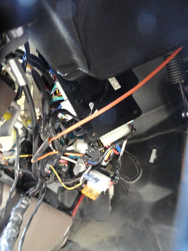

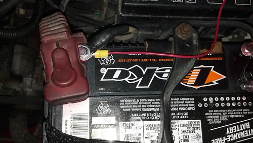

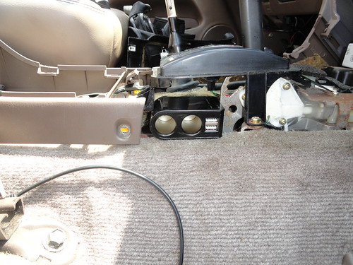

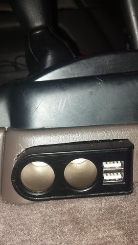

i added in an auxiliary plug and took care of an old alarm and stereo system that was installed in the truck when i got it. some pics here, and i have more if anyone is interested.
DSC02066 by zgensler31, on Flickr
2012-08-20_23-09-29_687 by zgensler31, on Flickr
rats nest that i inherited... all gone now.
DSC02024 by zgensler31, on Flickr
i installed a new battery around this time as well, went to the local battery wearhouse, its a local place that spcializes in, you bethca, batteries! the old one was old..like 7 or 8 years i think. and was giving my random fits with starting my truck. replaced with a deka brand stock sized with a great waranty.

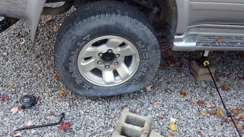

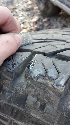

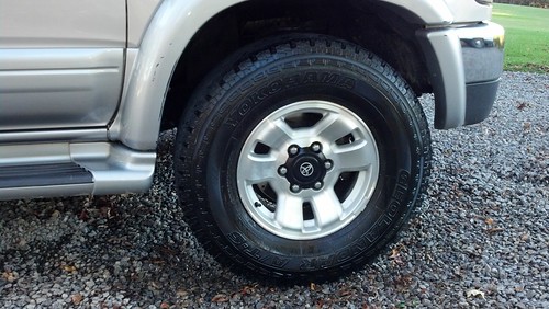

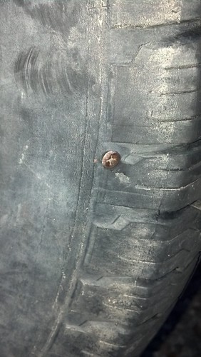

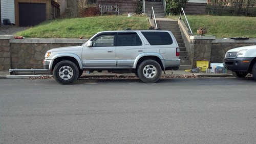

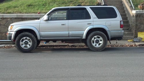

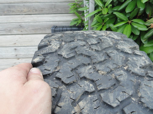

had been driving around since i bought the 4runner with a screw in the sidewall of the michelin ltx that were on it. never really gave me trouble and held air just fine, until i was doing some light offroading and disrupted the screw..
2012-10-08_18-28-24_65 by zgensler31, on Flickr
2012-10-08_18-28-14_173 by zgensler31, on Flickr

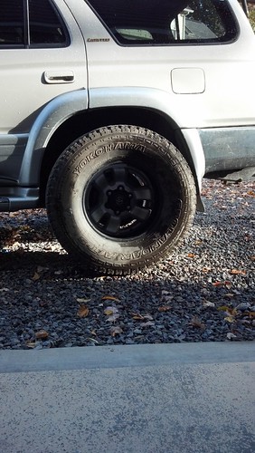

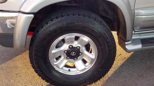

hadnt saved up enough yet for new tires, so to craiglists i went. i found a set of 265/75/16 yokohama geolander ats for a good deal, and picked them up the next day for $175. $24 mounting cost later i was all set with some new shoes.
2012-10-10_16-41-57_127 by zgensler31, on Flickr
2012-10-10_16-49-10_969 by zgensler31, on Flickr
2012-10-12_17-53-31_277 by zgensler31, on Flickr
2012-10-12_17-53-46_569 by zgensler31, on Flickr
these tires are awesome for anyone looking for a highway friendly all terrain. they hooked up great in rain, in light and heavy snow, dirt, and werent horrible in mud even. they look pretty good as well.

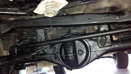

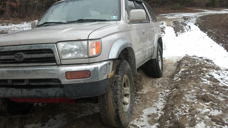

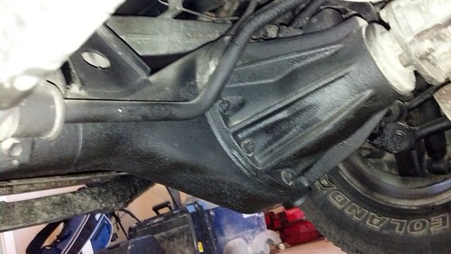

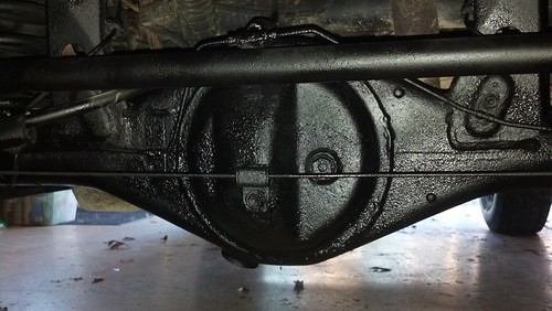

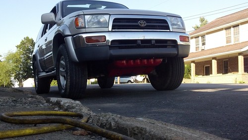

right around this same time last fall i attacked the under carriage of my t4r. i spent a lot of time underneath it wire a grinder with my wire wheel, a steel brush and some rust-oleum cans. i didnt have any major rust issues at all, especially for the salt filled winters it has seen, but i wanted to clean up and eliminate any surface rust there was down there. i plan on doing this to some degree each fall. i dont have a lot of pictures, as it was a lot of work and its hard to get pictures under there. but i wire wheeled and brushed off any rust i could get to, and spryed with r-o self etching primer, and the rubberized undercoat they make. started in the back and made it the whole way forward.
keep in mind these pictures the paint is still wet, and it is the rubberized unbdercoat, so it does have a texture to it, any metal was smooth before priming and painting.
2012-10-12_18-27-42_515 by zgensler31, on Flickr
2012-10-12_18-27-52_215 by zgensler31, on Flickr
2012-10-12_18-28-15_770 by zgensler31, on Flickr

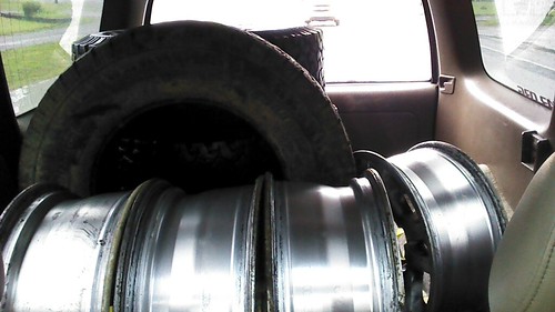

An ad popped up in one of my save searches on craiglsit, for some bfg tires and wheels. turned out to be for three BFG AT KOs and one RUGGED TRAIL TA, all on 4 Tundra 17" wheels, all for $300! the guy got them from another tundra owner that plowed with them so the wheels were of course in real rough shape. paint flaking off, corrosion..all visible from the photos, he planned on painting them black but underestimated how much work it would take, so is getting out from them. fortunately enough, i have some connections, and these wheels were scaring me off..
my brother and i go up to meet the guy that night, we get there and were looking at the wheels. theyre in pretty rough shape, paint flaking off all over them, some corrosion in the bare spots, minor pitting, only one center cap...
so i offered the guy $250. he thought about it and said how bout $300 and you take those four other tires there too. i take a look at them. its 4 more bfg rugged trail ta tires. all about 1/4 inch or more of evenly worn tread. one had some dry rot but seemed very usable still.
so i took them.

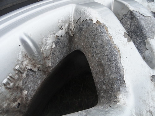

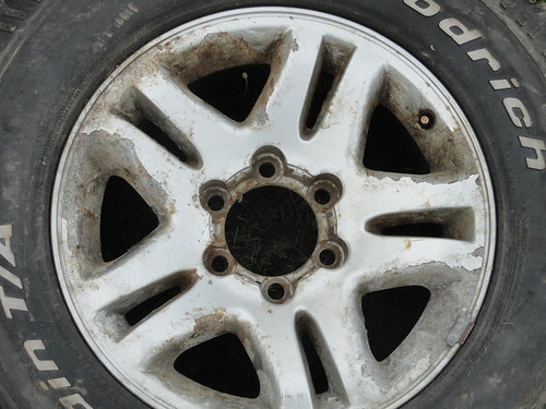

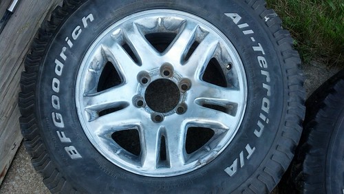

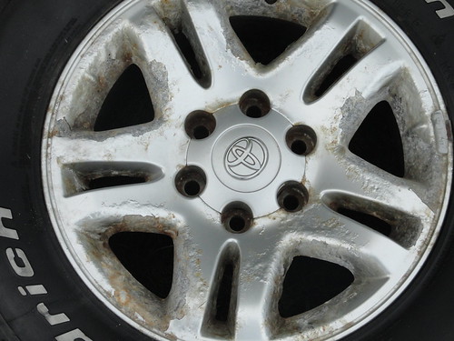

so in recap, i got 4 corroded 17" tundra wheels. 3 265'7-'17 BFG AT KOs at about 1/2-3/4 tread. and 5 BFG Rugged trail of about half tread. and one center cap...
i was loving the deal...
heres the tires and wheels when i got them home...
DSC02715 by zgensler31, on Flickr
DSC02717 by zgensler31, on Flickr
DSC02722 by zgensler31, on Flickr
DSC02719 by zgensler31, on Flickr
DSC02720 by zgensler31, on Flickr

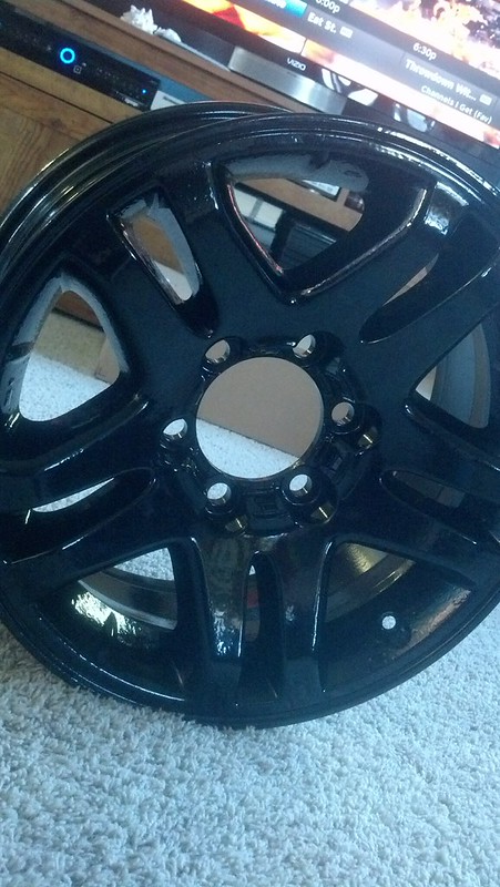

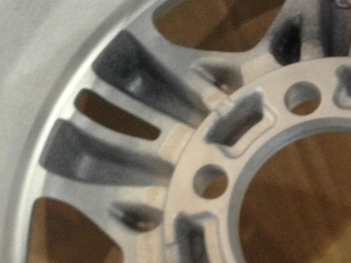

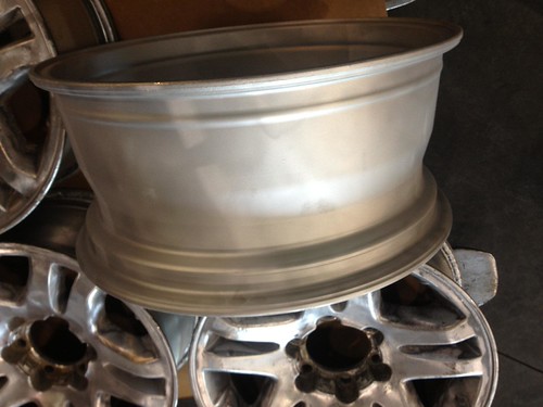

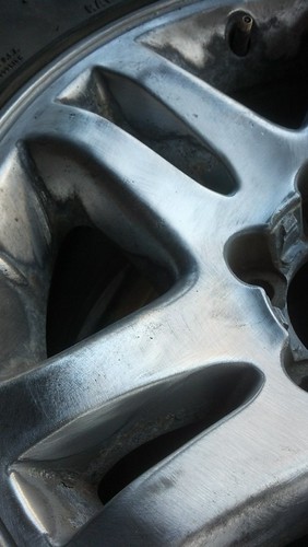

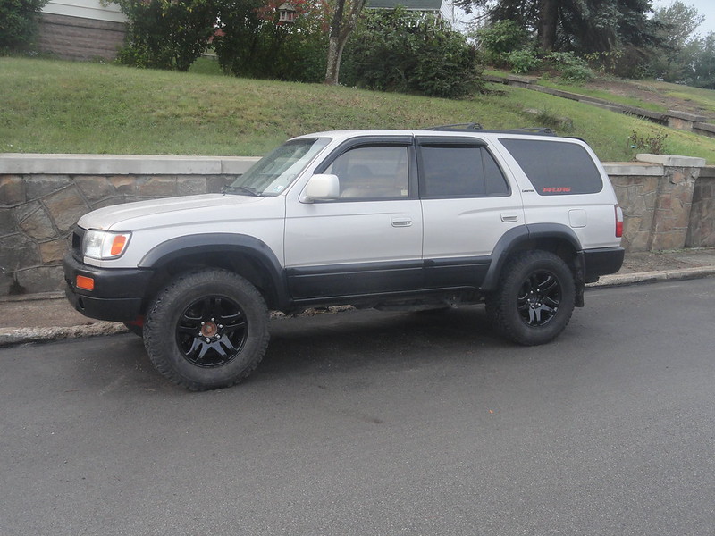

so i get them home and go to town on them.

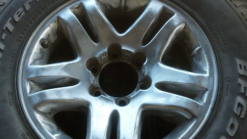

i picked up a 3M brand paint stripper wheel, its basically a plasticy steel wool thing on a drill bit. it was like 8 bucks used two of them to do all four wheels. and it worked awesome.
got them down to this...
Untitled by zgensler31, on Flickr
had them dismounted...

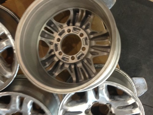

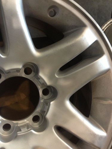

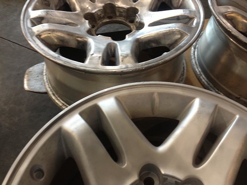

and now my brother has them at work(conveniently enough, he works in a metal fab/welding/machine shop making diesel motor parts for ge locomotives) to glass bead blast them...pics to come...
so my brother sent me a couple messages after work today...:whoo:
1. hes working on the wheels and sent me some pics... and 2. he got the boss man to powder coat them black once he is finished for a pretty good price....a case of beer..:wow:
heres the pics of where theyre at...
this last one shows where they were when he got them(back) and how they are when hes done with them(front)

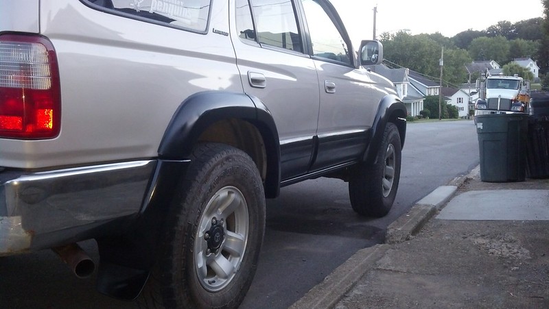

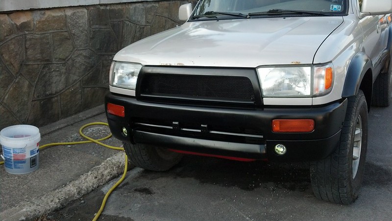

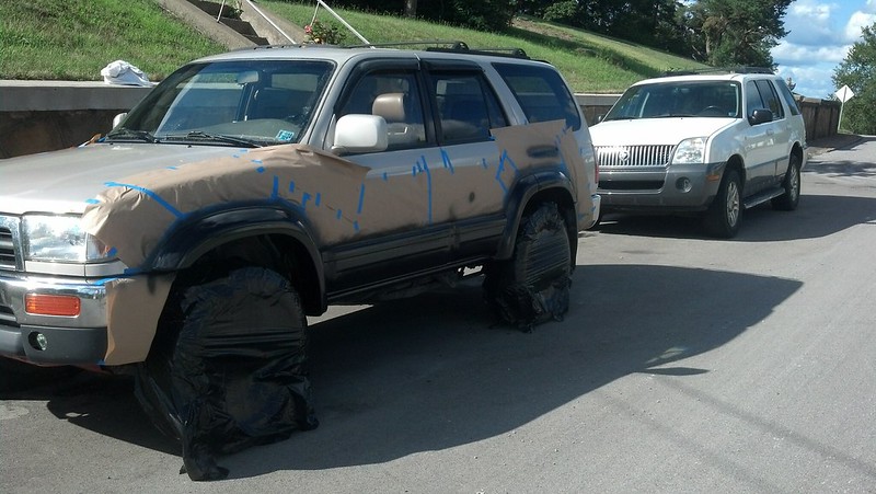

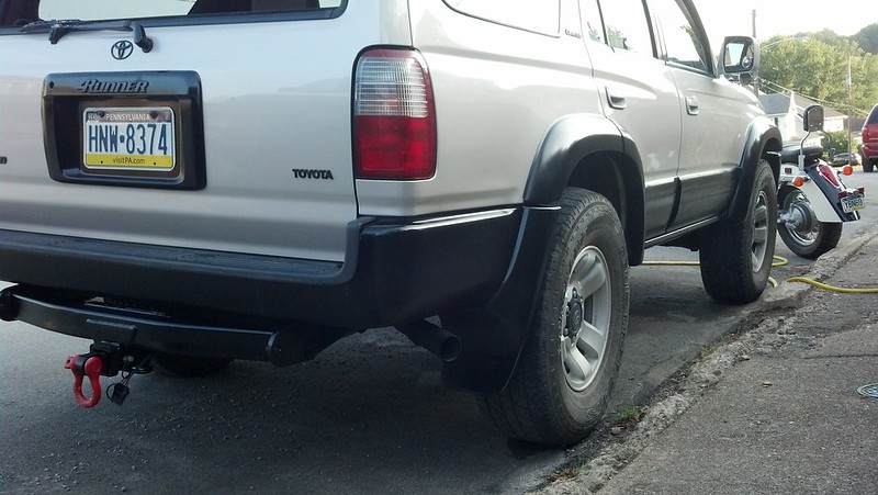

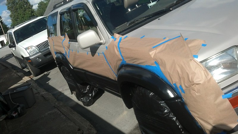

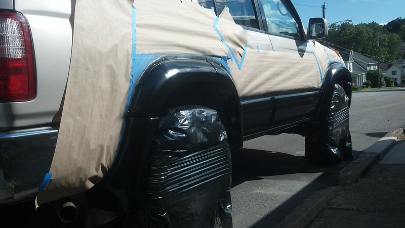

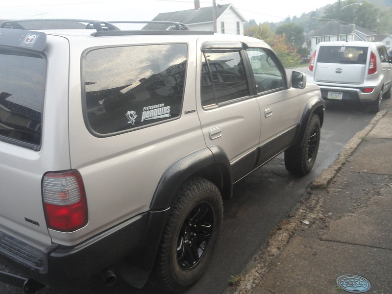

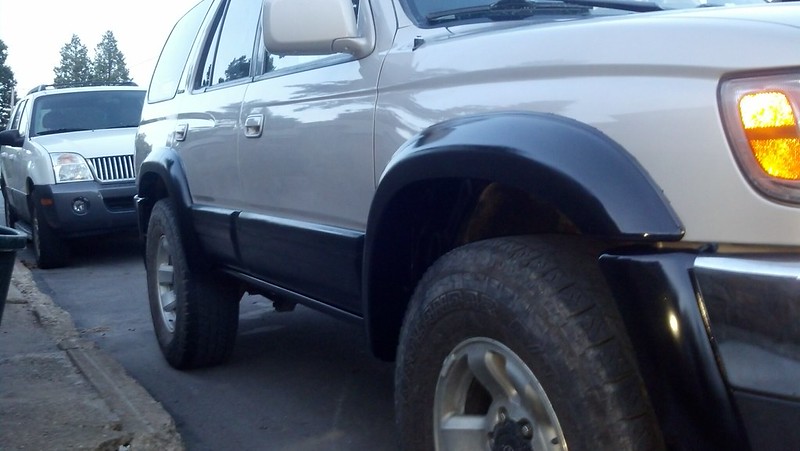

I went ahead and painted the flares today. Gloss black. I sanded with 100, taped it all off, and wiped them down with acetone. Then sprayed 6 maybe 7 light coats with rust-o-leum automotive enamel for plastics. Followed instructions on the can and let it all dry. Peeled the tape off and im a happy camper.
I will be painting the bumpers soon to match. Along with a grill mod. Wheels are at thepaint shop. Hpping to have them this week. Cant wait til its all together.

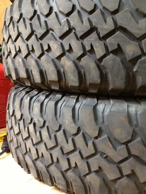

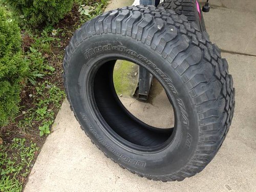

Tire wise ive got the three c load bfg ats on the front porch. Along with an e load range rugged trail. Slight cupping but good tread. Pics can be seen above.

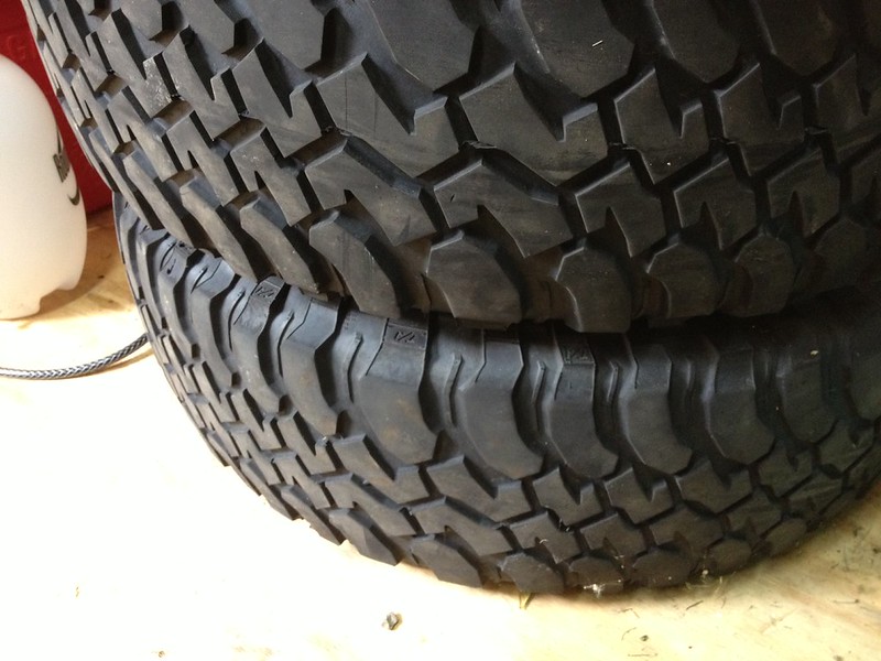

I came across a craigslist deal. 4 bfg mud terrains off a rubicon. So 255-75-17. All evenly worn. 2 with little more treadthen the others. $100.
Thinking of picking these up and running them until I can find another used bfg at?
Ive also considered picking up one or two tread wright at clones in c load to run with the ones that I have?
Are the km1's worth it? What would you do? Your $.02 is needed. Im kinda lost and ive smelled alot of spray paint fumes today.
I'd probably run the KM1's for the time being till you can afford a new set or run into a better deal. Those should last 10-15k at least and look to be in good shape.

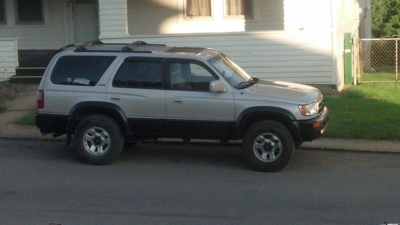

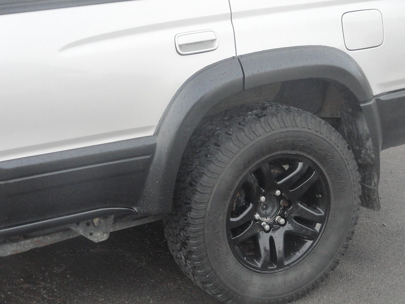

Alright so ive made some prettybig updates in the last month, just havent had time to update the thread. So bere it goes.
First off I painted my flares and bumpers gloss black.just gonna copy and paste this post from another thread to save some time...
[MENTION=78000]zgensler31[/MENTION] post some pictures here
In progress...

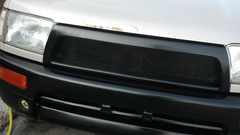

Once I got the bumpers and satoshi type grill mode completed...badge to come soon

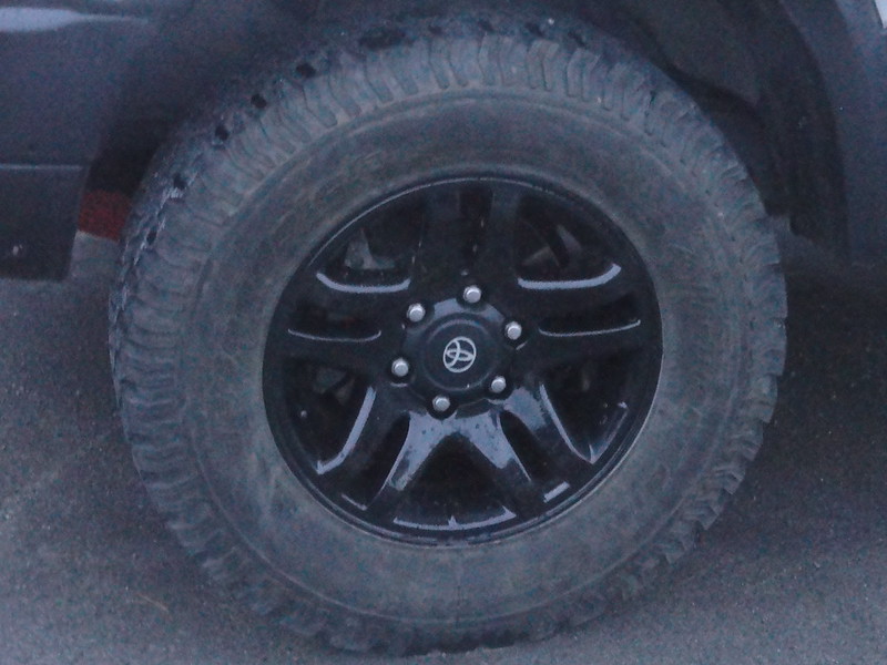

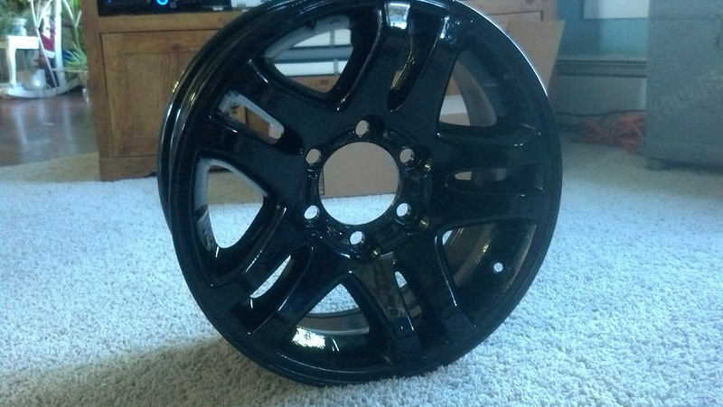

And my wheels.. not perfect by any means, but they got powdered for free and I got them practically free. Should be mounted friday.

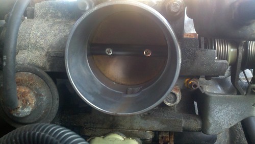

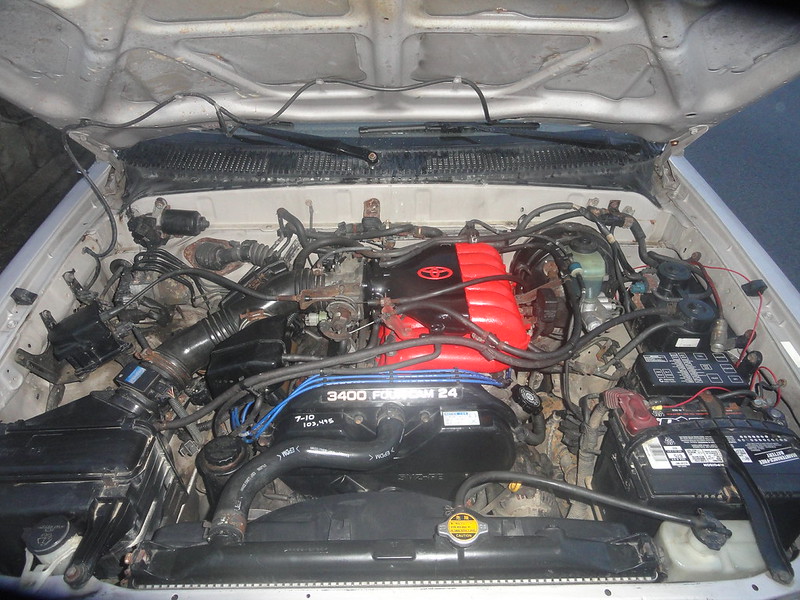

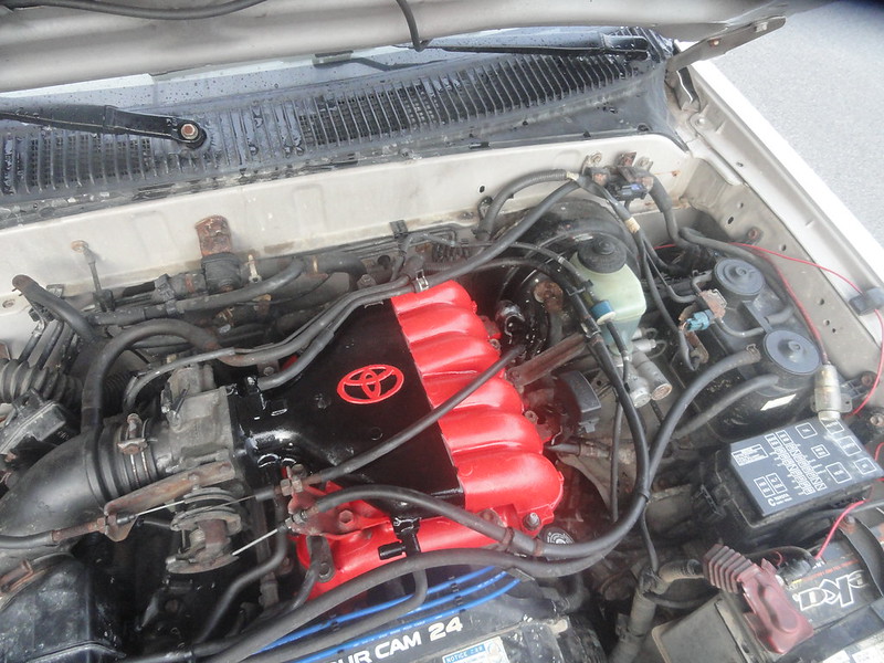

Then in the mean time, I got a cel, P0302.
i got new ngk plugs and wires...no fix.
Moved the coil packs around...didnt follow.
Got a used oem fuel injector on ebay for $20
Installed it...was running good, then I saw the puddle of gas on the ground.
The other two injectors that I pulled began leaking. So new seals and o rings...all good.

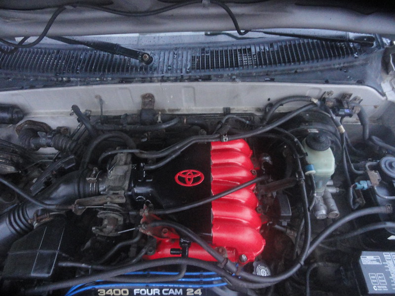

So far so good. And while I had it all apart I painted the intake plenum with vht engine enamel and baked them in the oven. Also got new felpro gaskets for them as mine were trash.
Whenever i get around to doing the valve cover gaskets I plan on painting the covers the same red also.
