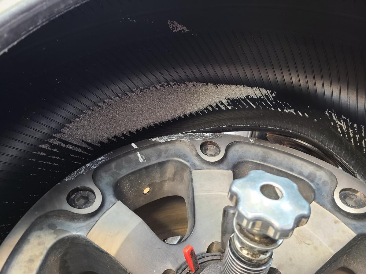

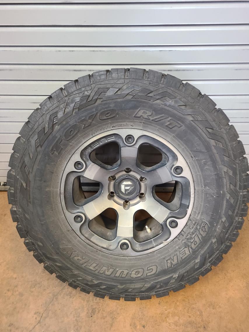

Dusting off the old build thread for a minor update. Finally got off my lazy ass and balanced all 5 of my tires after having almost 30k on them with the balance beads the original company I ordered them from threw in.
Long story short, had to unmount the tires, clean the balance beads out, then remount them and road force and force match them to the rims. It seems like the company I ordered them from (I had bought these already mounted on the wheels with new TPMS sensors installed) actually seemed to match the tires to the wheels before throwing in the beads. I only had to rotate one tire on the rim to bring the road force variation below 18lbs (that one was in the yellow at 31lbs and was probably the tire that hit the log a while back), but after rotating it on the rim once or twice it came down to 16lbs. In any case, they all balanced rather well and only one wheel used more than 5-6oz or less; given how much of a nightmare I have with some of our aftermarket chonky tires and wheels we put on customer's vehicles I'm calling that a win!
As for my opinions on running balance beads? I would say that as long as you're fine living with the quirks that come with using balance beads, they work very well. I decided to swap out to traditional sticky weights because I hit corners a bit hard and when getting on freeways (particularly from work where it's just a right turn onto the 97 with no on-ramp) they will be unbalanced for a bit as the beads will slosh to one side and it takes them a bit to even out. That quirk was getting more and more noticeable as the tires wore in, the last month or two has been almost like baby death wobbly for a about 5-6 miles after getting on the freeway before they start to adjust themselves. I could have thrown in another pouch of beads and I'm sure it'd be fine, but honestly that quirk always bothered me from the very beginning and I put off balancing them properly for a long long time.
Now I just need to decide if I want to change out the tires next year or not... they still have decent tread but they're getting up there in age, I think they're close to 7yrs old now and you can see some very minor dry rot starting...

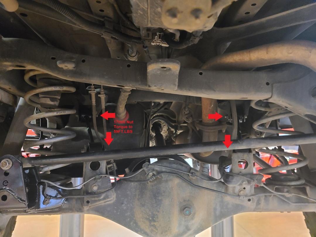

Installed a new Panhard Correction Kit bracket from eimkeith.com – good stuff for your Toyota., rather happy with the result... even if my weld looks less than appealing...
Anyways, decided to just do a separate thread for you guys so here's the link:
https://www.toyota-4runner.org/4th-gen-t4rs/305346-panhard-correction-kit-upgrade.html#post3735070

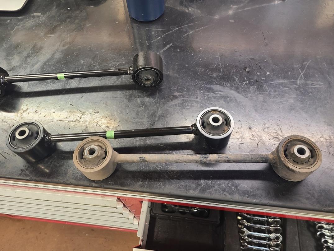

Didn't do too much today, just swapped out the old/worn upper links for the rear axle. The tech said that the old ones were worn out, but I think that hack doesn't know what he's talking about; plenty of rubber in them bushings! Damn stealerships!
