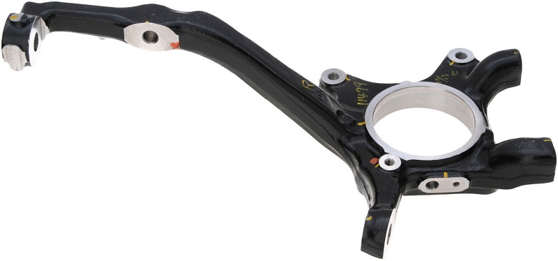

Maybe a good time to do the spindle gusset.
Those things look almost flimsy. I bet you straightened that sucker out.
Was thinking I could do a cardboard tracing/location of my SPC UCA to check against yours if you think that would help tell if anything is twisted.

I'm thinking about gusseting them, these gussets seem to be about $63 on Total Chaos's website; they don't specify is it's a pair though. The issue is going to be if I can weld then on while they are installed because I don't want to take apart the other side Also if I can get time to weld them on.
