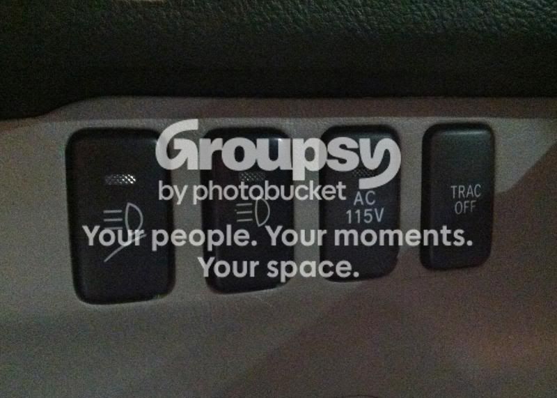

I am not sure what the differences are between the VSC button and the Trac Off button, but this is what i have. With the TRAC OFF button i can hit i and spin the tires, but as soon as you let off even a little it kicks in.
So you have to press and hold the button while spinning tires? If you let go while spinning the tires, does traction kick back in?
