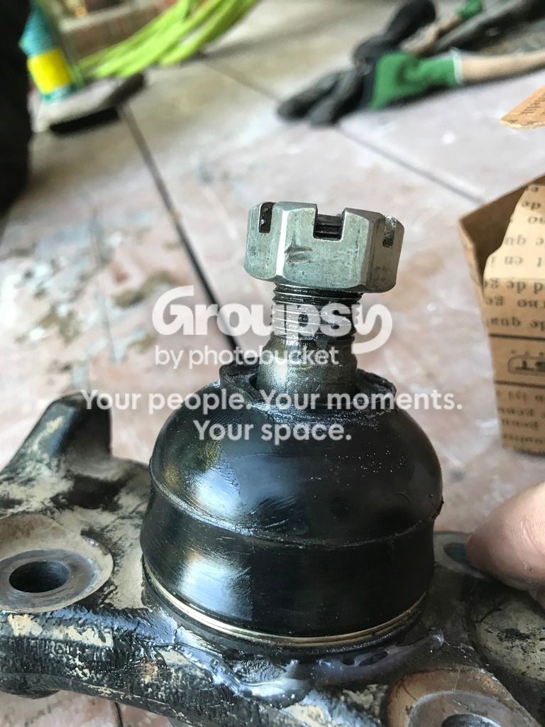

So, I am pretty sure that Toyota does not sell a reboot kit for our "lower ball joints". But there is a reboot kit for Land Cruiser. And if you really wanted to. You could probably get that kit from Toyota. Although I am not 100% positive. I've searched for 3rd gen specific reboot and I found nothing. Anyone is more then welcomed to correct me if I am wrong. So when I was doing work to my front end. I destroyed my barley used OEM LBJ boot and the grease. The grease was "white". I did not want to just throw the LBJ out. So I simply just ordered a Land Cruiser reboot kit. Came with boot, the snap ring and white grease. And it is exactly the same size as ours. So with a fresh boot and grease this will be my spare LBJ. In case I break it on a trail. But if anyone is interested in just rebooting their LBJ with fresh boot and grease, then this will work.

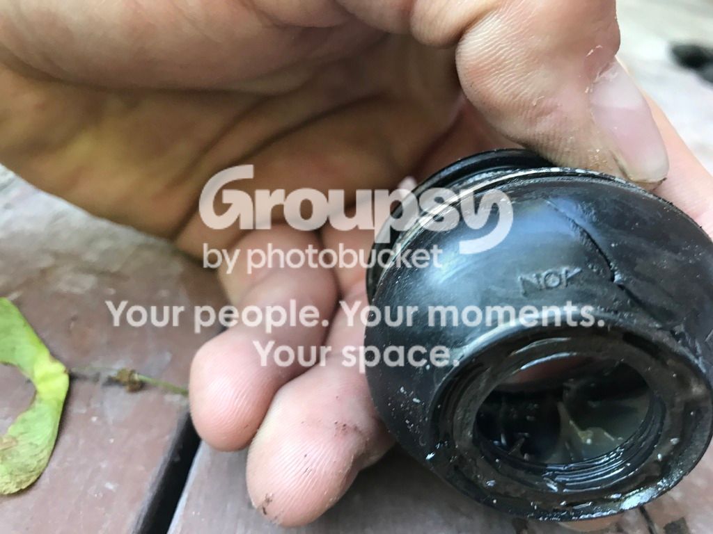

This is the original boot. NOK

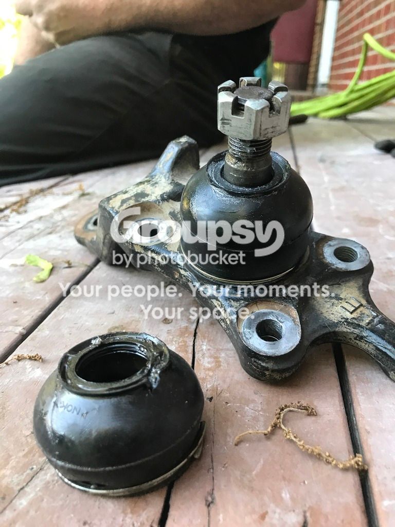

The Land Cruiser boot on the 3rd gen LBJ. Like a glove. Old boot on the table.

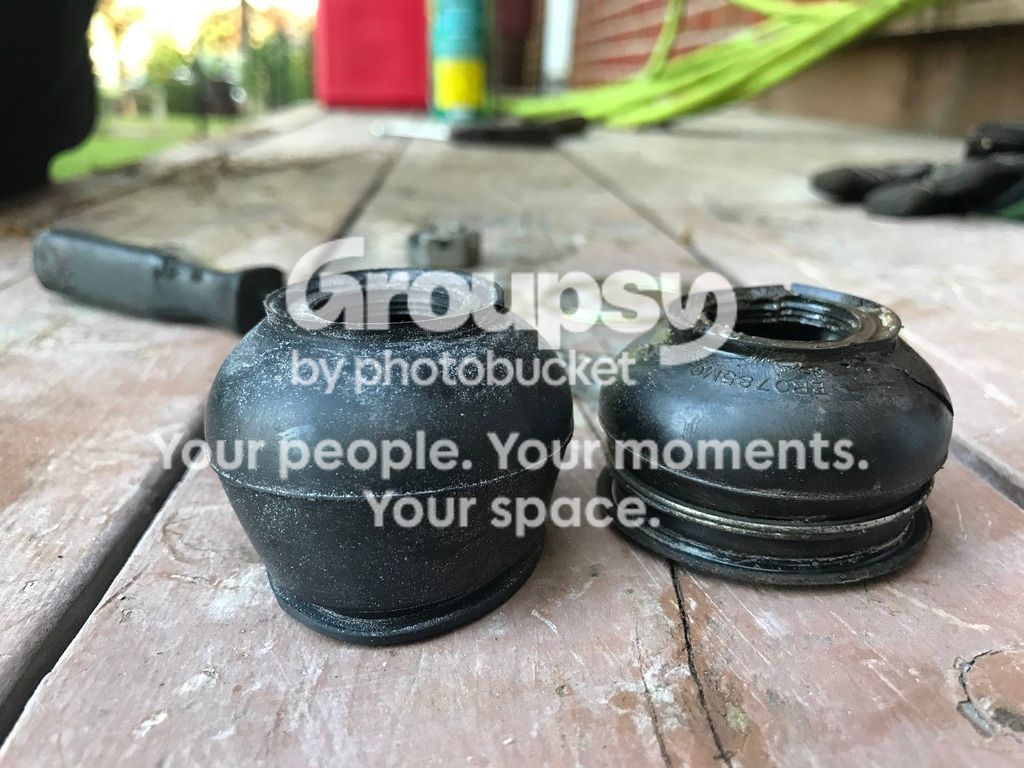

Left = Land Cruiser boot. ( little deformed from being in the box, but the round part is same size as our OEM. )
Right = 3rd gen boot.

Background: the OEM LBJs are not meant to be serviced and if compromised, should be replaced. However, mine had less than 2000 miles and I unfortunately nicked the boot during the tundra brake upgrade. The grease that came out was white and clean. I did not drive the truck since this happened so my LBJ was basically new and I did not want to just toss it. I bought the same boot as the OP and replaced just the boot.

The bad: although the diameters of the boot seem to be the same, the profiles are not. the replacement boot that is intended to be used for land cruisers is much taller. I had to pump considerably more grease to get it to bulge. When installed the boot makes pretty significant contact with the lower control arm and i fear that the rubbing will lead to premature boot failure.
In short: i don't recommend using this style boot -- it's way too large for our LBJs. I'm going to see if I can find a cheap aftermarket LBJ or used OEM and pull just the boot from them to insure proper fit. At the time of posting, an OEM LBJ is $100...
