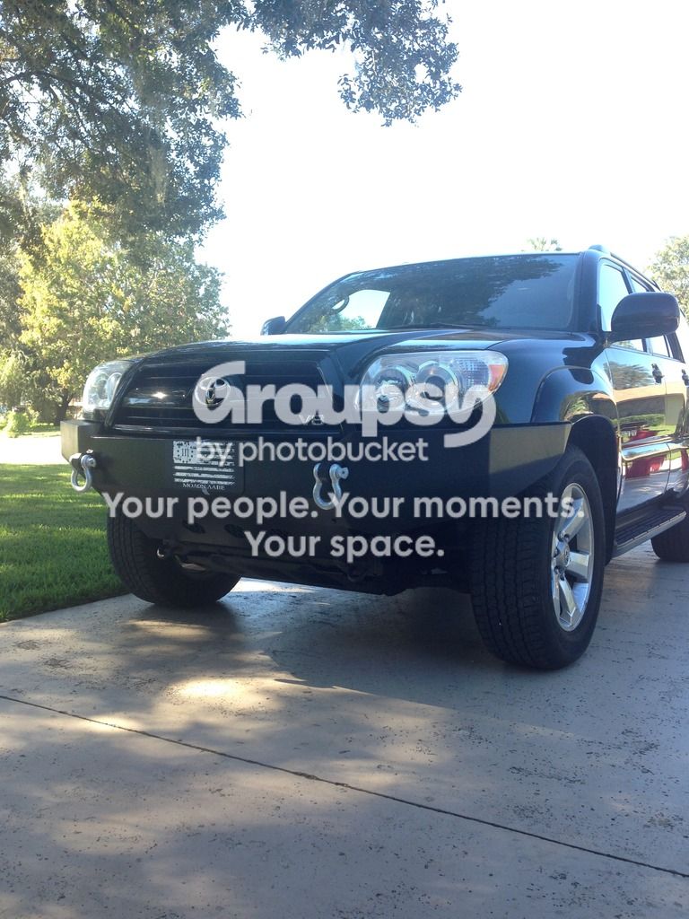

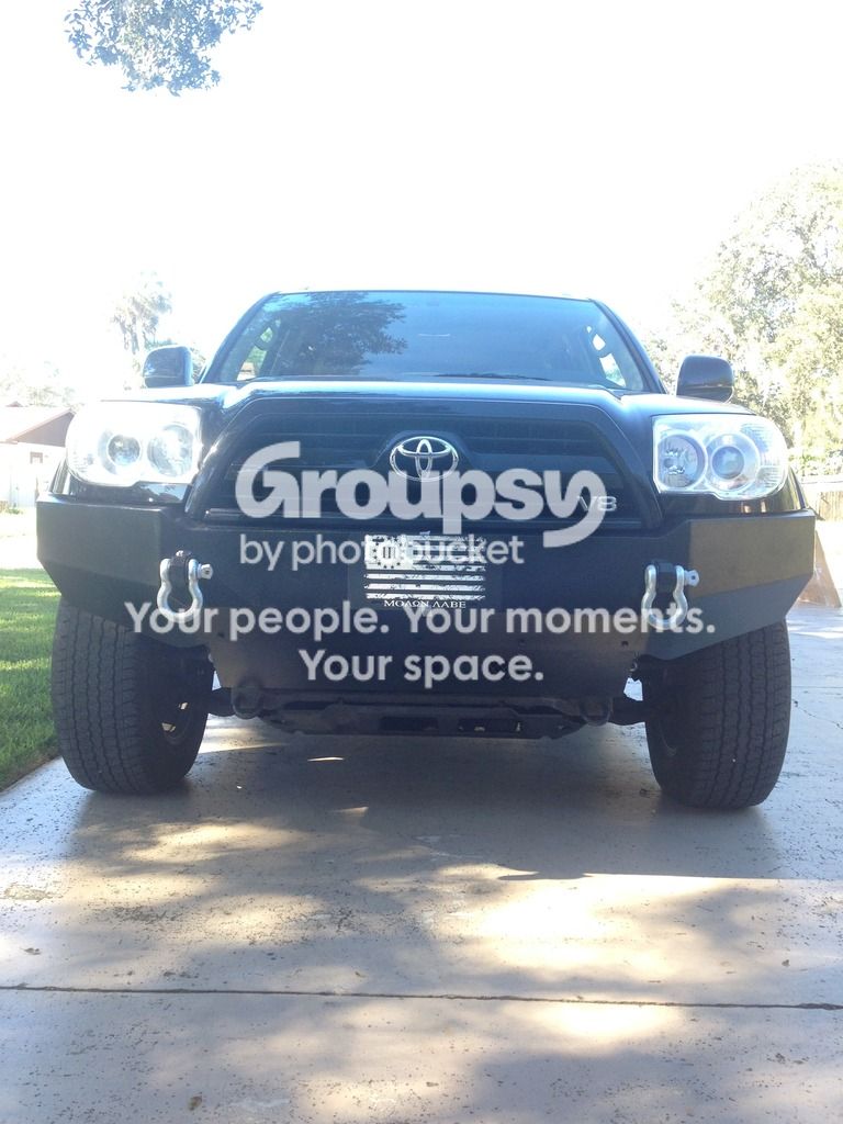

EDIT: I uploaded the finished product pics into this first post.

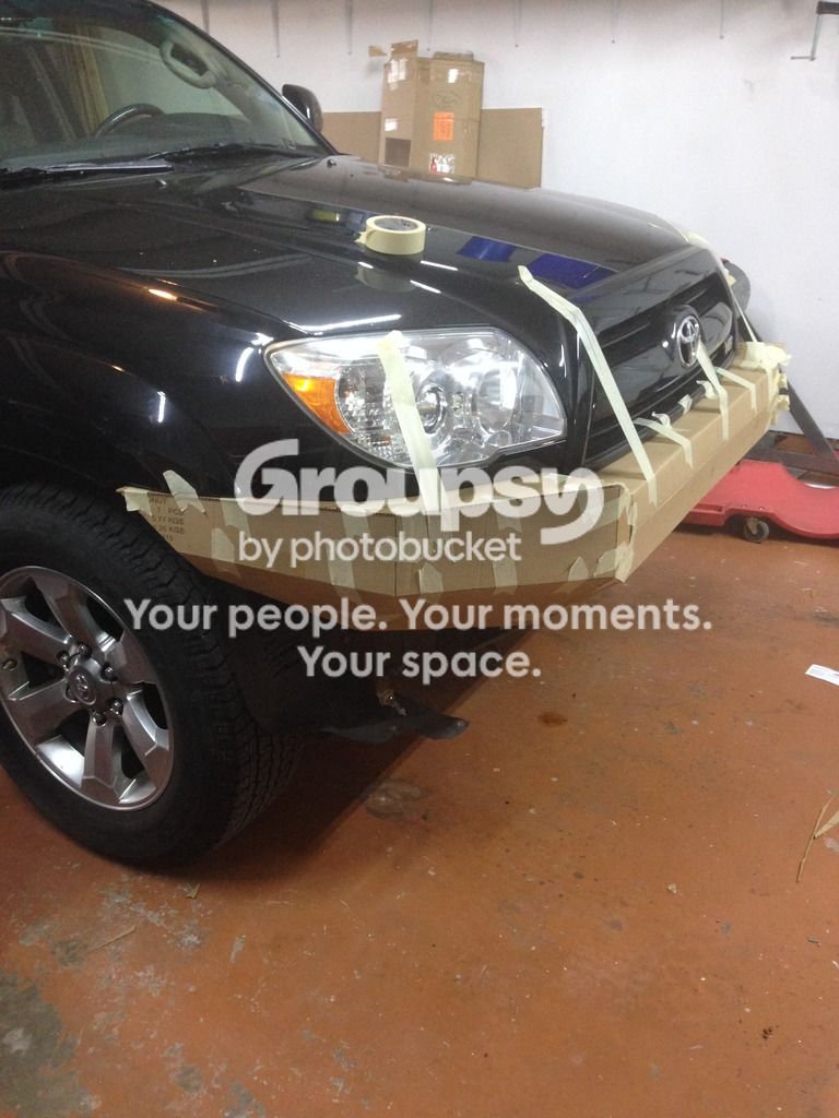

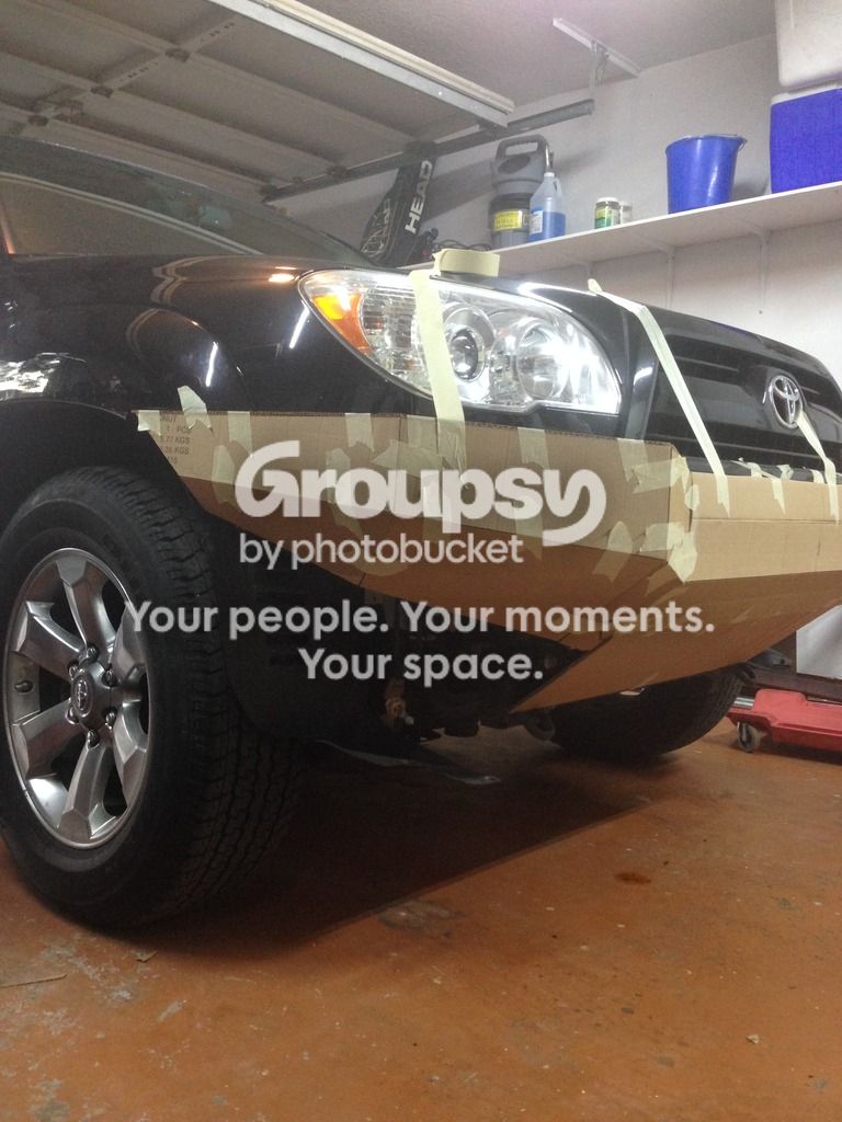

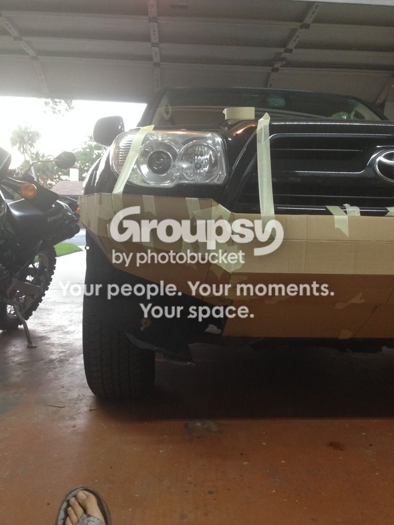

Decided to build a bumper. So far I’ve done a mock up out of cardboard.
It will be out of 1/8” because:
a) I already have that size on hand;
b) it’s more for looks, I don’t off-road that often;
c) slightly lighter
d) I’ll use several gussets
I’ll drill holes in the skid plate for air flow. I may throw a light bar in the canter and a single hoop on the top.
What do you think of the mock-up? I like the look but anything I should change structurally?
What's your plan to create it? Are you going to 3D model it, cut it on a plasma table, and weld it? It looks like a good functional design, just make sure your mounting points/tabs are strong.
I wish I had access to that stuff. I plan on hand cutting with a plasma (on a wheel so I can make pretty straight cuts. And circles), then welding. I'm sure there will be lots of grinding and a good bit of trial and error in the mix too.
I'd be concerned about how that cardboard will handle a deer or a head on crash.

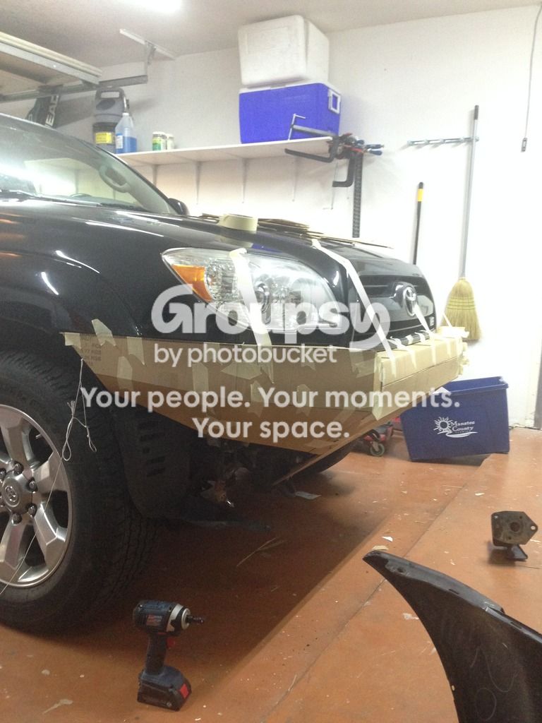

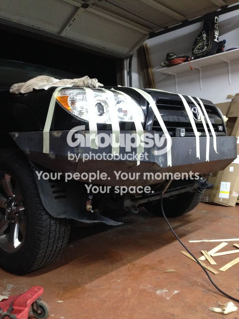

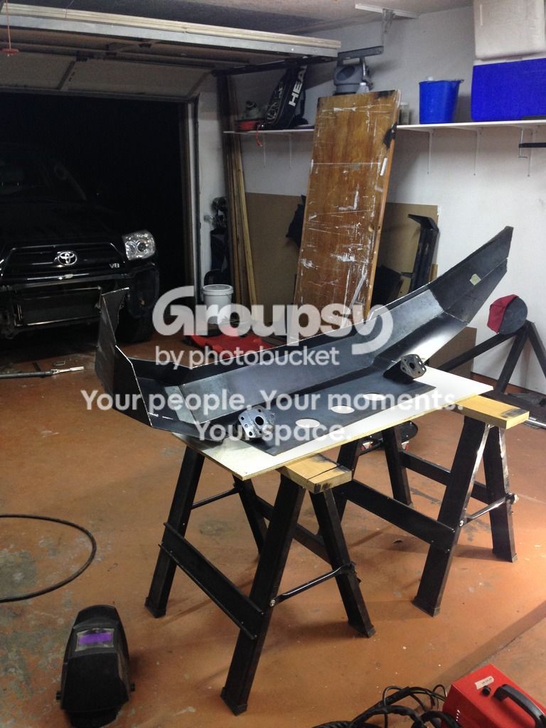

Made some progress this weekend. The fit is good. Still need to incorporate some gussets for strength. Used about 1/2 to 2/3 of a 4x8 sheet.
Looking good. Really starting to think I should take some welding classes. I'd much rather DIY than buy and the more I'm seeing around here the more it's pushing me towards learning to weld.
