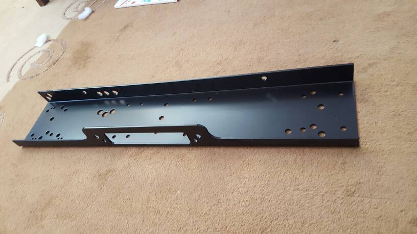

I've looked at these before, it sure beats $250 for other mounts. I think it's worth the effort.
I like the idea of having a pre-bent piece of 1/4" steel so I'll order one of these universal plates. I'll start a new thread with pics when the time comes.
Except for the price I like that one! Might be able to keep the flush lightbar mounted in the grille and winch down lower.
The Amazon unit seems robust so I'll have some options. Material thickness is a hair less than 1/4", not bad. I'm putting this on the back burner until the current slider fab project is complete.
