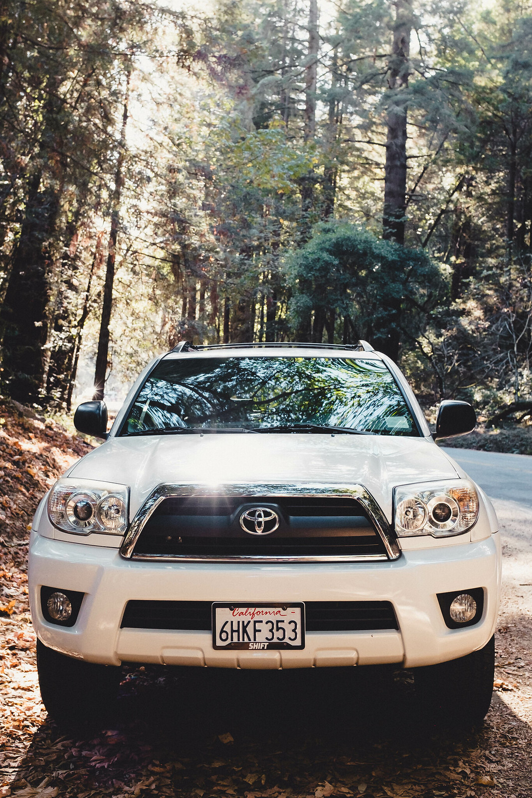

Hey everyone, after a long time debating what vehicle to get, and what aspects I cared about most, I finally pulled the trigger on an 07 SR5 4Runner. His name is Fred.
This is going to be a slow build, but I want one place where I can document the progress, and hopefully get some good feedback from you guys.
Here's Fred
SR5 4x4
V6
113,xxx miles

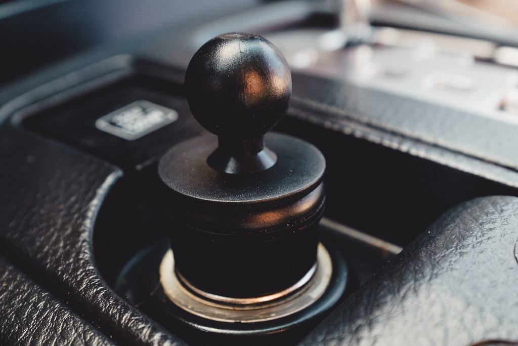

Well, I got the phone holder figured out.
[/url]DSCF7224 by colin belisle, on Flickr[/IMG]
I picked up a magnetic phone holder that was intended for a vent. I chose this one because of the adjustable ball head. I found an old cigarette lighter and pulled out the innards. Then took off the vent mount on the phone holder and applied a liberal amount of glue on the inside to attach the two. Here are the results.
[/url]DSCF7226 by colin belisle, on Flickr[/IMG]
[/url]DSCF7222 by colin belisle, on Flickr[/IMG]
DSCF7223 by colin belisle, on Flickr
[/url]DSCF7225 by colin belisle, on Flickr[/IMG]

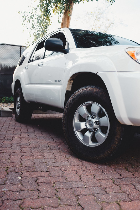

Since the last post, I got some wheel spacers installed, and it looks SO much better. Honestly, it looks stock, but in a good way. Like it was meant to be like that. No lift yet, but I don't have any rubbing, and as far as I can tell, it's only affected my gas mileage by .5 mpg. Also, I got some new speakers for all 4 doors. I went with Alpine Type-S components up front, and 3-ways in the rear. They sound great - much better than the stock paper speakers.

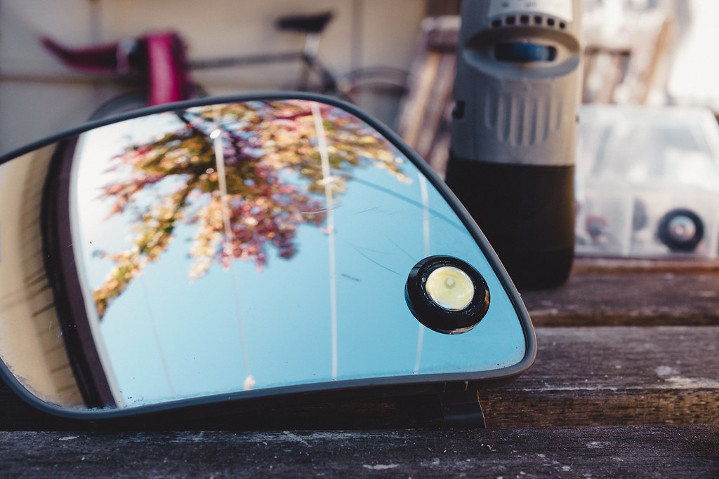

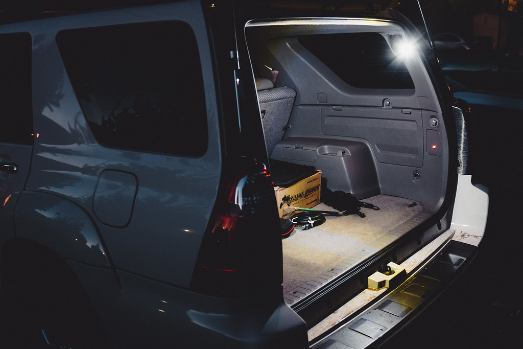

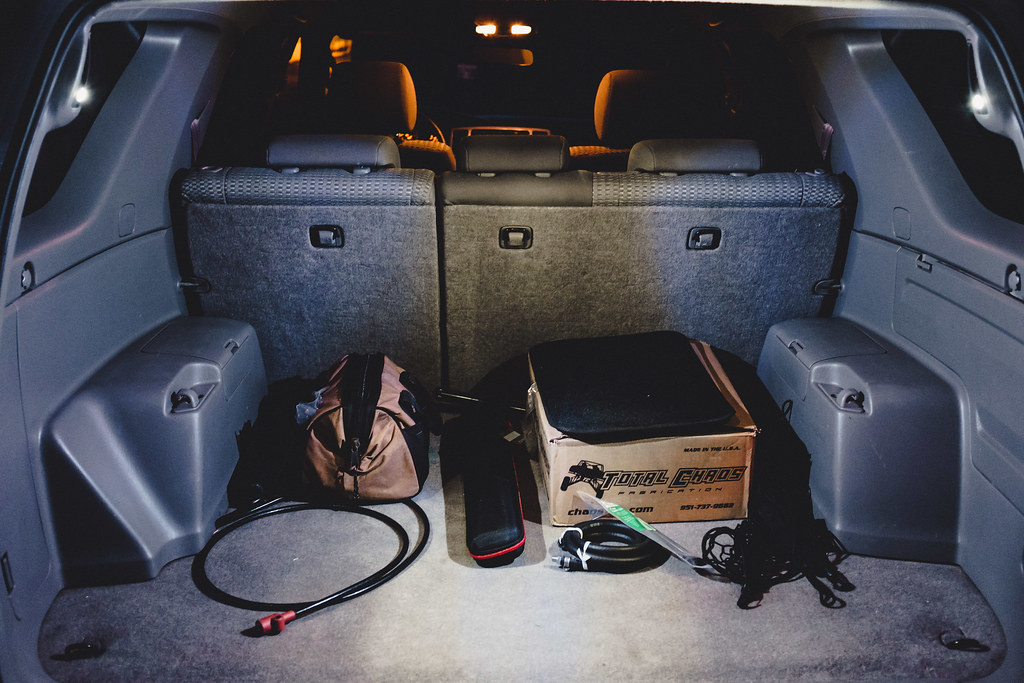

Today I also had a bit of time so I installed some lighting in the cargo area. I installed one small LED in each of the rear mirrors, and then a switch near the 12V outlet in the back. The full writeup can be found here.
It ended up costing $22 and taking a couple hours to get all the wiring done correctly and everything mounted nice and flush.
Also the total chaos box in the back isn't UCA. Some 5th gen rear springs are in there that my buddy gave me. When I get around to lifting/leveling the truck, they should give me a bit more stiffness while only providing 0-.5" of lift.

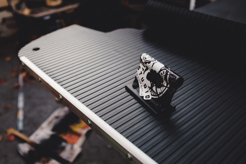

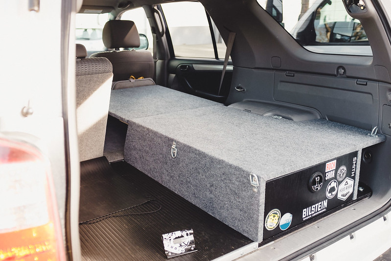

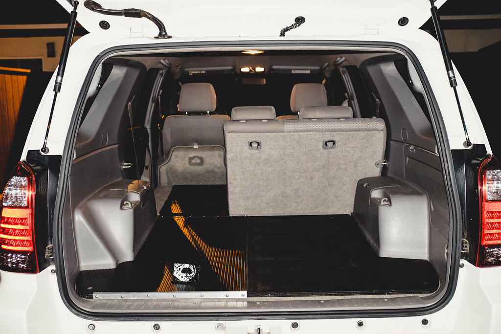

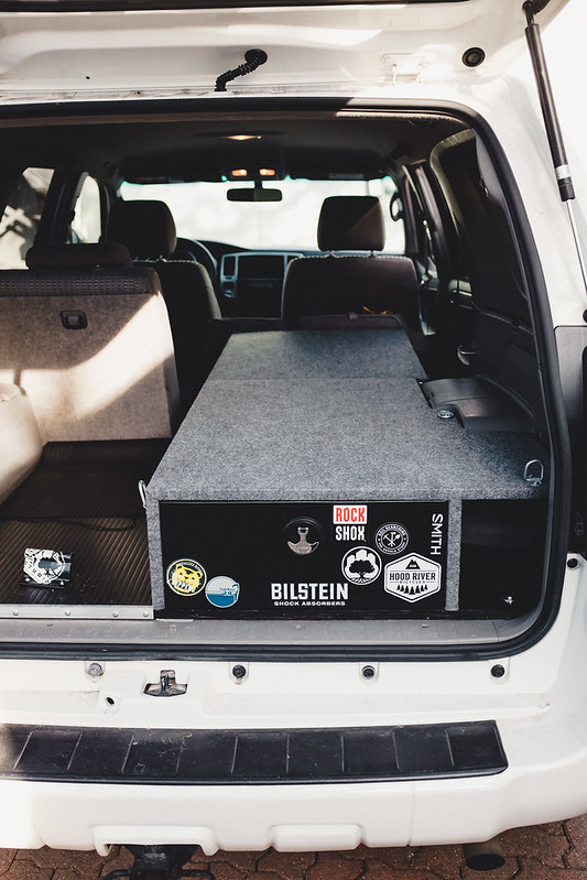

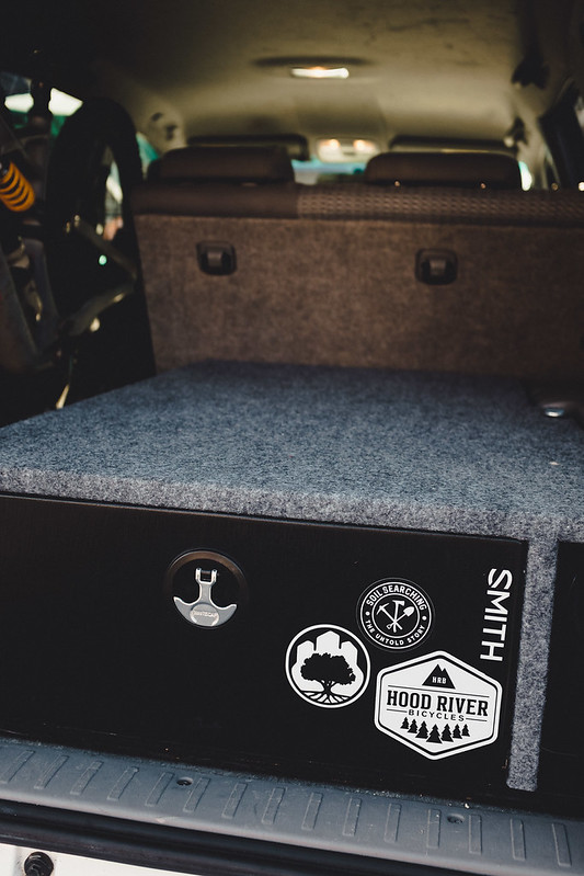

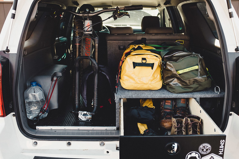

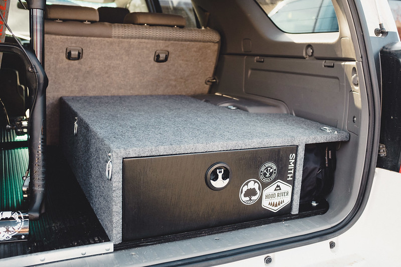

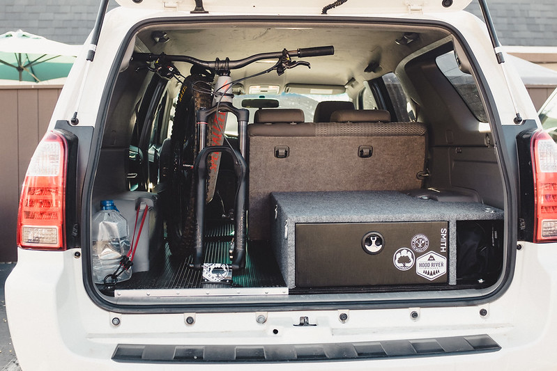

This past weekend I started on the cargo area. I have a few things in mind that I want the cargo area to do.
(1.) Carry a bike. I work at a Specialized which is a bicycle company, so hauling a bike inside the car is necessary for security reasons, and it's just nice to keep it out of the elements on long drives.

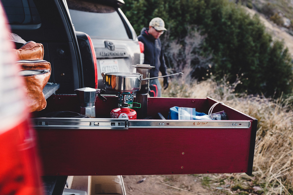

(2.) Storage. I want at decent sized drawer that can carry my day-to-day tools, bike stuff, and anything else. And then when I go camping, I want my stove, gas, and dry food to fit in the drawer.
(3.) Sleeping platform. I want this to convert into a sleeping platform that my wife and I can sleep on. It'll be tight, but the idea of sleeping in the car sounds awesome.
First step was to get a solid base for everything. I used cardboard to create a template for the base, and then transferred that to some 3/4" plywood. I then painted it black to keep it stealth looking, but also help seal it from moisture. I then did some test fits to see where the fork mount for the bike needed to go, and also drilled the mounting holes. Once that was all set, I got some rubber mat from Home Depot along with some 3M adhesive spray. The mat is mounted on the side where there won't be a drawer, and I left excess mat on the back so it'll roll out over the back seat where the rear tire will sit, in hopes that it'll keep the car cleaner. Lastly I added an aluminum edge protector on the front to keep the mat from delaminating, and to protect the plywood from abuse. I also added a thin piece of aluminum painted black on top of the mat at the back to keep it from delaminating as well.
I see this as part 1 of a 3 part process. Next will be making a drawer that'll sit on the right side where there isn't the mat. Still have to figure out the height I want it. The final part will be creating the sleeping platform. There'll need to be one removable piece to sit over the bike mount area, and then a second removable piece that'll sit over the back seats (which i may remove for camping trips).
Lots more to do, but i'm pretty happy with it so far.

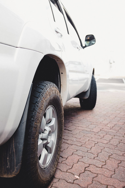

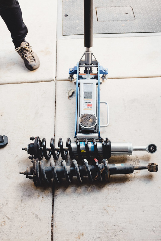

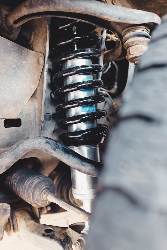

The lift! Finally got everything to do this and had the help of a couple friends. We knocked it out last weekend, and it only took 4 hours to do the whole truck! I did assemble the front struts beforehand, so it was all plun-n-play.
Fronts: Bilstein 6112's set at the lowest setting - 1.9"
Rear: Bilstein 5100's + 5th gen 4Runner springs + 10mm spacers on both sides
Before:
Front: 19" // 18 7/8"
Rear: 21" // 21"
After:
Front: 20 3/4" // 20 3/4"
Rear: 22" // 22"
DSCF7968 by colin belisle, on Flickr
DSCF7997 by colin belisle, on Flickr
DSCF8005 by colin belisle, on Flickr
DSCF7998 by colin belisle, on Flickr
Heading out to Big Sur this weekend, so we'll see how it plays out, and snag some photos too!

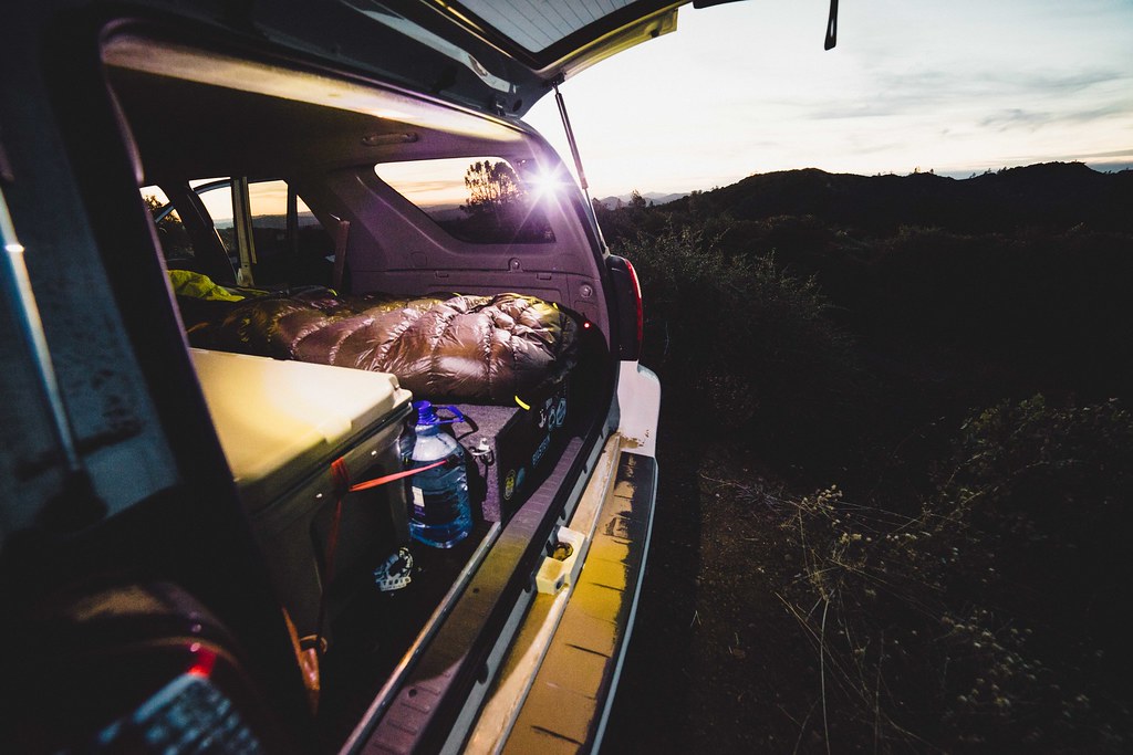

Also got my sleeping platform dialed in. Couple shots here, and more to come from this weekend.
DSCF8006 by colin belisle, on Flickr
DSCF8010 by colin belisle, on Flickr​

Finished up the cargo area. Stoked how it came out - now for the suspension!
Nice work on the cargo area. It's cool to see how different people customize the layout to meet their needs, and even more so to see one that is tailored to very specific needs... ie bike/sleep/storage.

Took Fred out for a weekend in Big Sur along with a couple buddies. Rad views, weather, and roads. New suspension was perfect, and the sleeping/cargo setup was dialed.
