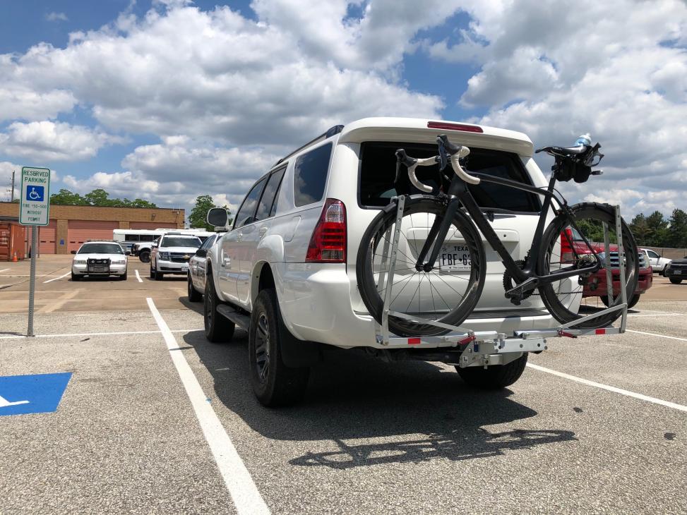

It looks like we have similar tastes. These are 3 of my favorite purchases - white 4th gen, 1up rack and a Specialized.
