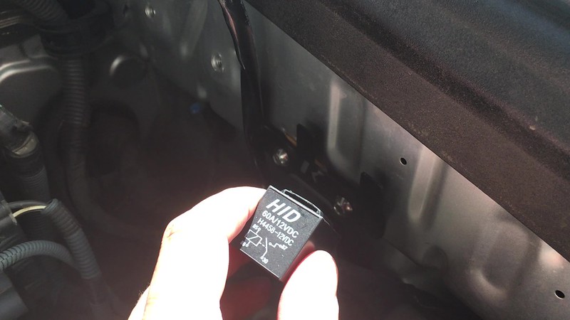

The battery is loose and shifted over to gain some extra room to slide a hand down there to route the harness.
The harness runs back to the relay mounted to the Rago relay holder (more on that in a minute)
This is the extra length I cut out of the harness going to the light bar.
Now, for the relay holder. Junk! If you watch their install video https://www.youtube.com/watch?time_continue=5&v=smD1jX9eJpg you need to use a knife/pick/small object to release the relay from the mounting tab. The Rago relay holder has nothing to keep the relay in place. It slides on and off with no resistance. You’re buying an extra bracket to make it less secure. Not cool, that's quite the design oversite in my opinion. Plus, as you'll see in the next picture if you try to cleanly route the B+ wiring around the fuse box it will not reach the battery using their harness and their relay holder. Rago did offer to go against their return policy and let me send it back for a refund but at this point I already tossed out the tab that comes with the relay to actually mount it securely. I put a dab of black RTV on it before sliding the relay over it to keep it secured.
Rago-013vid
I temporarily got it hooked up to verify function.

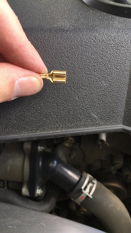

Next up was the switch side wiring of the harness. I wanted to make as small of a hole as possible in the firewall grommet so I used one of my terminal tools and removed the connector, this way I can tape the wires up to a zip tie and pull a relatively small mass through the grommet.
Stagger the wires a bit to keep the bulk down.
Size comparison of the harness connector to my way.
I poked the corner of razor blade into the harness boot and stretched the hole out with the harness to keep a nice tight seal.
I ran this harness along the factory harness again to keep it clean looking.
with that stuff in the cabin I put the terminals back into the connector so nothing would touch and went back under the hood. I wanted to get the under hood stuff finished because I was running low on time. So working on the power and ground setup the power wire was absolutely going to have to be extended for a clean install if you're running their harness and relay holder together so I started messing around with that. First thing I noticed is how bad the fuse holder it. I pulled the terminal because I needed to extend the wiring and I’d rather have room to work. This is how bad the fitment to the actual blade of the fuse is. I'm going to cut this thing out and use a proper one that has better contact and is actually sealed up for use in exterior applications. But for now, it went in as is.
