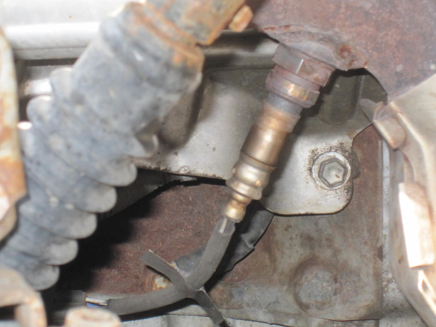

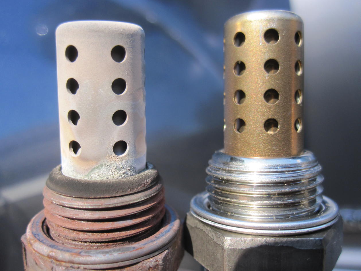

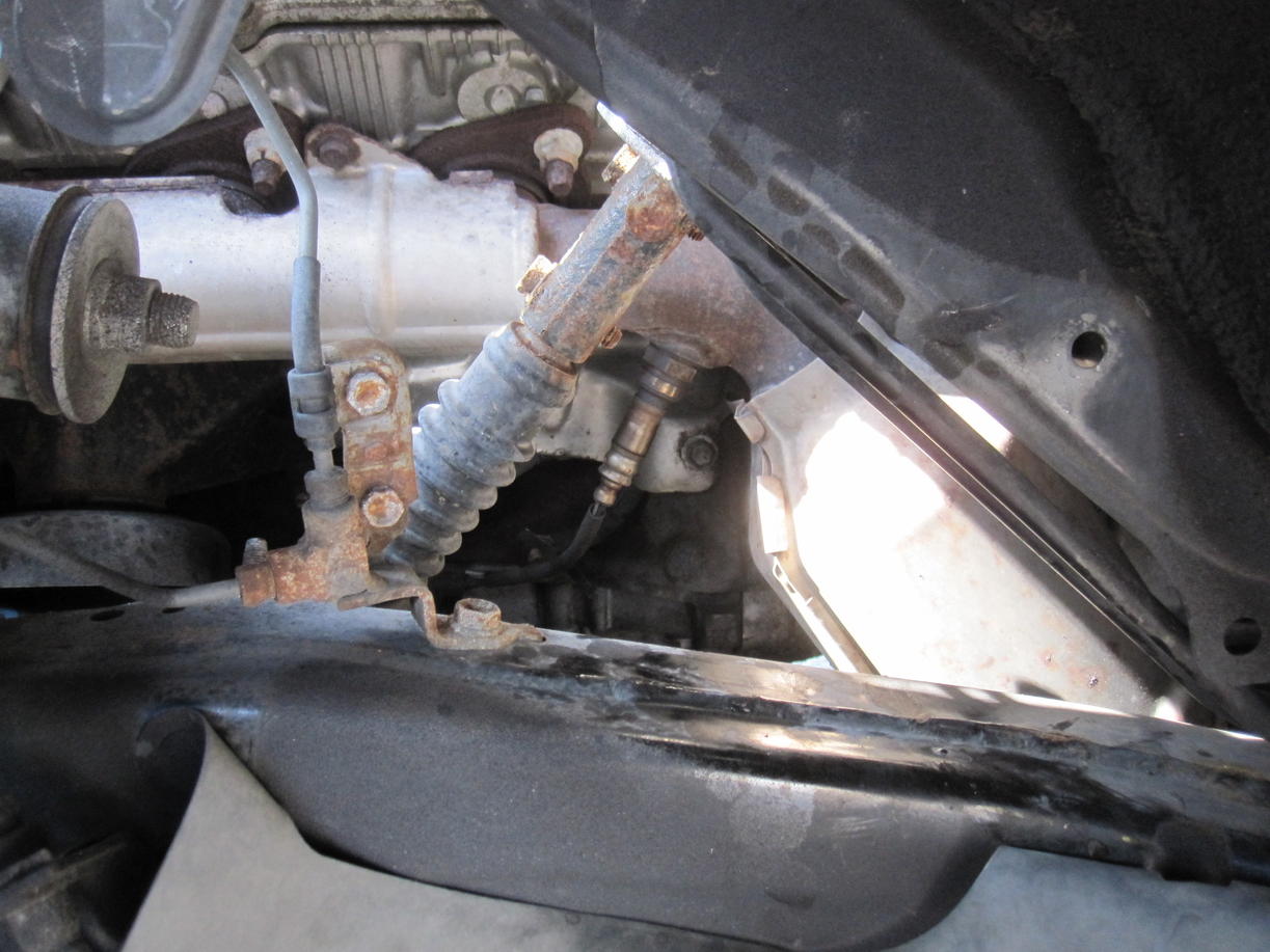

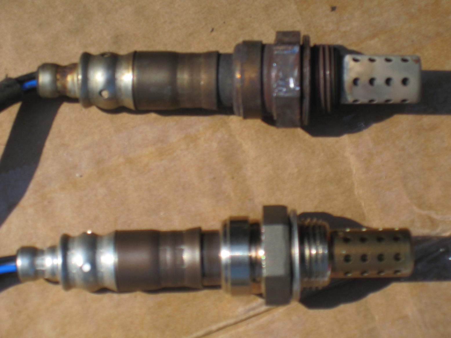

Here are a few pics of location and install of my O2 sensor on my 2004 V8 with 160K miles. This was the first one to go. Got the OEM Denso from Advance Auto for $98.00
I had to un-do the engine/flap/cover that protects the engine from mud/rain etc in order to access the sensor. Turned the tire so I could access it. Got a 22mm box socket wrench and with a few taps with a hammer-it turned pretty easy. I was worried that 160K miles of rust/debris would have sealed it in there, but with the engine hot....it was pretty easy to take out. Once out-I unhooked the opposite end that essentially is a cannon plug, it unsnapped from the socket and all was well. Install took approx 10 min once I had the correct tools. Went back to start it....the engine light and other VSC lights were on the dash and would not go out. Shut down the truck....un hooked the battery for 60 seconds, reconnected and restarted. All lights were out....SUCCESS!

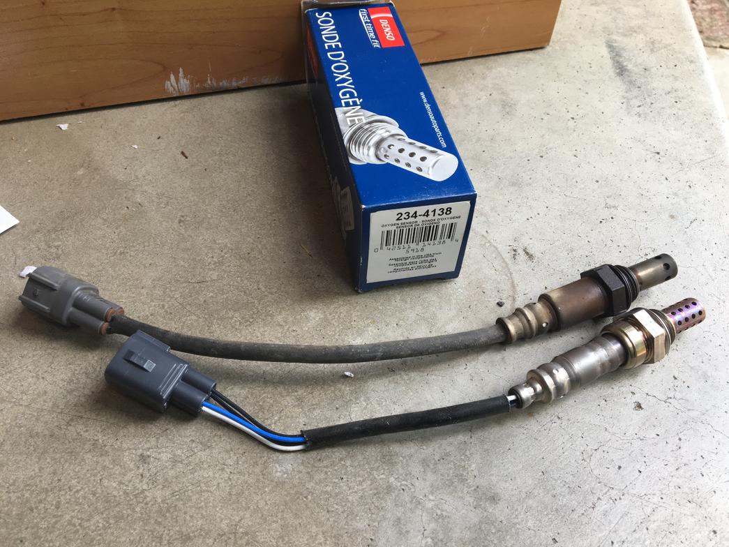

Bank 2 Sensor 1 (Upstream of Cat driver side)
I ordered this part (234-4138) off Amazon after checking both Amazon and Denso's website for correct part number. The part arrived and the wire was too short and the plug did not fit. I called the good old dealer and they said you need to order the part by VIN as there are several listed for the 2004 4Runner with the 4.7L engine. Shockingly, the dealer said the Toyota Part Number (8946560150) did not cross reference to a Denso part number even though Denso makes the part for Toyota. I called Napa for an NGK version and they said 5 to 6 days for $100. Ultimately, I bought it from the dealer since they could deliver the next day for $197!

That’s a good idea and I thought about cutting the wires and using the original plug with the new sensor which would give me the length I needed but wasn’t confident the sensor was the same. If it didn’t work I’d be back to buying from Toyota (or somewhere else) and I’d be out the Denso sensor $$. Sometimes the path of least resistance costs the most money, huh?

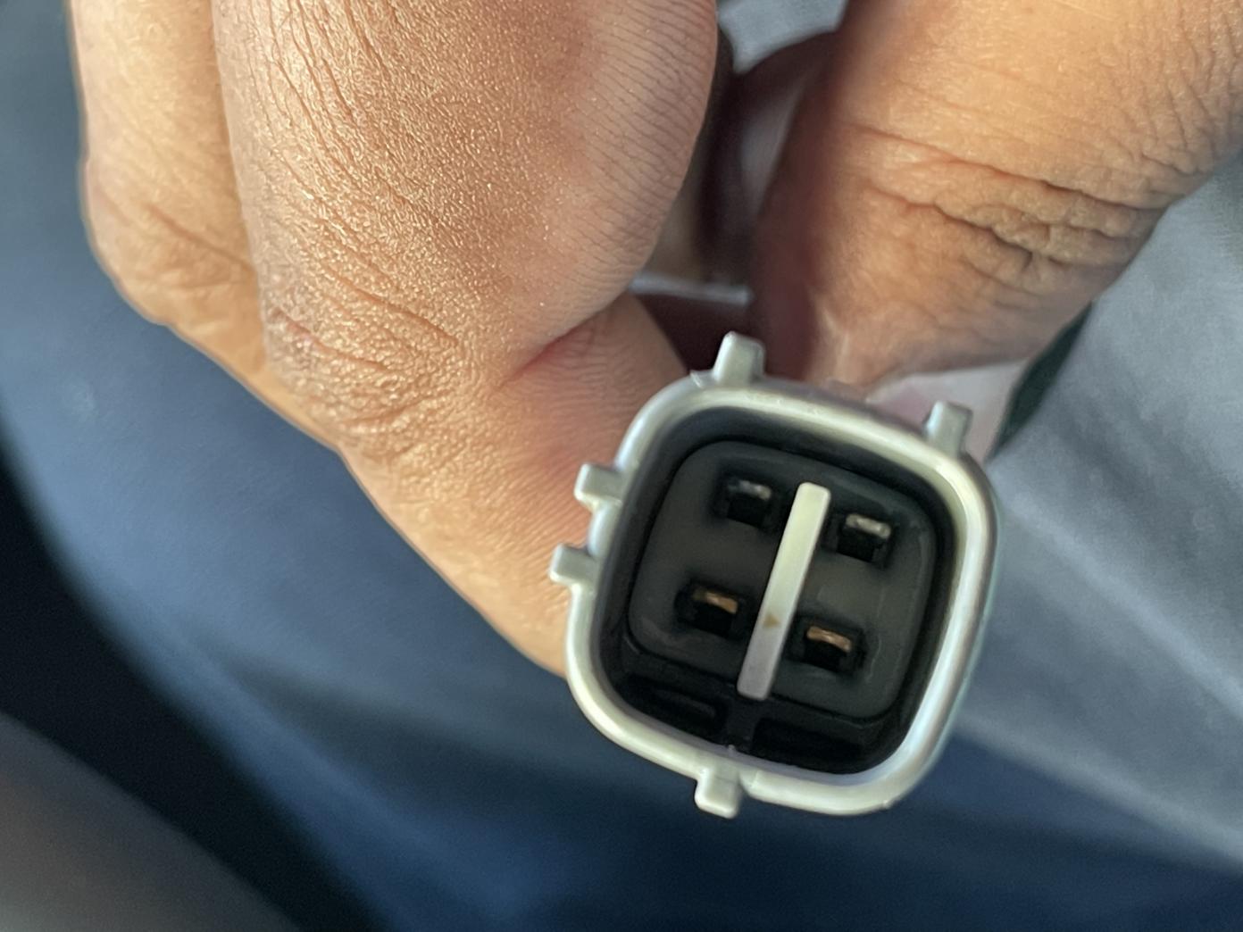

I looked up all those part numbers but none seem to match my sensor.
2003 4Runner v6 sr5 bank 1 sensor 1
Edit. Part Denso 234-9047 is correct according to plug layout and rock auto.

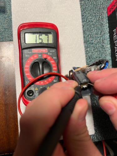

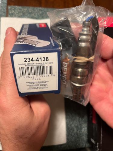

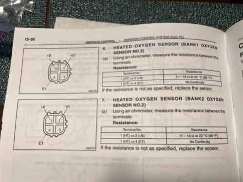

Hello all, I got kinda stuck with my Bank 1 Sensor 1 problem.
So, I got the P0031 error code check engine light with the other two lights.
Ordered the Denso sensor, replaced it, worked fine for about 15miles or so, then the lights came on again with the same error code.
Drove the car like that for a month or so (short distances, not more than 12-15 miles at a time), then finally I was able to get to it again.
Measured the impedance of the existing Denso sensor and I got 16.7ohms which is over the limit (should be between 11-16ohms per service manual).
Ordered a new Denso sensor and out of the box it shows 15.7 ohms. Within limits but just. I’m reluctant to install it as it could throw the error code again.
My question is: is there another way to make sure that the new part will function properly?
Got no info on what’s the voltage the sensor should receive.
Any ideas?
