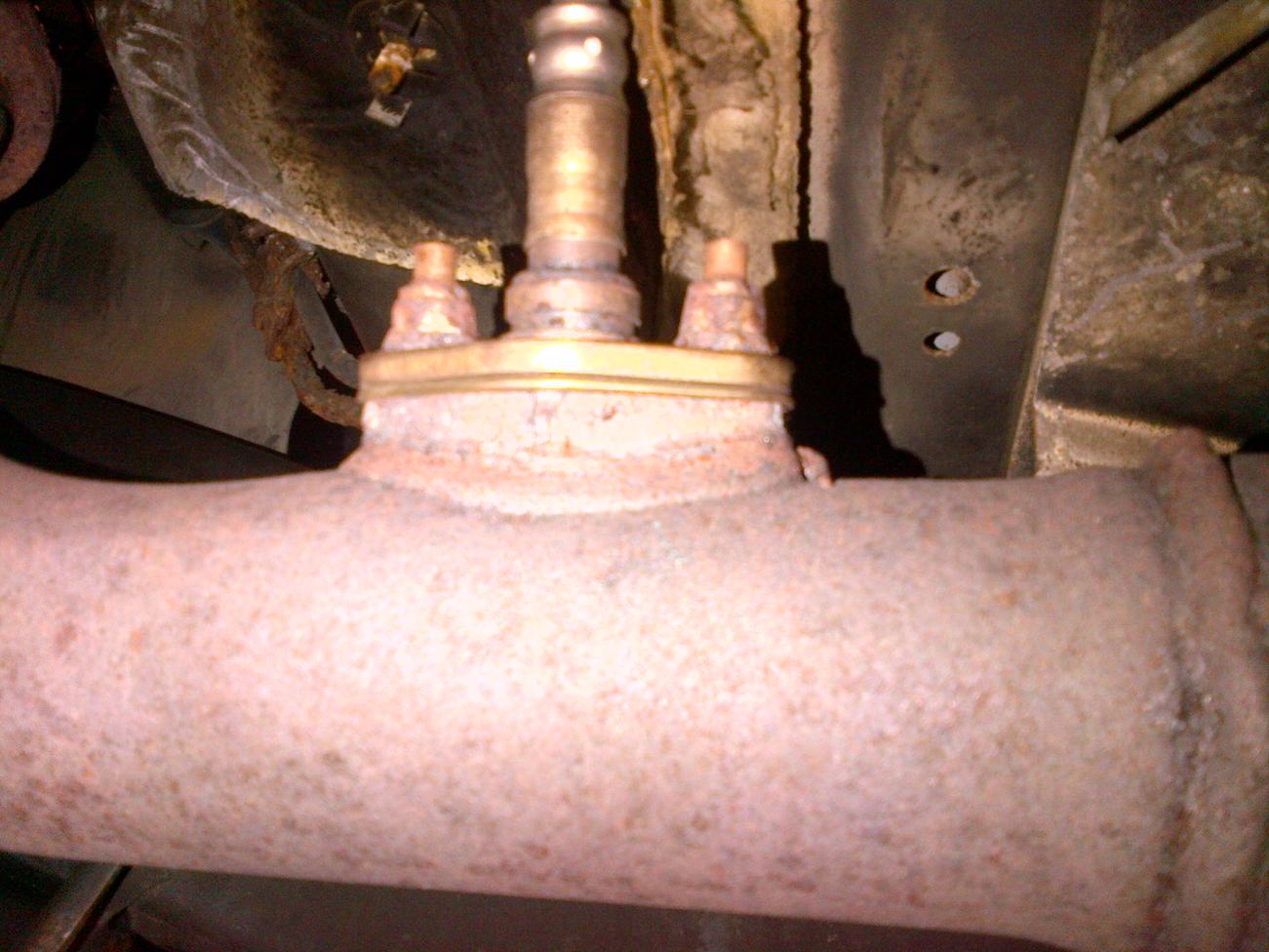

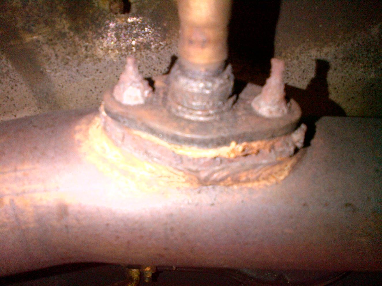

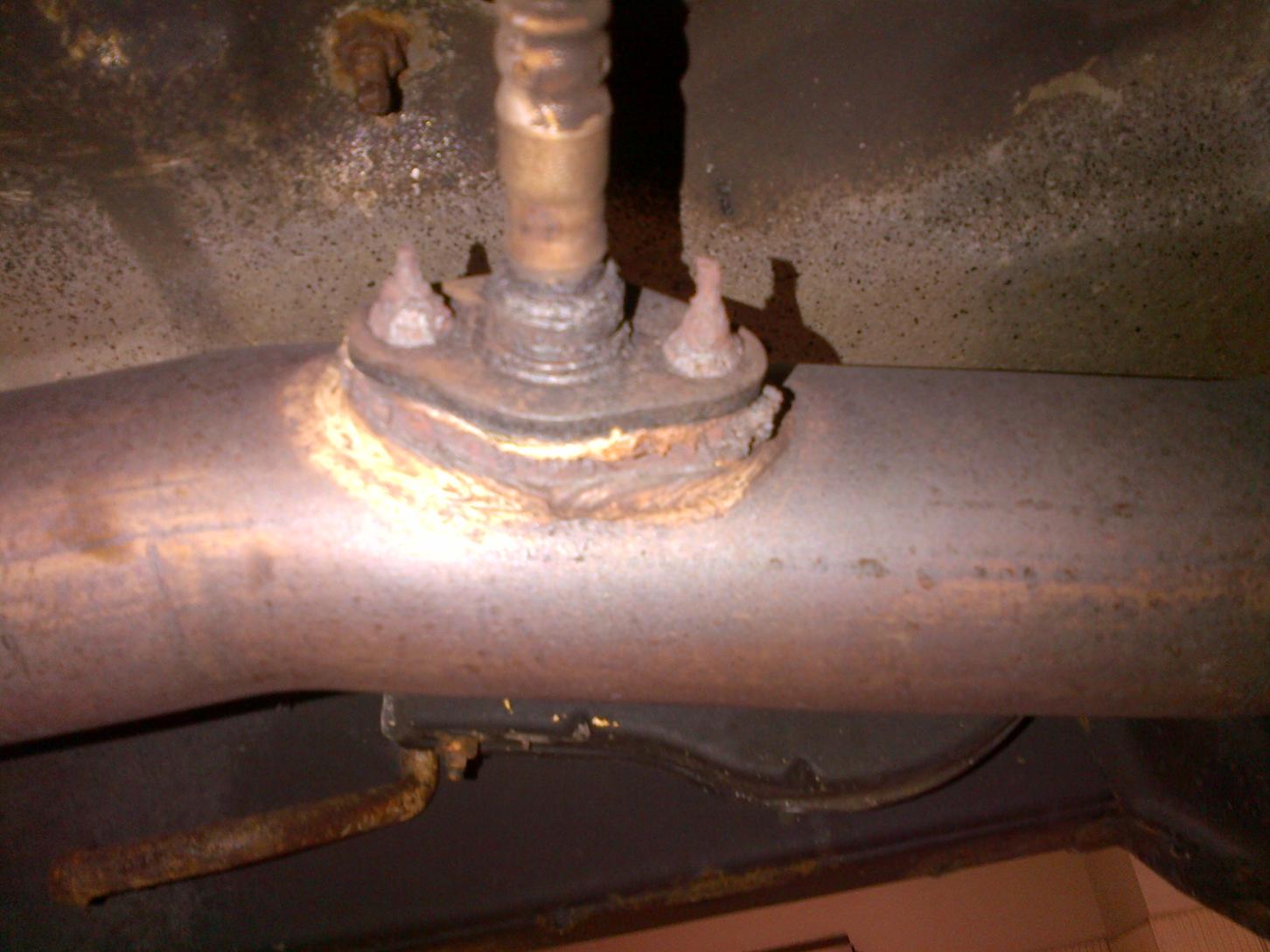

Hey Gang,
Ok goes like this... I have a rusted to crap 02 sensor that i cant break free.- See Below... I have had a few people look at it including a indie shop and the dealer. I have been told that my only hope is to go to a muffler shop and have them cut out the offending pipe from the CAT back and before the TRD muffler(sensor 2) somehow Get the old sensor off the old pipe and weld the section back with a new sensor.
Has anyone ever done this before? I dont know if they sell sections of pipe with the mounting for a sensor already on it.
The forward sensor was a breeze.. i was able to remove it clean up the threads and the mounting and re install it using new nuts/gasket from the dealer and anti seize compound. she's good to go.
Any advice is welcome.
Thanks.

Mine looked the same as yours!Take a wire brush to them and try to get a hold of a welder.Weld some larger nuts over the existing ones.This way you'll have some surface to wrench on and the extreme heat will make it easier to break them loose.

You guys are way over complicating it. Mine were worse than that. Get a torch and get them glowing red, then break them loose with vice grips. It's ruin the nut but after about 5/6 turns they'll spin off by hand. (just let them cool first, they'll be real hot). Buy new nuts and replace your O2 sensor.
It should, I've never seen that method fail. Just have to get them glowing hot.

Mine looked worse than that and came off with a little work. The studs are MUCH harder than the nuts, so the approach is to break the nuts into pieces. Use progressively smaller (cheap) sockets banged on with a hammer and alternate cranking down with Vise-Grips. On some nuts, you can only get the small Vise-Grips on there. I was ready to use a torch as PBR suggests, but I didn't need to. With enough pressure, the nuts start to break up. Just keep at it.

You are assuming he has an original Toyota bung/flange, which it does not appear to be. The front sensor, although rusty clearly has good studs and he was able to remove the rusted nuts without too much hassle. The rear sensor flange was obviously replaced at some point in time with an aftermarket unit and is corroding badly. My truck is EXACTLY the same way. I think muffler shops just cut the good flanges off at the first sign of rust and use their own inferior quality junk to replace it with. I'm sure they assume that the owner will have sold the vehicle on by the time it rusts out again. And if not it's more $$$ in their pocket when the new one rusts out.
Anyway, torching the nuts appears to be your only shot as the studs look pretty far gone. Otherwise it's time for a new bung.

You're right. Looking at it more closely, I had less nut but more stud, which is a much better situation than the OP's.
I had the exact same issue with my T4R after living in upstate New York. I used something called "aerokroil" and it makes PB Blaster look like glue. This stuff really penetrates deep. After some aerokroil, a little heat from a butane torch, I took a pair of vice grips and tightened down on the rusted nut. In just a few turns, that rusted out nut came off. One came off in pieces but it did come off. I replaced the nuts with new ones from the dealer. Good luck! (I had the same hopeless feeling you probably have/had but they did come off without having to cut or weld anything!!!!!
