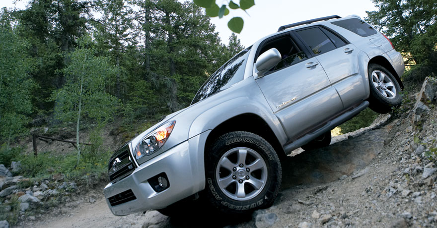

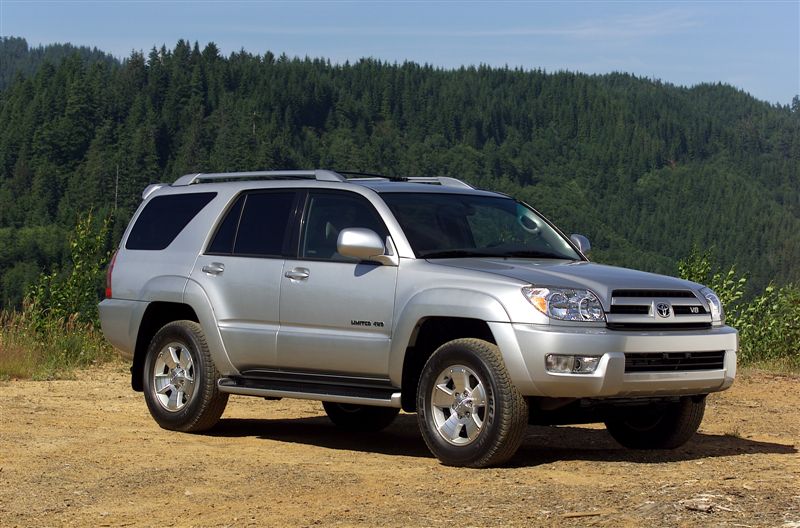

heres pics of 03 front fender flares compared to 07. see the difference on shape at top, (flat vs rounded) & also where they meet the bumpers, theres a bit of a curve down on the 07 bumper at the tip. im not sure the rear bumper can be switched over but if it can , the flares may need changing too. door side panels are different also, even with non OEM body & light parts, then paint, at a guess id say around 2k+ to do if you have it. the cost alone would be enough to turn most off, that may be why you cant find any write ups.

you will need to change the flares for the bumpers to match. I am upgrading all the cladding on my 03 to that of the 06-09...all flares and door cladding...i am scouring ebay for the parts and only need a couple more pieces...it is an exspensive upgrade since none of the 06-09 parts are made aftermarket except for the bumper covers...but good news it so far it all snaps in with no mods to the fenders...you just need all the plastic pieces from front to rear....including the rocker panel covers
