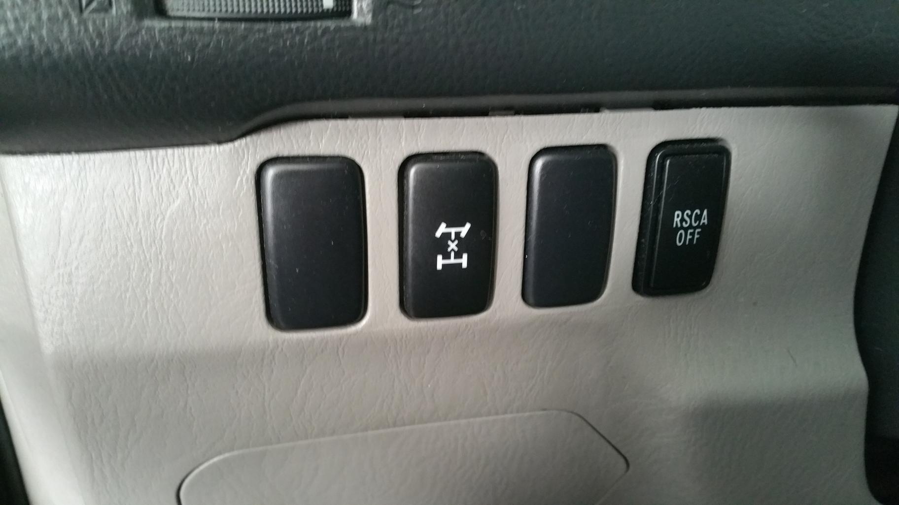

Plus you'll physically be able to see to the left of the steering wheel(Where the Center Diff lock button is), you'll have the "RSCA OFF" button.
I'll see if I can go and take a quick picture.

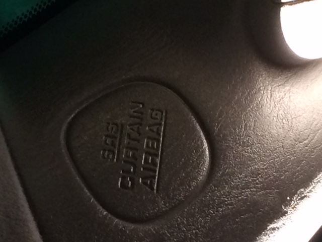

Side curtain airbags standard or an option in 04? How do I know if I have them? Is there a fuse to disable them?
You will also know if you see the image below above your forward O'shit handles. Not on the roof, but on the pillars coming up from the dashboard.
I hvae them, or at least the A & B pillars say they are in there but dont have the button to turn them off... 03 limited.
I would really like to have the switch as I do rally events and do have a slightly higher possibility of setting them off inadvertently.
