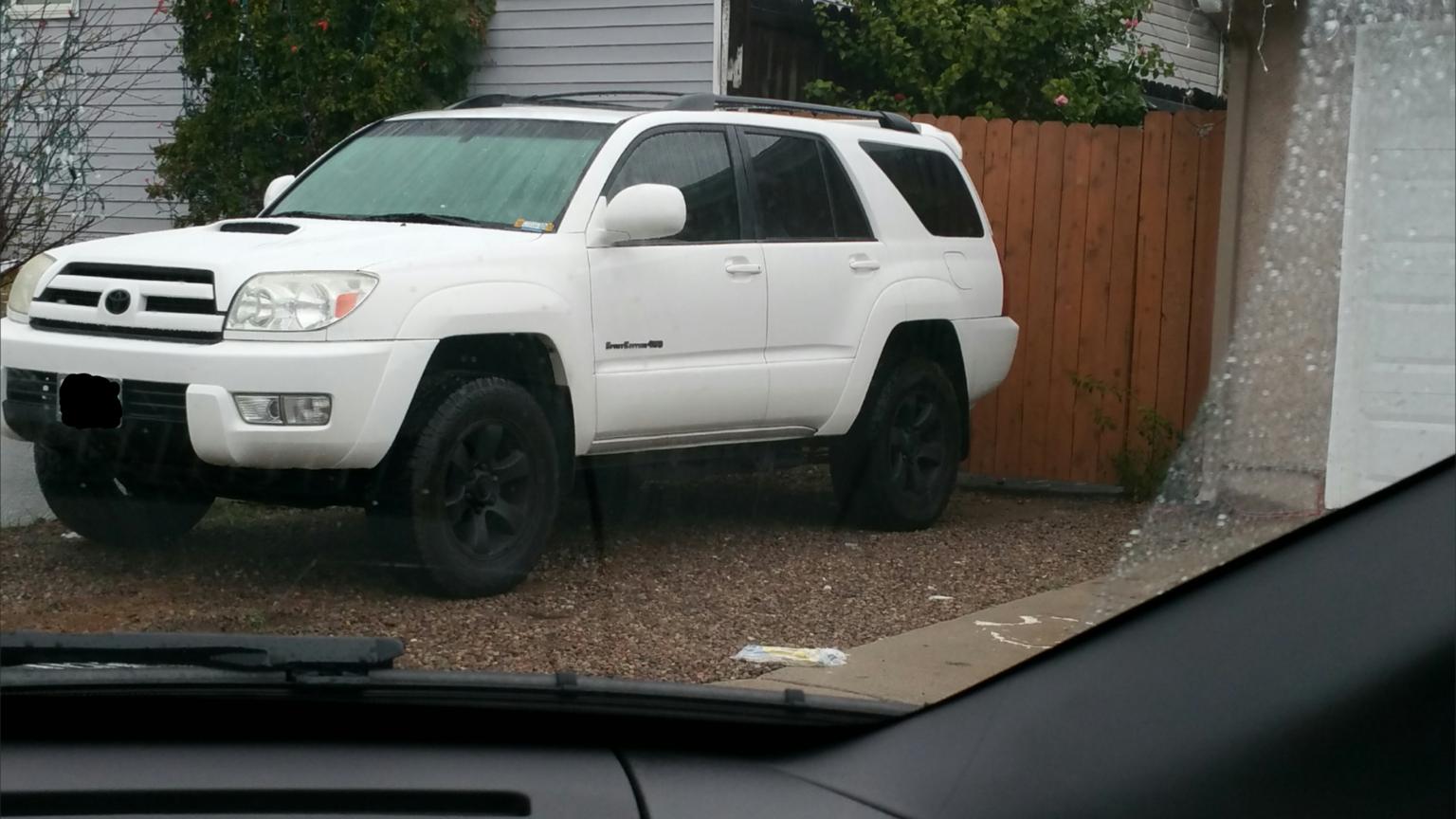

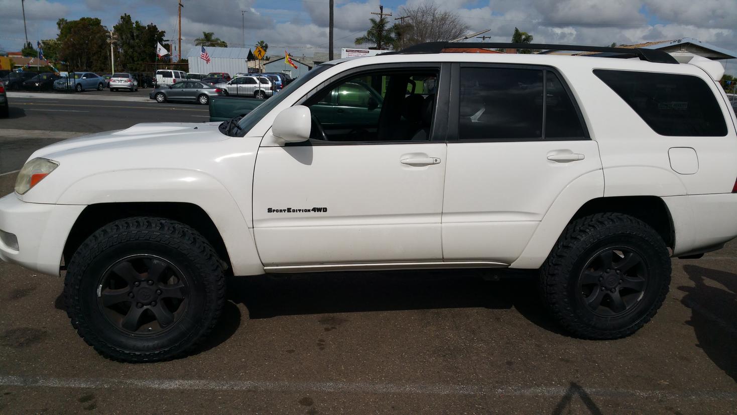

Bought it with 5100 front and rear.with stock springs.front set to 1.75.. Also had g2axle 1.25" wheel spacers and some 265/65 dynapro atm.
Did a little more plastidip work.

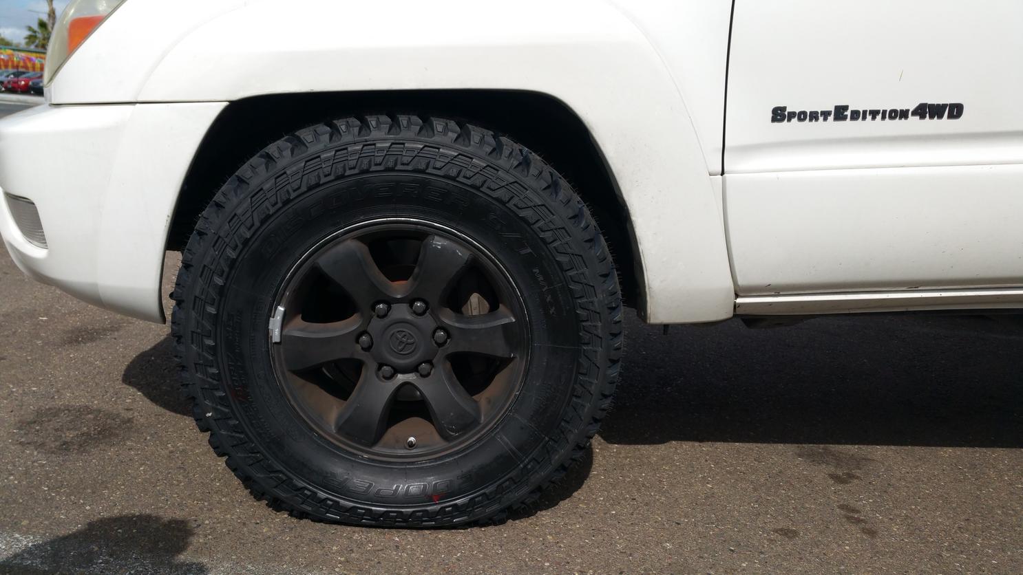

Got some new shoes
255/80/17 cooper st maxx
Removed the mudflaps all around and Put a fork lift under it till front was at full bump. Has very little rub while fully stuffed in the front while turning full lock to lock. Will need about 1/4 " of trim at the bottom corners to clear.
Once i can get out and offroad some i may swap in the 2010 fj coils i have for a stiffer spring rate temporaryily until i can afford to do the full 2.5 suspension and armor.
I may just do armor first so i can have the spare on the back. Have not trued to fit it underneath yet. I have seen anpost where a guy fit one and had to remove the centering bracket

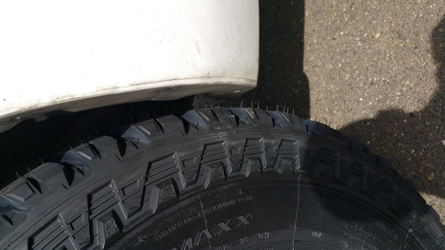

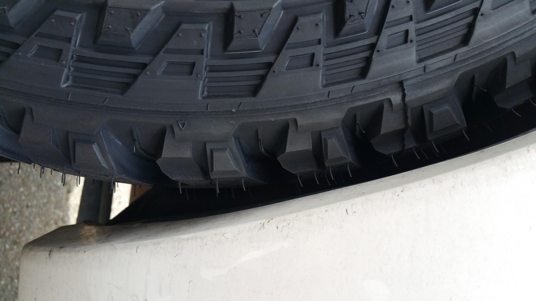

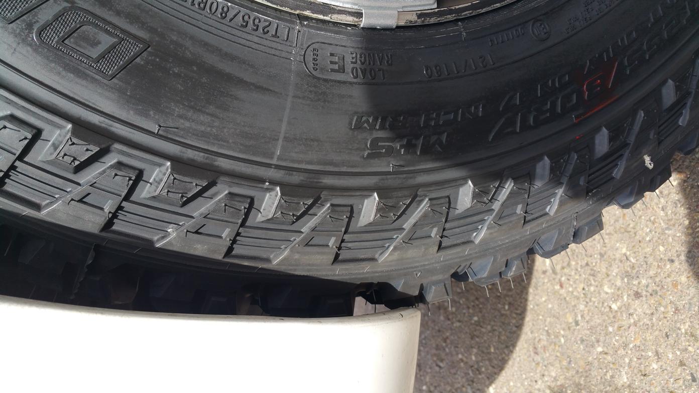

You can see the close points on the front... The rear clears without any needed trimming... Will trim front and offroad a bit and see what happens. Front wheelliners were moved forward prior to new tires
