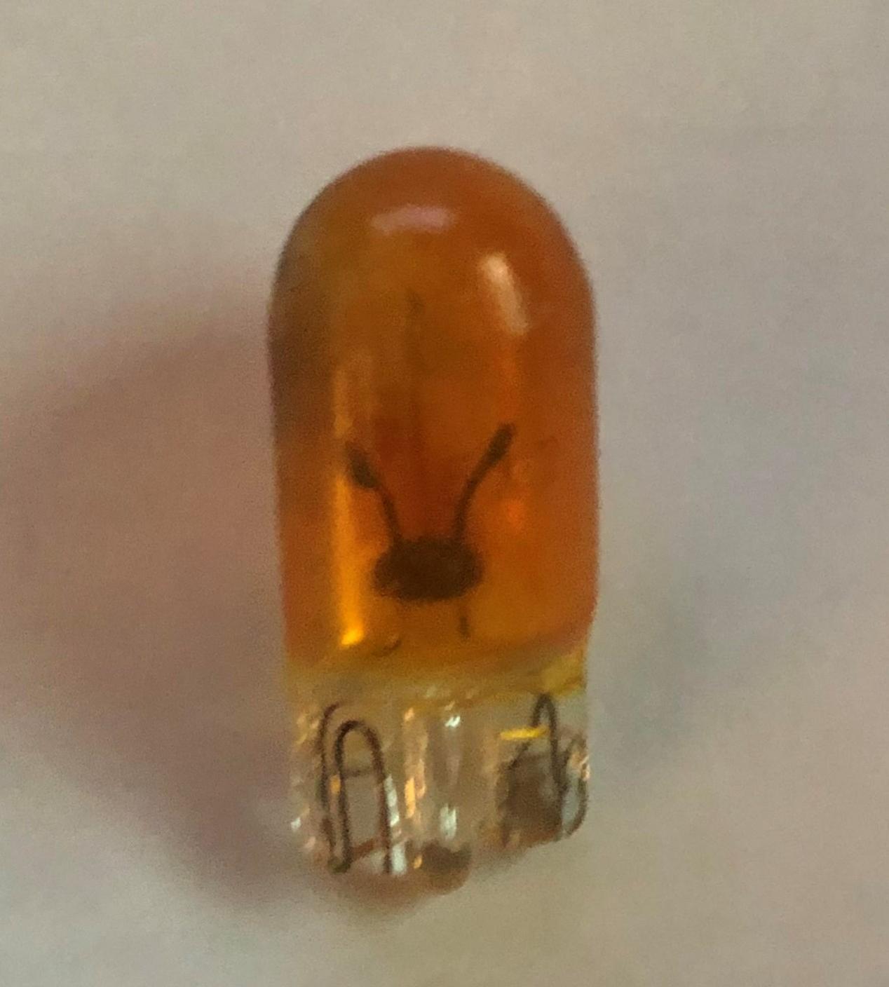

So I got and installed the DTMoto black housing headlights with the Auxbeam H11 lows and Vehicode 1156 DRL's, and I am thoroughly impressed to say the least! Still have a little aiming to do which is almost as aggravating as the install itself LOL. One question though...what is the tiny amber bulb that seems to also be a DRL and is located below the 1156, facing forward? Apparently 1 of mine was blown and I never even realized they existed, but can't seem to find the size anywhere online.
Its a parking light. Bulb size is 168. If one is burned out I recommend changing them both to LEDs. They can be found for cheap on amazon or ebay!
Yup, they actually just got delivered today. Total PITA to get my hands in there to replace with the headlights installed though LOL.
