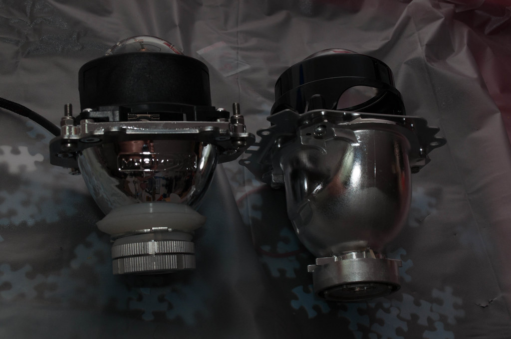

sorry dont mean to clutter the OPs thread with off topic but There are minor differences between HID projectors and halogen projectors. It has to do with the position of the bulbs focal point inside the projector. HID bulbs being longer means the point is not on the same spot with a halogen bulb vs the HID bulbs. So just by having the focal point in a different spot can vary the light output. as far as "has anyone taken apart an 06 headlight & compared the projector to an HID one" what do you think is involved in a retrofit? may be of some use- https://www.toyota-4runner.org/4th-...-06-headlamps.html?highlight=diy+hid+retrofit
Thanks, this picture is what I was asking about. '06 reflector is much shorter. However, it looks very similar if not identical to bosch ALs that ruled the Earth for generations and have being copied endlessly by others. So I think sticking a proper xenon bulb into stock '06, while not perfect, isn't such a bad option, as some present.
