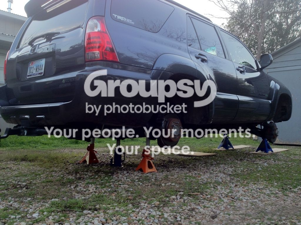

All Pro spacers have been installed. Wow, what an improvement...this is how these 4Runners should look right out of the factory. Reminds me a little of my '98 :(
I installed them, drove 50 miles, and then re-torqued everything. I'm guessing the initial install went flawlessly because after 50 miles none of the lugs were loose (on the spacer OR the wheels). Anyways, everything is all buttoned up and I'm planning on checking them again after 200 miles just for the hell of it. Great excuse to drink beer and wrench.
Sidenote: I purchased thread locker but I don't plan on using it. As an engineer by trade, it just doesn't make sense to me to use it. What especially confuses me is the spidertrax recommendation of applying thread locker then checking torque after some time. Not only are there differences in static/kinematic methods of checking torque but the whole idea seems counter-intuitive. Checking the torque of a fastener held in place with high strength thread locker? Not wrapping my head around that one...
Also, I'd like to be able to easily remove them should I decide to get wheels with different backspacing someday. Somebody please correct me if I am completely wrong :)

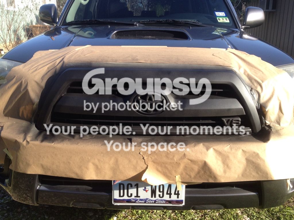

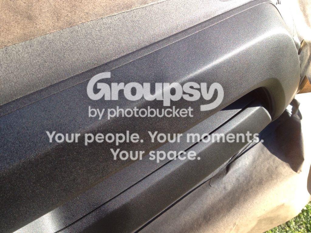

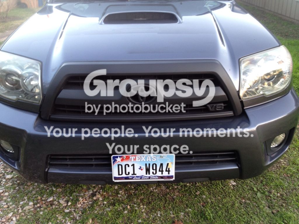

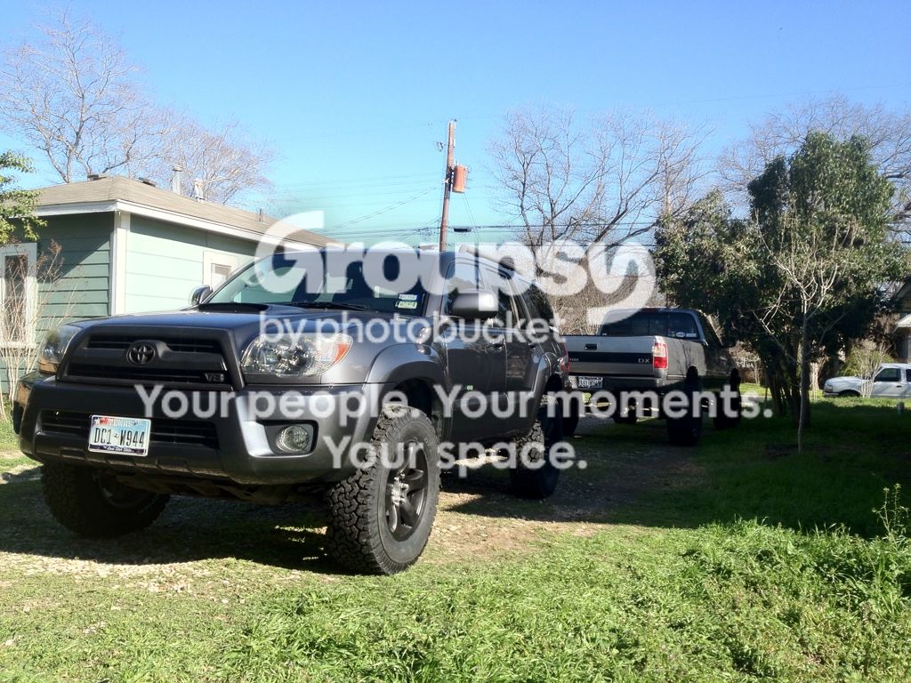

Gotta love Plasti Dip
fd8e9afc.jpg~original
55c12f00.jpg~original
cf6809c4.jpg~original
4235beb0.jpg~original

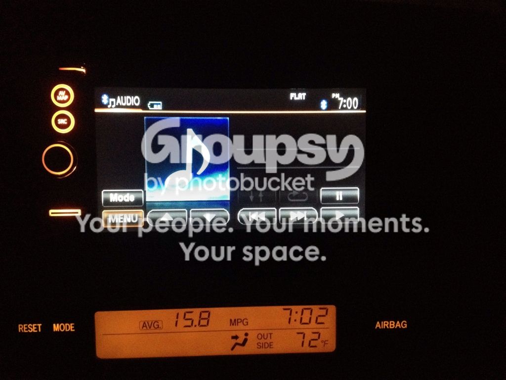

JVC KW-NT30HD installed:

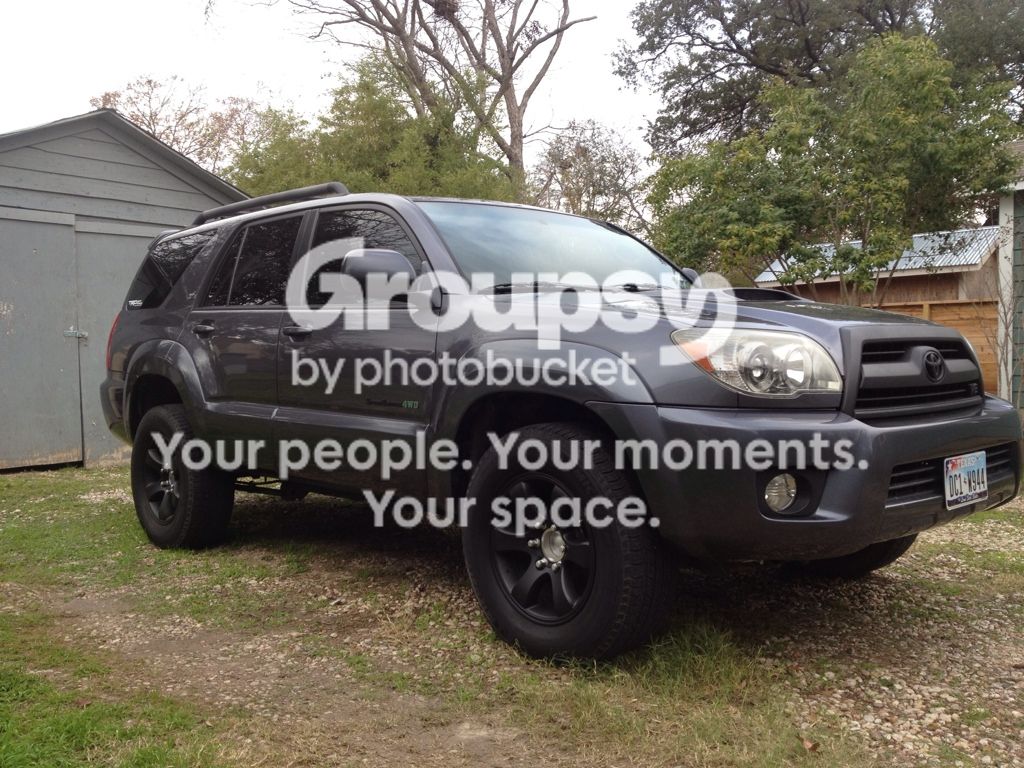

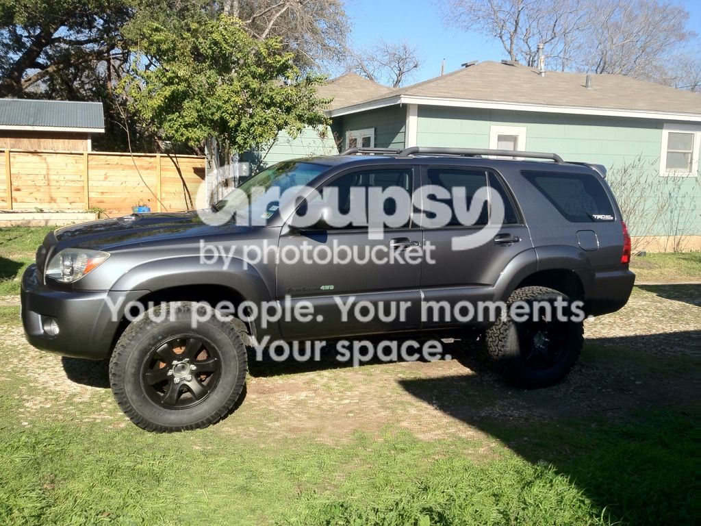

Also decided to Plasti-Dip the wheels:
e2663727.jpg~original
1d107991.jpg~original
19b7484f.jpg~original

Is the HU a factory Nav? Can you post some straight on pics of the HU with it turned on please?
HU appears to be a JVC per his post about it.
Nice looking truck! I think i might try plasti-dipping the front grill like you did. I just ordered a yakima load warrior with extension that needs some tlc. How hard would it be to plasti-dip the whole rack? I was originally thinking of hitting it with bedliner and if I do that I'll probably do the grill at the same time, also with bedliner or plasti-dip, whichever i decide to go with but the plasti looks great!

Looks pretty good for not unbolting the grill!

Thanks man. It took about 3 minutes to tape everything off and obviously way less to remove it.....seemed just as easy as unbolting it (the overspray just wipes off being that it's Plasti-dip)
Thanks. The unit is the JVC KW-NT30HD.

Thanks! I would probably use bed-liner on the roof rack, I imagine cargo sitting on a Plasti-dipped roof rack would tear the PD up pretty good.
Definitely go with PD on the grill, you can just peel it off should you decide to sell the vehicle to somebody who isn't thrilled about a murdered-out grill, lol.

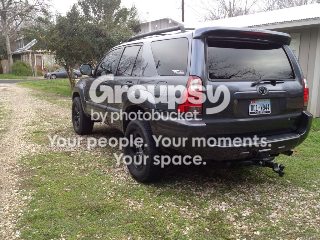

Installed the Gibson exhaust today. It took about 3.5 hours to install however, some of the time was spent waiting for my dremel and saws-all batteries to charge. I'm pleased with the results so far in terms of fit and sound.

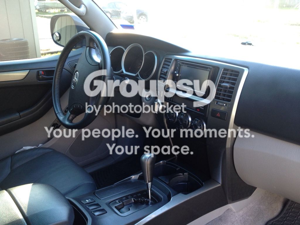

Somebody wanted a picture of the HU so here's a quick one at night. You can adjust the unit's buttons to match your vehicle...looks close enough.
