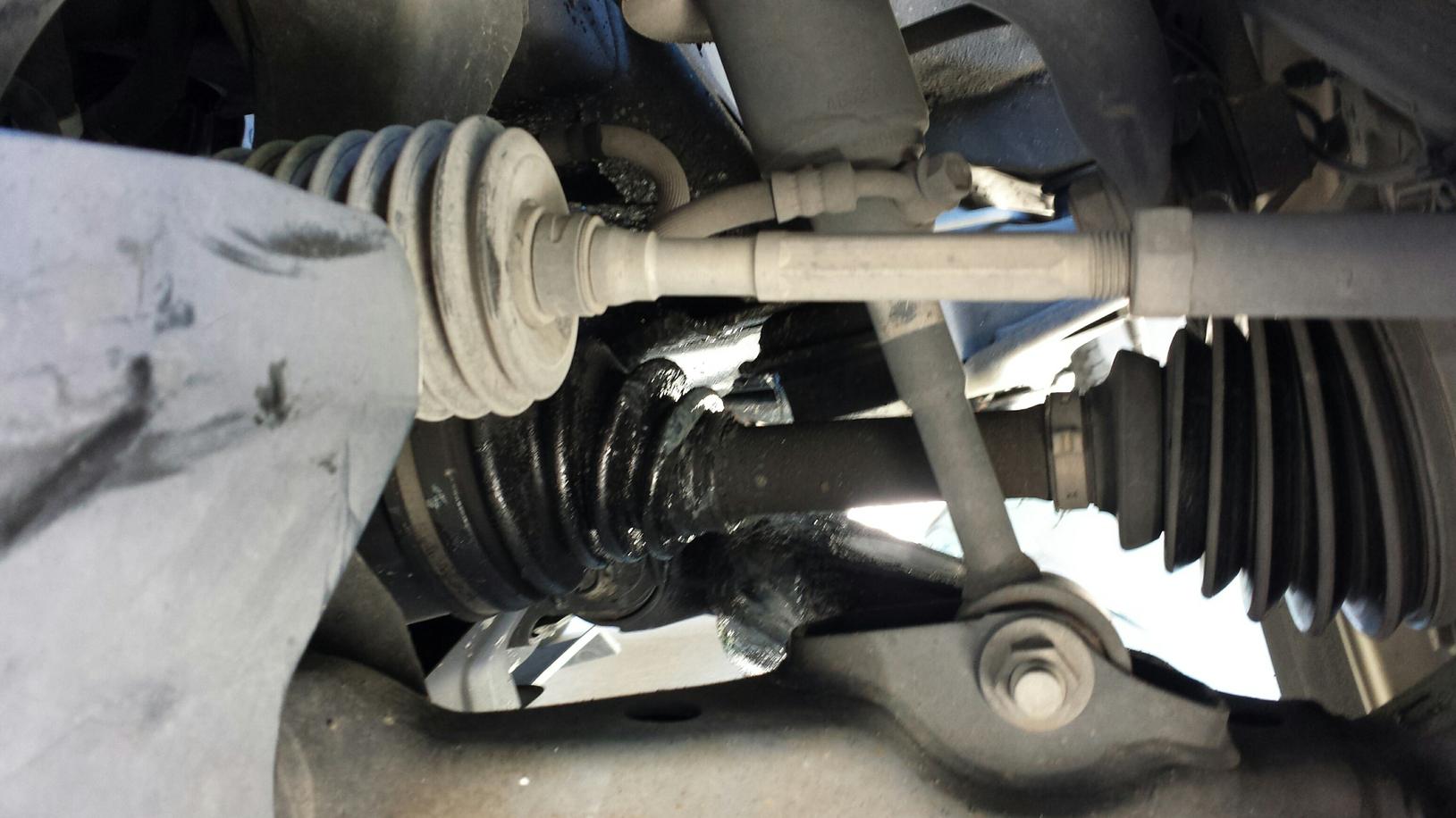

Front-Driver side boot clamp missing
While I was doing an oil change, I noticed the following clamp missing from the CV boot:
Looks like some grease came out, would I still be ok with just using a hose clamp, or do I need to regrease it prior.
Thanks

Due to the unknown of how much grease came out and how much water/debris got in I would highly recommend replacing the grease first. I bought my runner with leaky boots so I elected to pull the boots all the way back, watch the nasty watery slop come out, brake clean the hell out of the balls, then inject fresh grease into each roller with a zerk fitting tipped needle (from amazon ~$3), taking it one step further than the write up attached. I used the mcmaster carr clamps and they fit very nicely.
