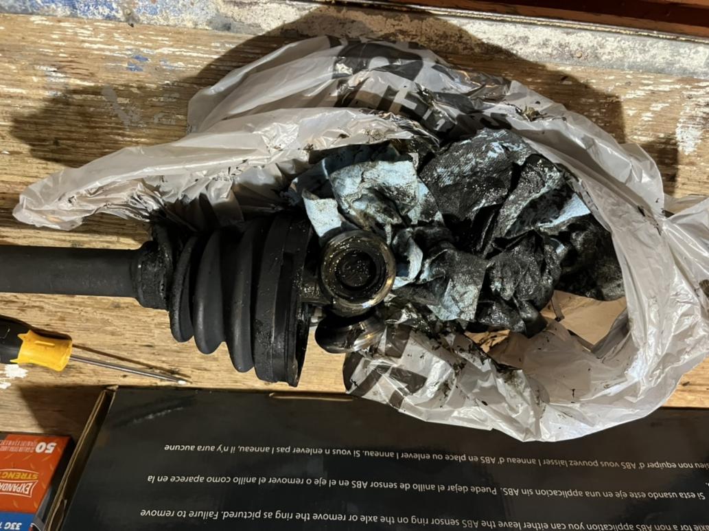

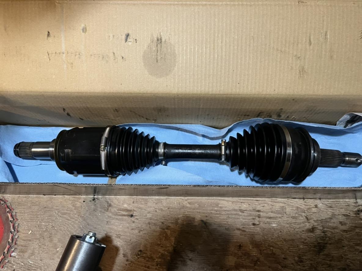

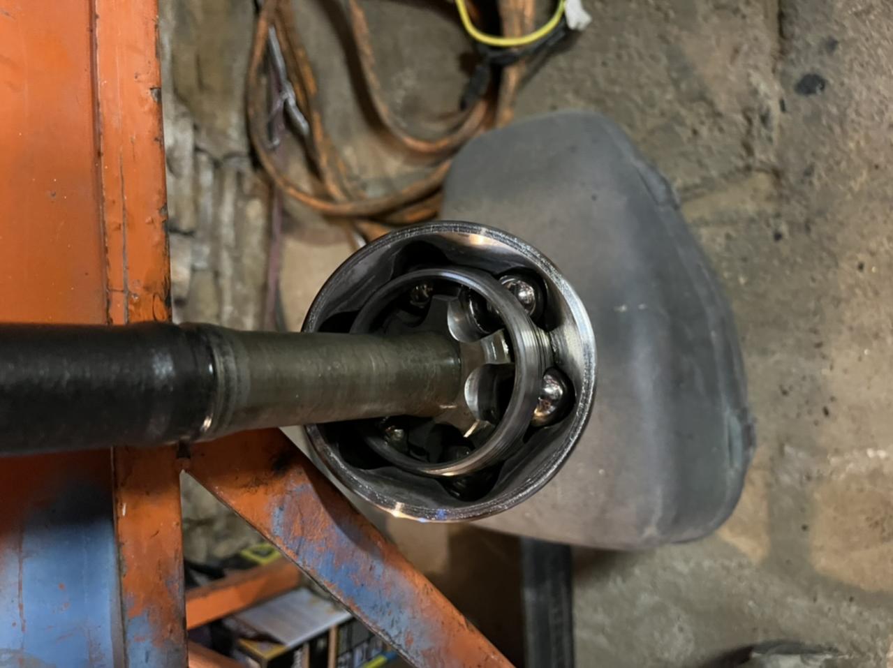

I have a 5th Gen (2022) 4Runner TRD PRO, lifted and on 33's.
I was leaving for Baja Monday morning January 29th, and since the weather was cold that week, I waited until Saturday Jan 27th to rotate the tires.
Just as I was about to finish, on front driver's side, when I pulled the tire I saw the torn inner boot.
I was able to find a CV Axle and replace it on time to be able and leave Monday, but, in the process, I damaged the yoke seal, which I couldn't find anywhere, couldn't even get the part nber fir it anywhere so I went with it as is.
At my return from the trip, I had to leave for Europe within a week for another 3 weeks, and ordered the CV Axle kit($210CAD) as well as the yoke seal, which was a special order.
They just arrived earlier this week, and I've completed replacing the inner boot.
