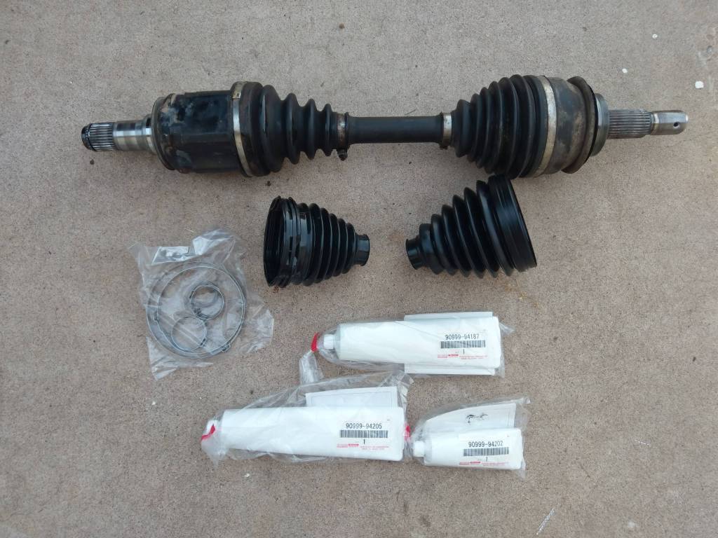

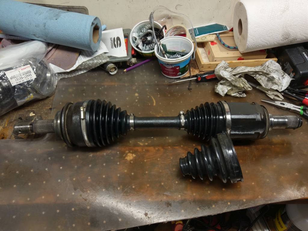

Got this done over the weekend. Was not as bad as most make it out to be. Took me 3 hours for the first side, and 2 hours for the second, beginning to end including removing and installing the CV axle. About 1 hour for the reboot part. I think the most frustrating part was removing the dust cap! To get the CV out I used a large screw driver and a 4lb hammer. With the screw driver in on of the groves it took only a couple of hits with the hammer to get the CV out. Requires removing the skid plate, but well worth it.

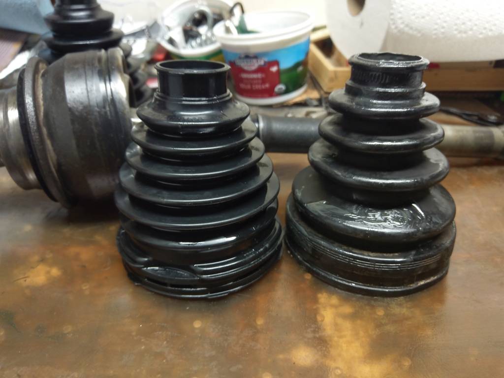

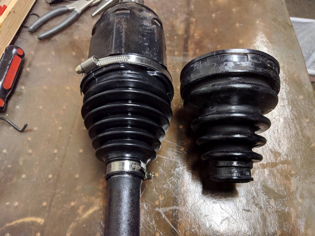

The 5th gen boot kit (04427-60131) is a perfect fit. The inner boot is the same material as the outer boot and has more fins compared to the 4th gen boot. Hopefully it will be more durable. The grease capacity is a bit larger, that's why there is an additional small tube of grease. Given that both kits are the same cost this seems like a nice free upgrade. I did get the worm drive clamps from Amazon (or eBay) since they are easier to install and allow for adjusting the inner boot on the truck (boot stretch). Snap ring pliers are definitely a good recommendation, make removing and installing the snap ring really easy.
Dude, those look fantastic! I really appreciate the pics too, those are a great addition. I've already linked it on the first page and made the recommendation to go the 5th gen kit!

I was wondering, since the 5th gen boot has more fins wouldn't that make them rub against each other more that the 4th gen? I have a torn boot because of the rub. I already ordered the 5th gen boots though lol.

Hopefully [MENTION=145671]BagiMT[/MENTION] will chime it, but I think the main benefit is the 5th gen inner boot is the plastic material like the outer. So when/if it does rub on itself, it doesn't chew through the more robust material. Also I think the more pointed shape of the 5th gen boot fins helps them to compress better than the thick and rounded off ribs on the 4th gen. This is just speculation though, since I haven't run the 5th gen kit myself. I have a spare CV I want to reboot with the 5th gen kit, so definitely let us know how it goes!
Yes, the 5th gen inner boot is more like the outer boot. Same material, thinner finn's than the 4th gen boot. I stretched mine a bit and have not noticed any rubbing (3" lift). Might be interesting to look in the 5th gen section to see if people still have torn boots. I just assumed Toyota changed the design for a reason and went with it. Time will tell how it holds up, so far so good.

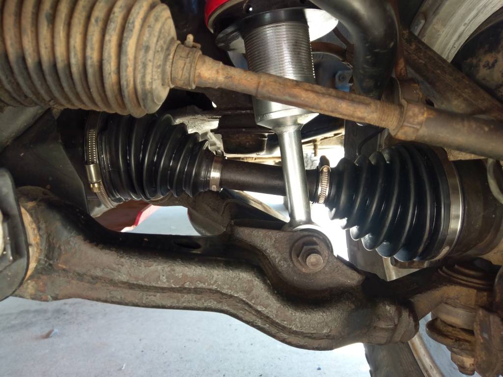

So I finally did it. Just on the passenger side. Now I want to do the driver side to be even lol. But its fine for now. The whole process took me some time since I was taking breaks and going slow. Im sure the next time will be much faster.
I had to do the knuckle seal too because for some reason it was torn and the little circle spring came out with the axle.
5th gen boots.
